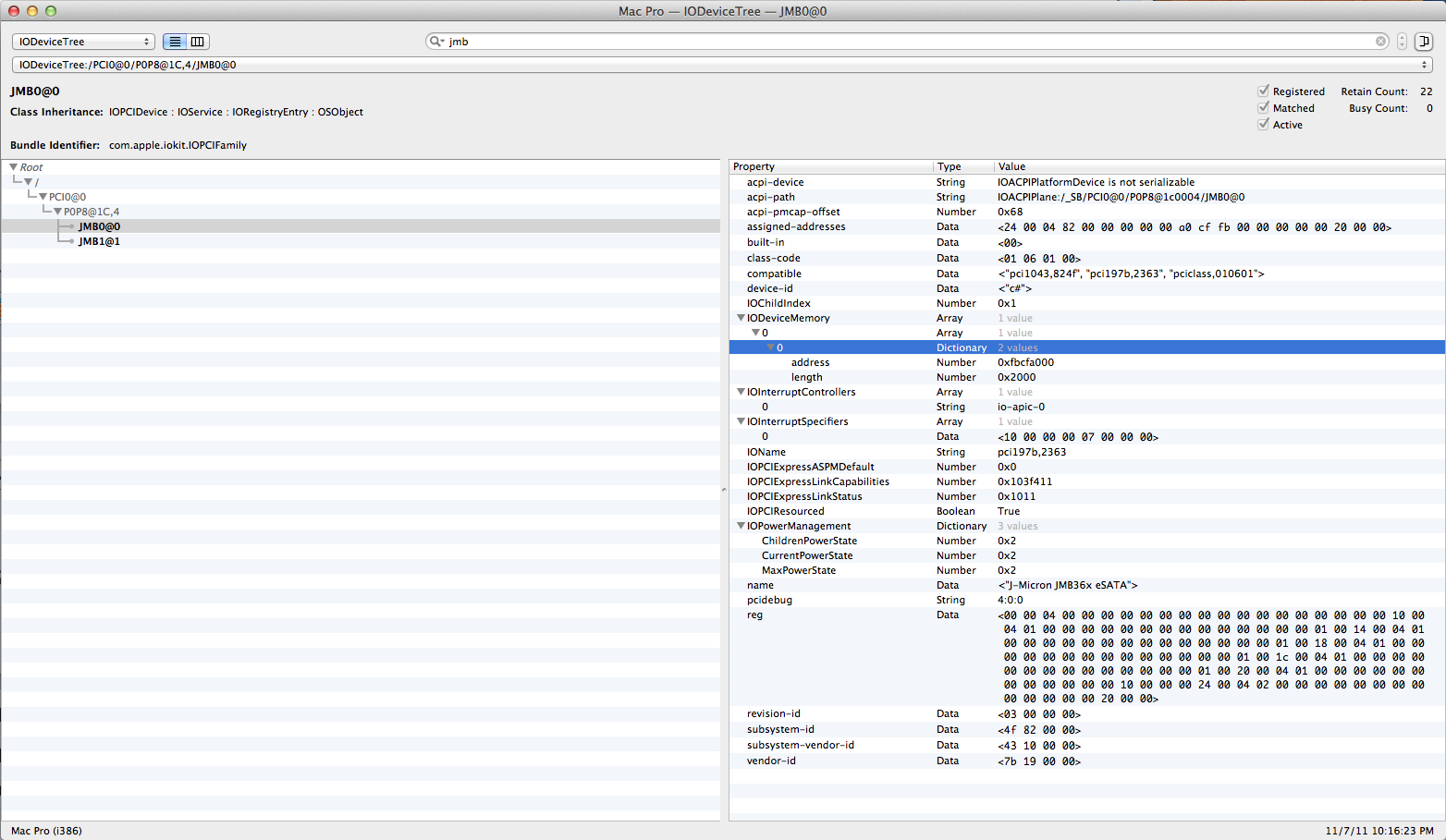

sunlit Posted November 7, 2011 Author Share Posted November 7, 2011 For some reason the forum won't allow me to upload my ioregistry explorer's dump, so here is a screenshot. Link to comment https://www.insanelymac.com/forum/topic/271736-jmicron-jmb36x-controller-not-working-after-1072-update/#findComment-1768483 Share on other sites More sharing options...
