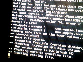

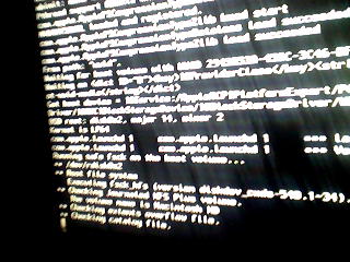

Knacker Posted October 24, 2011 Author Share Posted October 24, 2011 It just hangs here forever, with no disk activity I've now also tried resetting my motherboard's bios via the jumper. No change. This is frustrating... My job depends on using this computer! Link to comment https://www.insanelymac.com/forum/topic/270911-unbootable-system-seems-to-become-that-way-on-sleep/#findComment-1763935 Share on other sites More sharing options...
Knacker Posted October 24, 2011 Author Share Posted October 24, 2011 *sigh* I found the problem. Apparently, for some reason, it doesn't like LegacyAppleYukon2.kext. With the potential to help other people with weird boot problems like this, here is what I did: I created a live USB drive with a very basic lion install on it. Then, using the kextload command line utility, I went into my hard drive and loaded my custom kexts one by one... Every time I tried to load that particular one, the system froze up hard. The mouse didn't move. That was what was happening at boot, it was enough to stop it dead in its tracks in the middle of a fsck operation, only because there's no mouse or interactivity during a boot I had no idea that's what was happening. Now to find some way to get my network card working. At least I have flash drives. Link to comment https://www.insanelymac.com/forum/topic/270911-unbootable-system-seems-to-become-that-way-on-sleep/#findComment-1763990 Share on other sites More sharing options...
