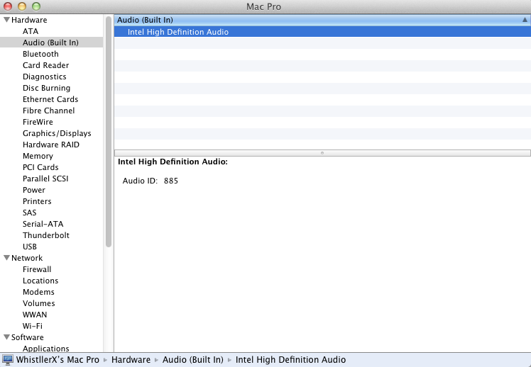

Kynyo Posted September 9, 2011 Share Posted September 9, 2011 Hello everyone! Actually I'm trying to install OS X Lion on my mobo Gigabyte EP45T-DS3R. I've installed successfully, all drivers ready, but I don't have sound. I've tried all methods Like AppleHDA, ALC88xx, HDA Rollback but again, no sound. I think I've need a proper HDEF DSDT, actually I'm n00b at DSDT editing, so if someone can help me effort will be greatly appreciated. My System: Motherboard: Gigabyte EP45T-DS3R CPU: Core2Duo E8400 GPU: nVIDIA Quadro FX 3700 RAM: 4GB KINGSTON @ 1066 Mhz BIOS: F4c System report says: Thanks in advance Link to comment https://www.insanelymac.com/forum/topic/267630-help-gigabyte-ep45t-ds3r-lion-107-no-sound/ Share on other sites More sharing options...
MaLd0n Posted September 9, 2011 Share Posted September 9, 2011 ALC889a.zip Method (_DSM, 4, NotSerialized) { Store (Package (0x06) { "built-in", Buffer (One) { 0x00 }, "layout-id", Buffer (0x04) { 0x75, 0x03, 0x00, 0x00 }, "PinConfigurations", Buffer (Zero) {} }, Local0) DTGP (Arg0, Arg1, Arg2, Arg3, RefOf (Local0)) Return (Local0) } Link to comment https://www.insanelymac.com/forum/topic/267630-help-gigabyte-ep45t-ds3r-lion-107-no-sound/#findComment-1746524 Share on other sites More sharing options...
Kynyo Posted September 10, 2011 Author Share Posted September 10, 2011 ALC889a.zip Method (_DSM, 4, NotSerialized) { Store (Package (0x06) { "built-in", Buffer (One) { 0x00 }, "layout-id", Buffer (0x04) { 0x75, 0x03, 0x00, 0x00 }, "PinConfigurations", Buffer (Zero) {} }, Local0) DTGP (Arg0, Arg1, Arg2, Arg3, RefOf (Local0)) Return (Local0) } Thanks Man Actually is needed to edit my Gigabyte HDEF generated using your tool [DSDT Auto-Patcher]. What was wrong with this great project? You stopped working on it? I think I'll edit using DSDT Patcher & Editor Tool or DSDTSE Thanks once again MaLd0n, thanks Insanelymac! In case I'll not succeed with editing DSDT I'll post here for help PS: I'm new in DSDT editing and I please you to help me make those modifications and check if my DSDT it's oke. I guess kexts must be installed in S/L/E with repairing permissions Problem Solved using Legacy HDA Method!!! Thanks insanelyMac, Thanks MaLd0n! Now my system reports: DSDT.aml.zip Link to comment https://www.insanelymac.com/forum/topic/267630-help-gigabyte-ep45t-ds3r-lion-107-no-sound/#findComment-1746744 Share on other sites More sharing options...
