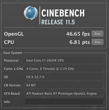

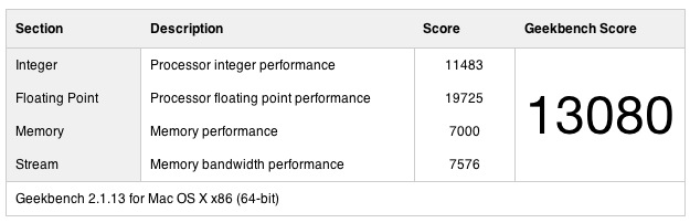

pentiumpc Posted August 1, 2011 Share Posted August 1, 2011 Build Log: System Hardware CPU : Intel i7 2600K MB : GA GA-P67A-UD3-B3 rev 1.1 - F5 RAM : 16 GB DDR3 (2 x 2 Gskill RipjawX Twin kit) GFX : Saphire HD6870 1GB DDR5 OS : Lion 10.7 DSDT mod Standard Patch with DSDT patcher + HDA + Power management (from SSDT) patch. Non vanilla Kext E/E : FakeSMC with plugins, NullCPUPowerManagement, Sleepenabler. S/L/E : Patched AppleHDA.kext (for ALC889), PXHCD (USB3), Realtek Gigabit Ethernet 2.0 (from [url="http://www.insanelymac.com/forum/topic/279450-why-insanelymac-does-not-support-tonymacx86/"]#####[/url]) Running for a few days, everything works as it is. Not working / Errors. Screen tearing occurs in safari and some other software with Duckweed Framebuffer, Gibba works but slow OpenGL score in CinebenchX. Native Sleep and wake works but with CMOS reset (revert back to sleep enabler) Native Speedstep works but revert back to NullCPUPM to use Sleep enabler. Airport spam in console. Things to do. Edit DSDT to fix orange Drive Icons. (*edit, done. added device id to sata) Edit DSDT for GFX once I sort out the Framebuffer issue. Fix CMOS reset for native Power Management. (currently only patching the RTC will work) Get a Airport card to see if it stop the Console Message Spam. The above is my Build, comment and suggestions are welcome, any solutions to my problems will be greatly appreciated. I will also try to answer any question you have regarding my system. Thanks to all that make using Hackintosh a joy. Link to comment https://www.insanelymac.com/forum/topic/264289-ga-p67a-ud3-b3-rev-11-saphire-hd6870/ Share on other sites More sharing options...
