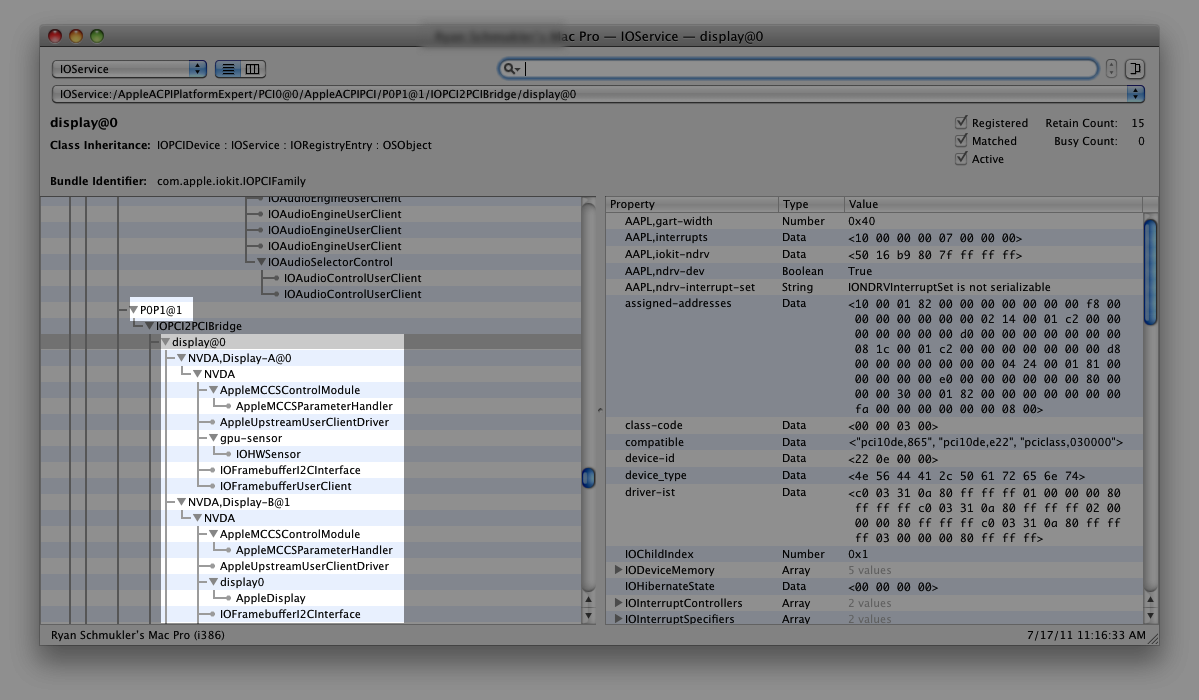

thewierdone2000 Posted July 23, 2011 Share Posted July 23, 2011 Hey guys, I have a GTX 460 which I am trying to get to work via DSDT instead of EFI injection (it works well via EFI but I want to keep as much of my hacks in DSDT over com.apple.boot.plist). Unfortunately, when using a modified DSDT.aml I am unable to get output from any of the various connectors (two DVI, one mini-HDMI). I followed the following guide: http://tonymacx86.blogspot.com/2010/01/adv...a-graphics.html gfxutil outputs the following: ./gfxutil -f display DevicePath = PciRoot(0x0)/Pci(0x1,0x0)/Pci(0x0,0x0) Leading me to use 0x00010000 for the address instead of the 0x00030000 used in the guide. Here is a link to my DSDT.aml file. Ultimately the reason I want to move this to DSDT is because I want to use dual GTX 460s, and the EFI string for that just seemed like it'd be overkill (yes, I have seen the guide and I know it is possible, but this is just cleaner) One thing I noticed is that in IORegistryExplorer my display shows up under POP1, however when putting my display under POP1 in my DSDT file I get kernel panics on boot. Interestingly enough POP1 has the same address that I am using for my graphics card. Any help would be very much appreciated, perhaps I am missing something! Link to comment https://www.insanelymac.com/forum/topic/263283-blank-screen-with-dsdt-enabled-video/ Share on other sites More sharing options...
