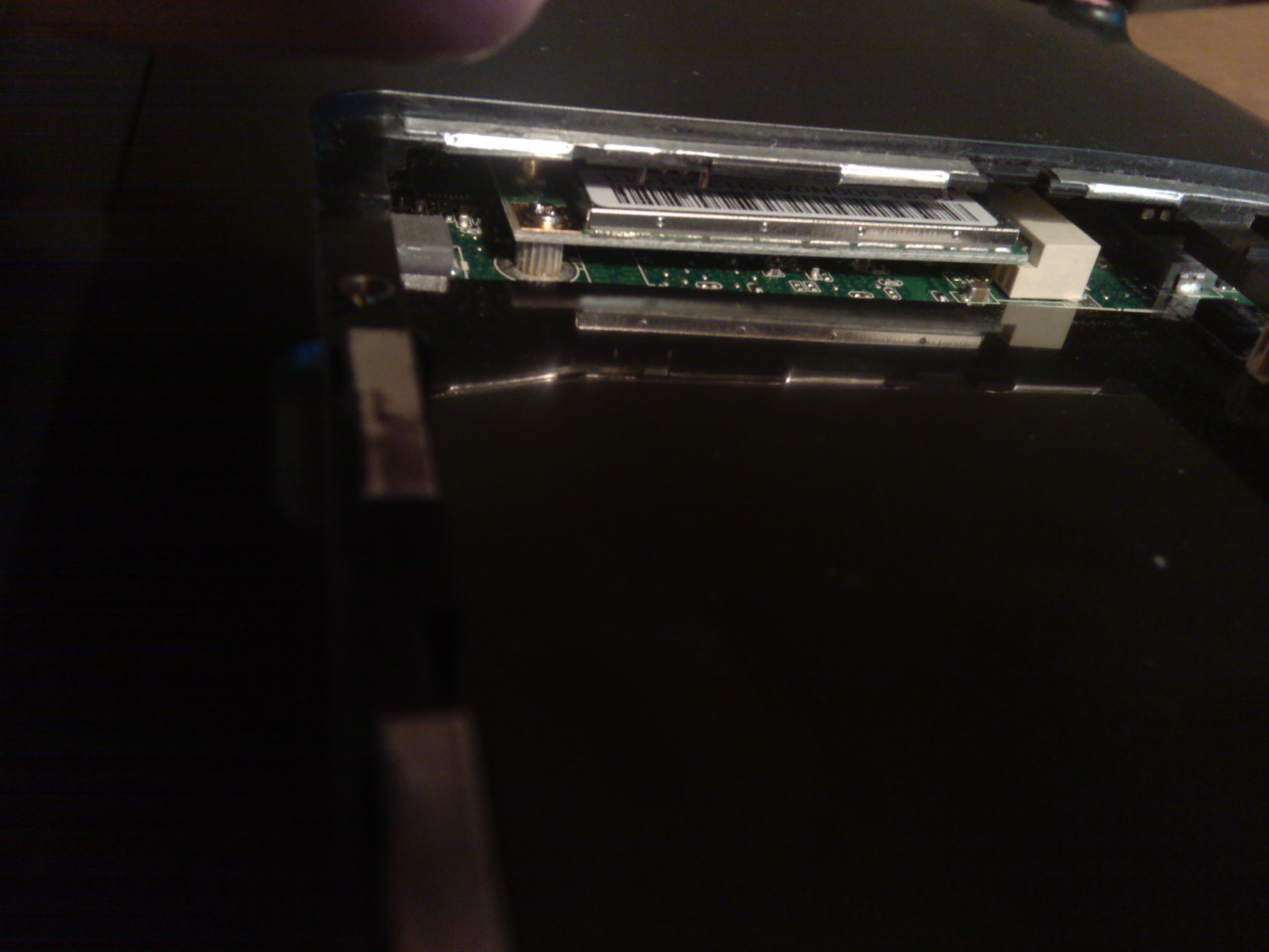

LatinMcG Posted July 14, 2011 Share Posted July 14, 2011 wow youre quick. so u opened it and changed it. and no its not blocked its a netbook.. and smbios.plist can cause wireless to be missing if no Mac-Fxxxxx in it. also in dsdt Device (PCI) has _ADR Zero might need _UID instead or added. make sure u check ram slots to be clean.. re insert ram after cleaning slot and ram gold contacts with pencil eraser. put tape on pin 20 so it stays on always. and controled by os only lets fix your dsdt so it thinks its subsystem 8F (apple) Method (_DSM, 4, NotSerialized) { Store (Package () { "AAPL,slot-name", Buffer () {"AirPort"}, "device_type", Buffer () {"AirPort"}, "subsystem-id", Buffer () {0x8F, 0x00, 0x00, 0x00}, "subsystem-vendor-id", Buffer () {0x6B, 0x10, 0x00, 0x00} }, Local0) DTGP (Arg0, Arg1, Arg2, Arg3, RefOf (Local0)) Return (Local0) } upload in a zip and show me in iorexexplorer where its located should say pci168c,2a what date does the card say..any special models # on it ? what smbios.plist are you using. .show me it. lets get dsdt and kexts loaded with dsdt auto-patcher thread tool (boot without dsdt somehow. .with hackboot in usb ? to get original dsdt .. and send me modded also if u using any) http://www.insanelymac.com/forum/index.php...t&p=1571259 "If you want to send me information about your system so I can make an auto-patcher for it, please download and run the attached "run_me" script and attach the "send_me.zip" file it creates on your desktop. The included data is your DSDT, a list of loaded kexts, an ioreg dump and the kernel log. If you want to see the commands it runs, just open the script with "Automator". run_me.zip ( 66.11K )" Link to comment https://www.insanelymac.com/forum/topic/262268-atheros-ar9820-no-airport-in-list/#findComment-1714793 Share on other sites More sharing options...

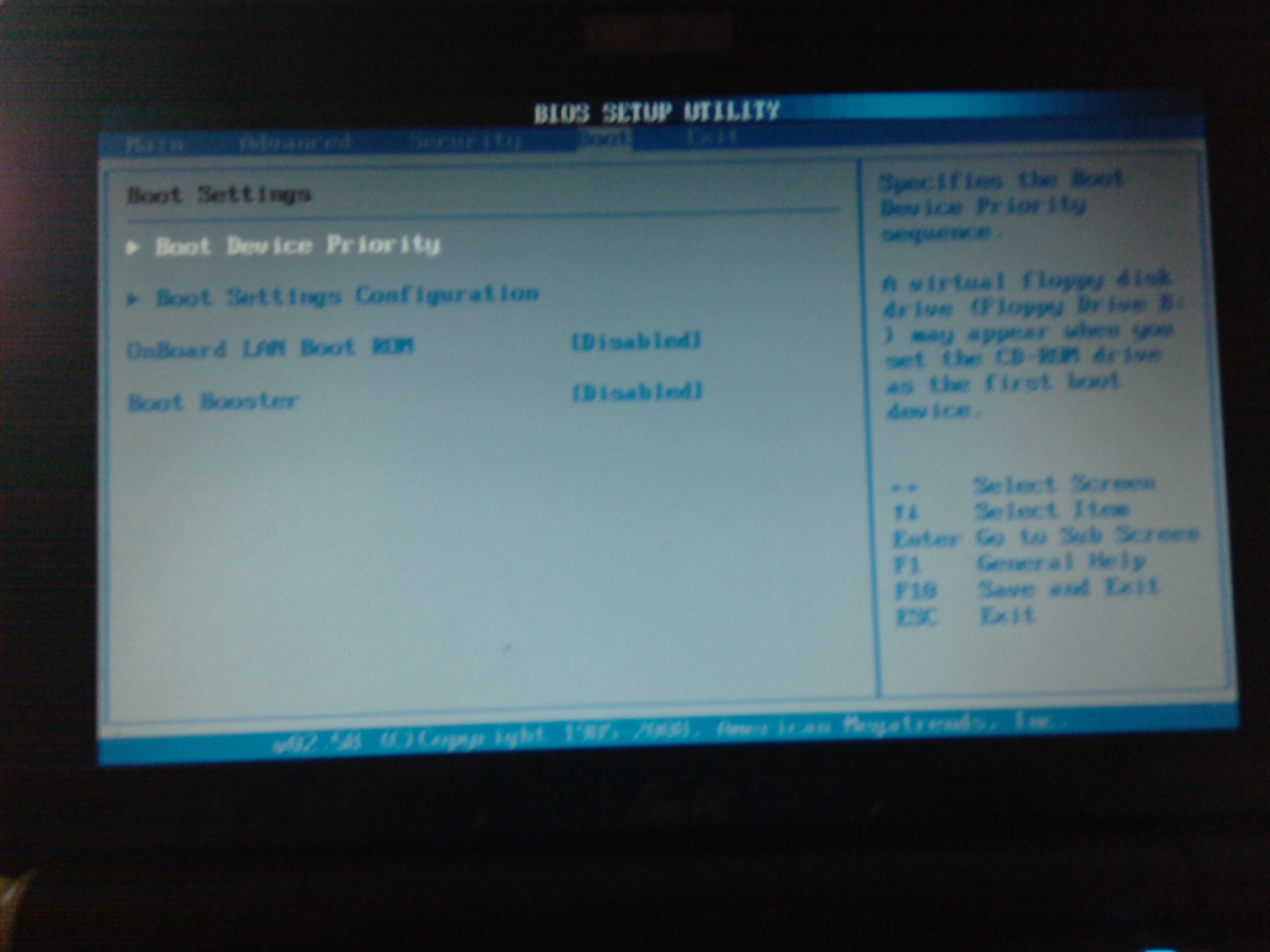

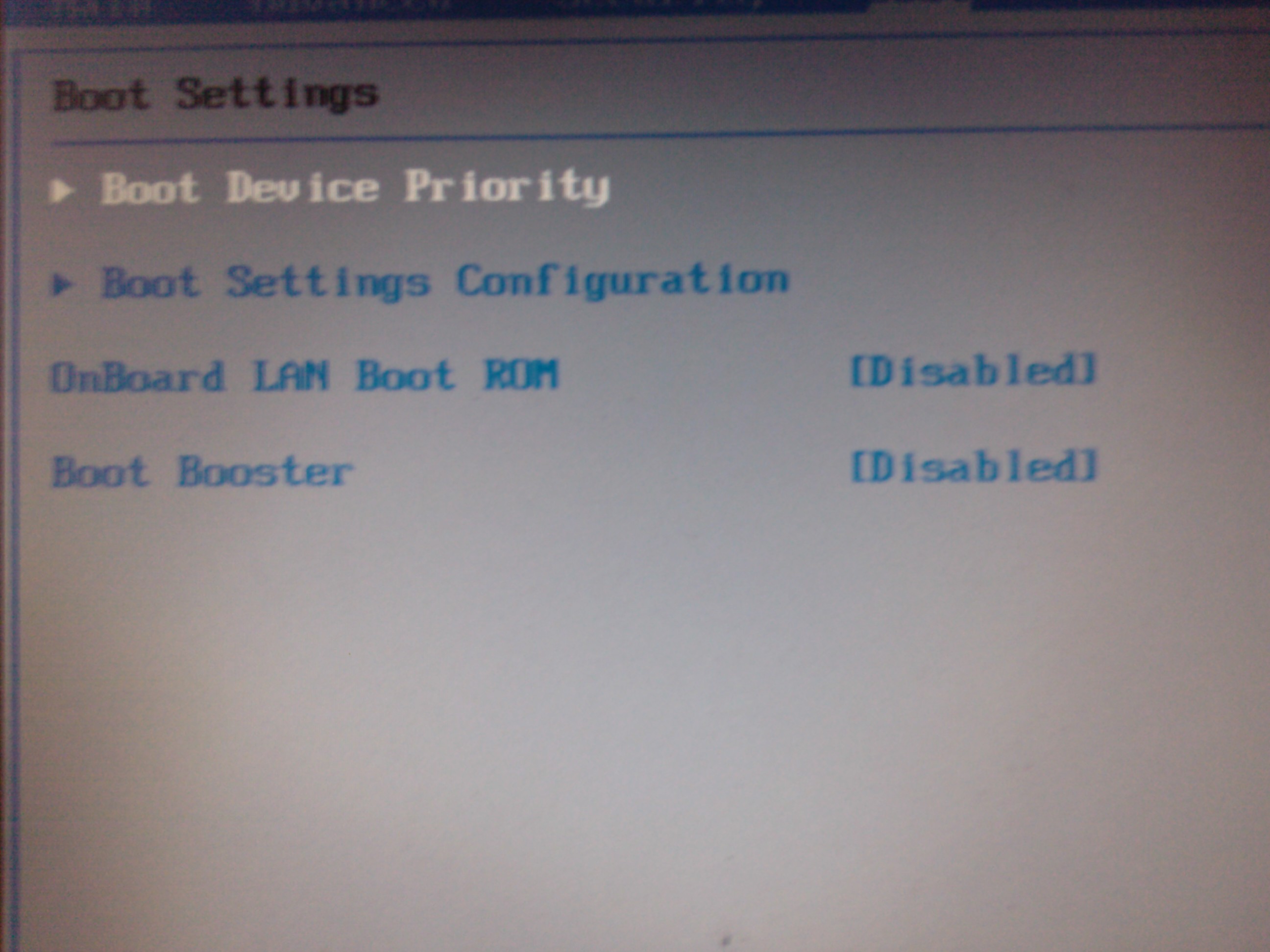

POMATu Posted July 17, 2011 Author Share Posted July 17, 2011 I disabled "Boot booster" option in bios, because when it was "boosted" I was unable to press tab and write boot parameters. And now with this option disabled, wifi works everytime. Seems like when it was a "boosted" boot, wifi didnt worked. When I used your dsdt, I had a loooong boot, but whenI use mine, it is fast. I have everything working now, except sleep menu button (I use smartsleep to go to sleep), and after wake up there is a black screen. Also voodoohda had installed, and working! but I hear some noise from speakers, even if I have no sound playing, but volume is highest. Moreover if I conect external mic I hear myself like on desktop (I had already created post about this problem ). So now should I use your dsdt? will it fix all that? will boot be as fast as with mine? Thanks, for all your help. Link to comment https://www.insanelymac.com/forum/topic/262268-atheros-ar9820-no-airport-in-list/#findComment-1716101 Share on other sites More sharing options...
