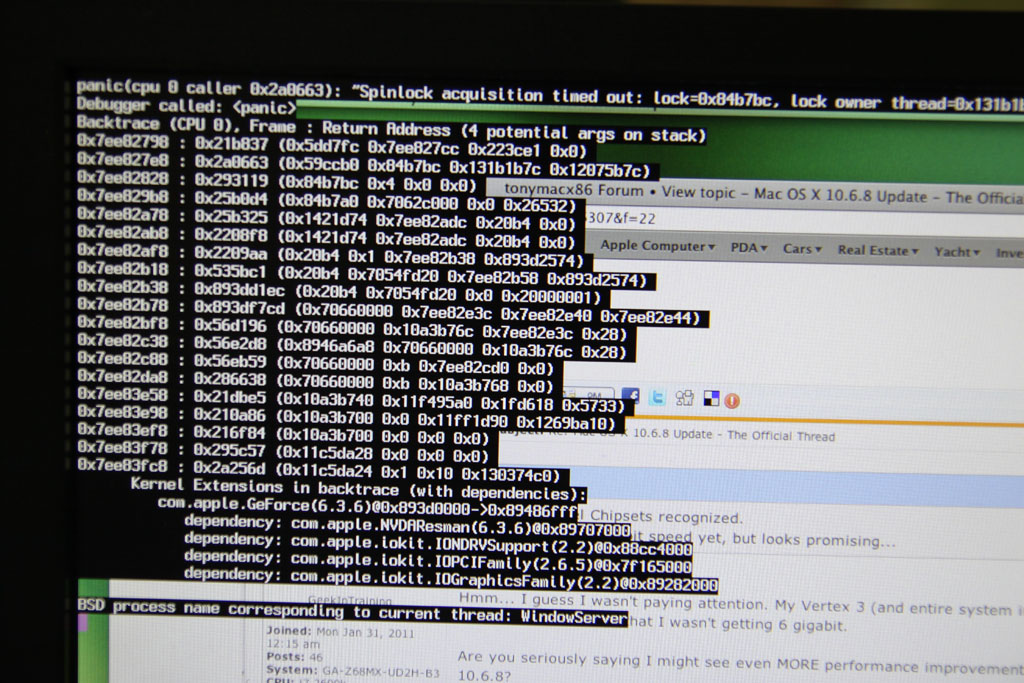

I have attached the screen shot.
My motherboard is P55-UD3L 2.3 FH
ASUS EN210 512MB Display
OS: 10.6.8
Install Method: UserDSDT [url="http://www.insanelymac.com/forum/topic/279450-why-insanelymac-does-not-support-tonymacx86/"]#####[/url] + [url="http://www.insanelymac.com/forum/topic/279450-why-insanelymac-does-not-support-tonymacx86/"]#####[/url]
Lnx2Mac Realteck 0.0.67 driver
Inside my Extra/Extensions folder:
ALC8xxxHDA.kext
FakeSMC.kext
IOAHCIBlockStorageInjector.kext
Legacy888HDA.kext
Is it something to do with my Graphic Card kext file?
It show something "com.apple.Geforce(6.3.6)"
Thanks

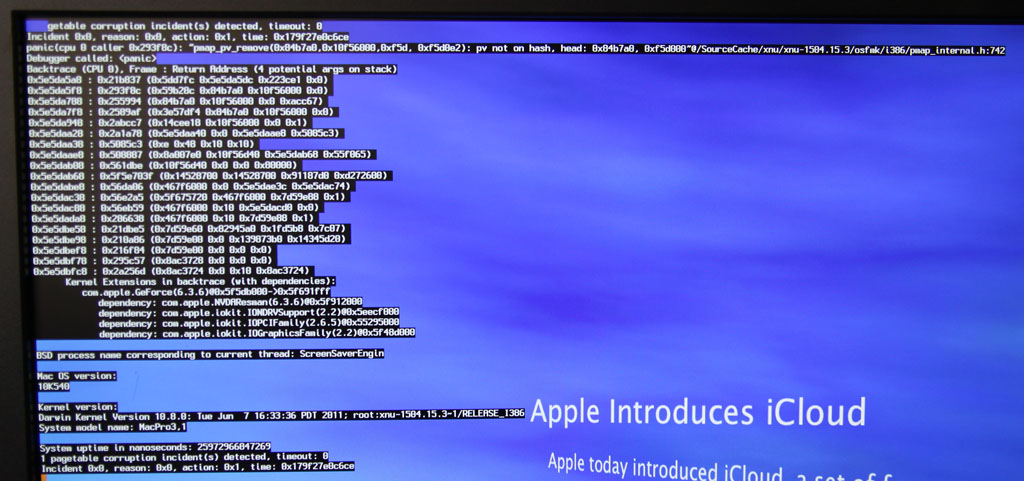

Update:
2011-07-13 Tried to clean install in a new harddrive and still got panic for some time. The Panic message is different and did not mention com.apple.GeForce any more. I think it would be somekind of hardware problem.
2011-07-15 Start to check every part of the computer. Start with RAM. I have a pair of GEIL RAM 4GB and a pair of TEAM Ram of 8GB. May be they are incompatible working together, try to remove the pair of GEIL and test now.
