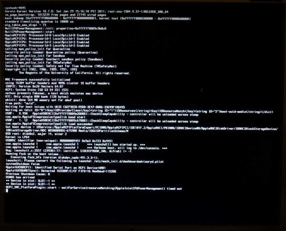

A few days i'm trying to run Palit ATI HD4850 512Mb on 10.6.3 (will be updated to 10.6.7) + Chameleon 2 RC5.
I've tried several methods, but no one doesn't work.
Well...

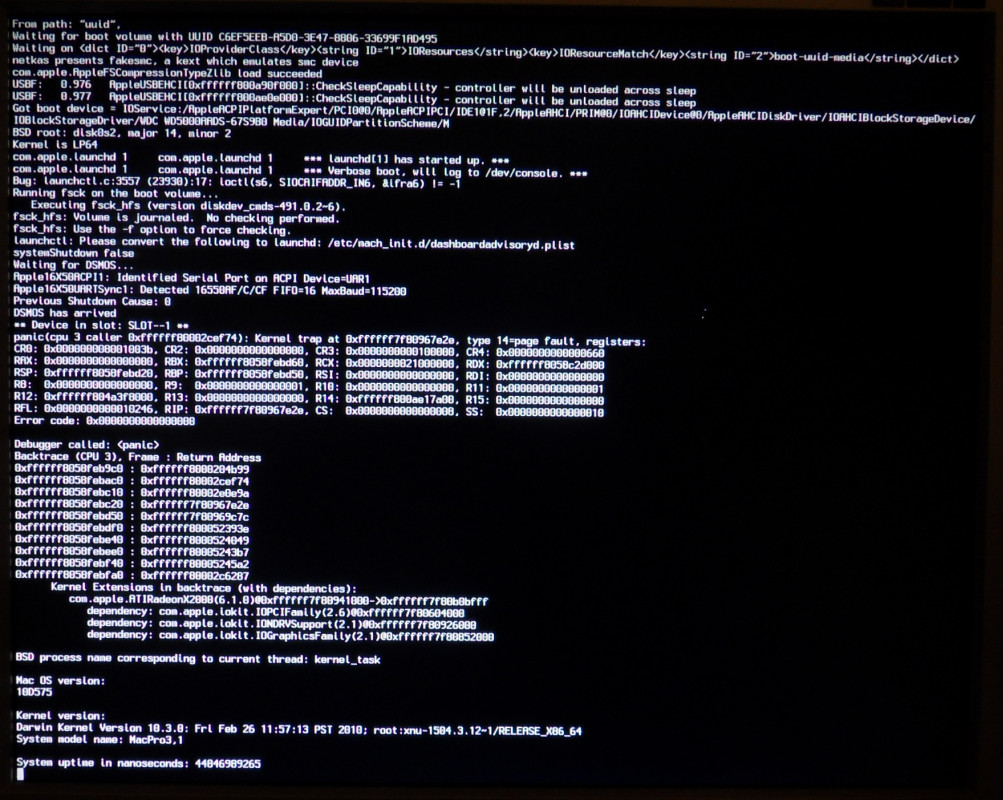

1. First of all, 10.6.3 with default kexts causes the kernel panic (arch=i386 doesn't help):
Therefore I had to remove ATIRadeonX*.kext.
2. I tried to install LegacyATI4800Controller.kext and set GraphicsEnabler to Yes.
The system still didn't boot - halted just before the desktop should appear:
1002_9442.rom + UseAtiROM=Yes don't work too.
3. I tried to edit ATI4800Controller.kext (set my DevID & VendorID) and install EVOenabler.kext.
The system boots now, but instead of the desktop I get a black screen (no signal to monitor).
Help me please!
- - - - - - - - UPDATED - - - - - - - -
Where is a mistake? That's right!
DO NOT REMOVE ATIRadeonX2000*.kext - they are required for HD4850.
