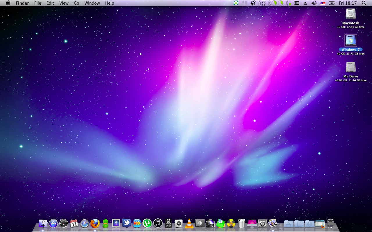

I successfully installed Snow Leopard 10.6.6i by Hazard on my Dell XPS M1210. It's fully working here are my system properties :
1- CPU : intel Core due 7200 (Fully Dual Core Support)
2- Graphic : Geforce 7400 GO (Fully Working with boot option GraphicEnabler)
3- Wifi : Intel 3945abg (not working), I used Wireless Dongle TL-WNG321 (Fully Working)
4- Sound : SigmaTel 9220 (Fully Support and Working with sigmatel9220.txt)
5- Network Card : Ethernet BCM440 : Fully working through applebcm440x.ktext)
6- Bluetooth Fully working
7- Camera (Logitech Quickcam For Dell Notebooks) Recognized in system profile, however not working (I tried maccam, manycam.. Not working)
Good luck :D:thumbsup_anim:
