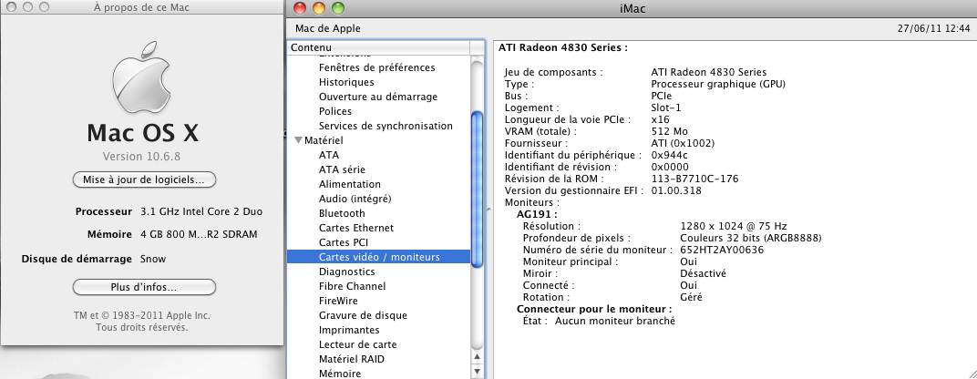

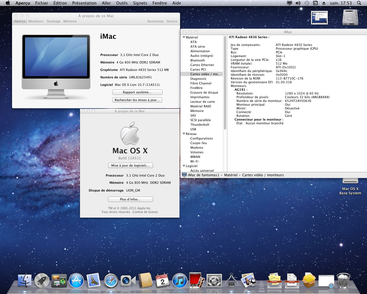

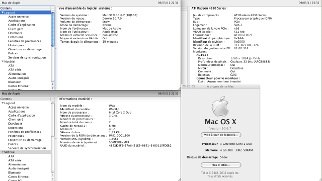

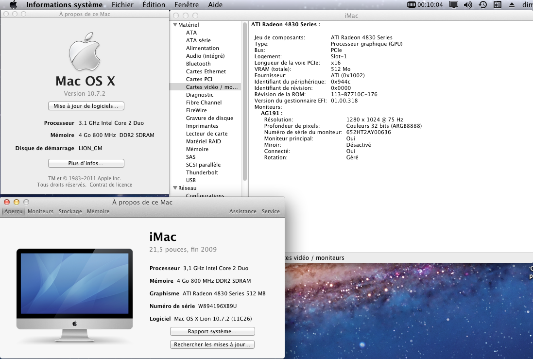

fantomas Posted July 23, 2011 Share Posted July 23, 2011 hi i have a sapphire HD 4830 ( DVI/DVI ) , and it works great without problem ! Just use a chameleon bootloader , put on your com.apple.Boot.plist : <key>GraphicsEnabler</key> <string>Yes</string> and use this kexts : for 10.6.7 : QE_CI_Exotic_patch_for_10.6.7.zip proof : for 10.6.8 : QE_CI_Exotic_patch_for_10.6.8.zip proof : for Lion : QE_CI_Exotic_patch_for_10.7.0.zip proof : ( p.s : this kexts work on Lion 10.7.2 too !!! ) proof : P.S : all credits go to Netkas ! Link to comment https://www.insanelymac.com/forum/topic/258502-ati-4830-0x944c-framebuffer-ok-but-no-qe-ci/#findComment-1720319 Share on other sites More sharing options...
