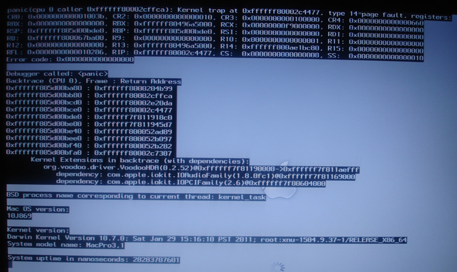

aleto Posted June 3, 2011 Share Posted June 3, 2011 hello, i'm from Brasil and get randomly kernel panics on boot or during work whit VoodooHDA, after 5 minuts or 2 hours. if driver detect my MIC in any VoodooHDA kext = Kernel Panic. Old Driver whit not detect my MIC, works perfect, no Kernel Panic. Unsuccessful attempts: - remove AppleHDA or legacyHDA - remove kext for video and network for possible conflict - update Snow Leopard 10.6.2 to 10.6.7 - install voodoohda pkg - Remove Nodes in info.plist - change IOPCIClassMatch to IOPCIPrimaryMatch on info.plist whit device e vendor id. whit detect MIC = kernel panic Whitout detect MIC = Works 100% no Kernel Panic Steps will reproduce the problem: On boot / during work / randomly. I dont have DSDT I Have Snow leopard 10.6.2(also tested in 10.6.7) in 64bit mode. Vanila Kernel. Tested any versions of VoodooHda. My sound(audio) Card PIN if necessary: <01271cf0 01271d11 01271e11 01271f41 01371cf0 01371d11 01371e11 01371f41 01471c10 01471d01 01471e13 01471f99 01571c1f 01571d40 01571e21 01571f04 01671cf0 01671d11 01671e11 01671f41 01871c30 01871d98 01871ea1 01871f04 01971c3e 01971d09 01971ea3 01971f99 01a71cf0 01a71d11 01a71e11 01a71f41 01c71cf0 01c71d11 01c71e11 01c71f41 01d71c2d 01d71d82 01d71e15 01d71f40 01e71cf0 01e71d11 01e71e11 01e71f41 0000002c> Id = 0x14C00025 thanks dump.txt Link to comment https://www.insanelymac.com/forum/topic/258412-alc268-0x14c00025-voodoohda-kernel-panic-sometimes/ Share on other sites More sharing options...
