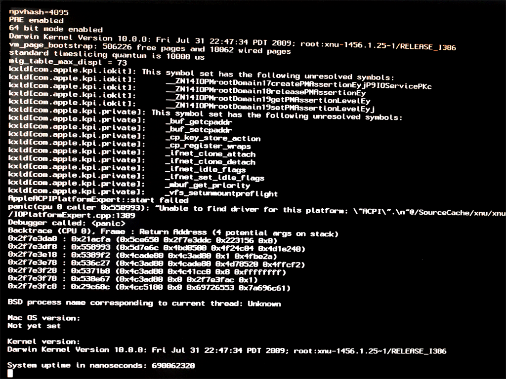

dakku Posted May 31, 2011 Author Share Posted May 31, 2011 hey mate, I disabled all of the above mentioned kexts and now i get a couple of issues: "No SMBIOS replacement found" and then I get "[ERROR] UUID='0123456789ABCDEF' syntax error" and it hangs with the following: AppleACPIPlatformExpert::start failed "Unable to find driver for this platform" edit 1 aha... I think Chameleon RC5 requires the kernel to be vanilla, i think it patches it on the fly.. I am currently using teamTeam kernel, which might explain the errors.. me trying vanilla kernel now edit 2 no joy with vanilla kernel either. same issues any help please? Link to comment https://www.insanelymac.com/forum/topic/258211-asus-at5nm10-i-atom-d525-help-with-dsdt-sleep/#findComment-1691084 Share on other sites More sharing options...
MaLd0n Posted May 31, 2011 Share Posted May 31, 2011 use smbios MacBook try arch=i386 Link to comment https://www.insanelymac.com/forum/topic/258211-asus-at5nm10-i-atom-d525-help-with-dsdt-sleep/#findComment-1691094 Share on other sites More sharing options...

dakku Posted May 31, 2011 Author Share Posted May 31, 2011 here is what I did overall: added DSDT.aml one from above compile Chameleon RC5 mkdir temp cd temp svn co http://forge.voodooprojects.org/svn/chameleon/branches/meklort cd meklort make clean make embedtheme mv sym/i386/boot /boot removed kexts Evoreboot nullcpupowermanagement openhaltrestart platformuuid create caches using pfix added smbios.plist one from above results: if i use kernel from 10.6.6, i get 1 error and black screen on kernel load: "[ERROR] UUID='0123456789ABCDEF' syntax error" if I use kernel from 10.6.1, i get same error as above and I get the following (screenshot attached) on kernel load. any help please? Link to comment https://www.insanelymac.com/forum/topic/258211-asus-at5nm10-i-atom-d525-help-with-dsdt-sleep/#findComment-1691122 Share on other sites More sharing options...
dakku Posted May 31, 2011 Author Share Posted May 31, 2011 FINALLLLLY some progress I had made a mistake in installing meklort Chameleon RC5 over myhack installer version. you CANNOT simply cpoy the boot file as in my instructions above. CORRECTIONS - I had to install Chameleon RC5 using Chameleon_2.0_RC5_r828.zip - Vanilla Kernel from 10.6.6 results in a black screen once the kernel is loaded. For now, I am using the TeaTeam's kernel with DSDT by MaLd0n (thanks again). still no sleep BUT its running using only FakeSMC.kext Link to comment https://www.insanelymac.com/forum/topic/258211-asus-at5nm10-i-atom-d525-help-with-dsdt-sleep/#findComment-1691213 Share on other sites More sharing options...
