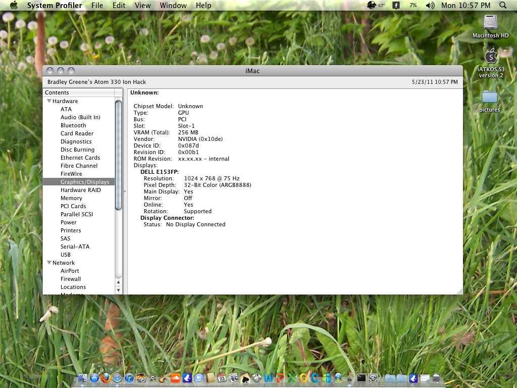

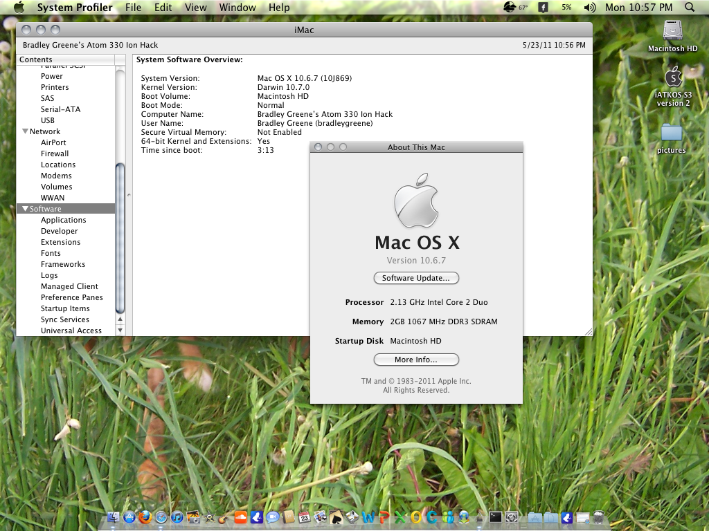

Brad Greene Posted May 24, 2011 Share Posted May 24, 2011 I put together what I consider to be the ULTIMATE budget hack... ASUS AT3IONT-i $125 4Gb (2x2Gb) 1066MHz DDR3 RAM $50 I used a spare SATA drive I had kicking around or about $50 Any old PSU and case... A lot of people will scoff at the Atom processor but I have my 1.6GHz Dual Core 330 unit clocked to 2.13Ghz with no fan, and I have no issues... I am running 10.6.7 from an iAtkos install... The onboard ION graphics (same as the last MacBook) handle 1080 playback without a hiccup... If you decide to got this route I can even post my .kext files and my /Extra folder as well as post instructions... Good luck either way man... Attached is a screenshot... Note: 2.13GHz clock speed and 64-bit kernel and etensions, and in the second the Accelerated graphics... Link to comment Share on other sites More sharing options...
fventura03 Posted May 26, 2011 Share Posted May 26, 2011 I put together what I consider to be the ULTIMATE budget hack...ASUS AT3IONT-i $125 4Gb (2x2Gb) 1066MHz DDR3 RAM $50 I used a spare SATA drive I had kicking around or about $50 Any old PSU and case... A lot of people will scoff at the Atom processor but I have my 1.6GHz Dual Core 330 unit clocked to 2.13Ghz with no fan, and I have no issues... I am running 10.6.7 from an iAtkos install... The onboard ION graphics (same as the last MacBook) handle 1080 playback without a hiccup... If you decide to got this route I can even post my .kext files and my /Extra folder as well as post instructions... Good luck either way man... Attached is a screenshot... Note: 2.13GHz clock speed and 64-bit kernel and etensions, and in the second the Accelerated graphics... was it a straight forward install? how come you're running such a low display resolution ? Link to comment Share on other sites More sharing options...

bradgreene313 Posted March 13, 2012 Share Posted March 13, 2012 I used the Retail method... I only had to find .Kext files for sound... ALC882 I believe... I am running at 1024x768 because that is all my monitor supports... Keyword "budget build"... Link to comment Share on other sites More sharing options...
