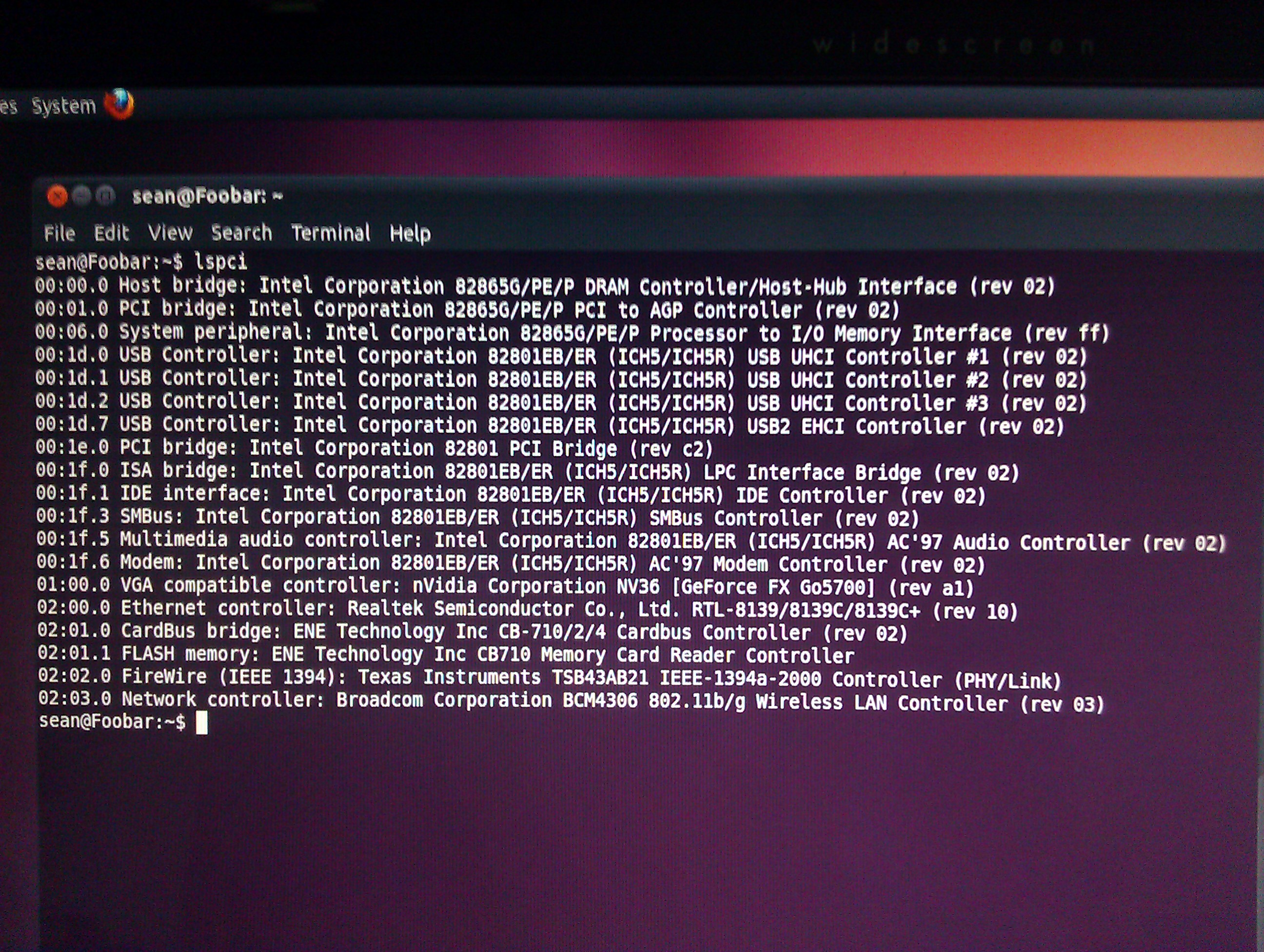

EDIT:
For what it's worth, I have enumerated the hardware with a copy of Ubuntu I was able to successfully install. Attached is the screenshot showing the device information. At this point, I'm just going to wait and try again another day. I would like to know if there are any red flags or others who have experienced an unresponsive hard drive.
Also, I switched out the hard drive to another, older 80 GB and the same thing happened. I also tried to install to the HD using an extenal USB drive adapter, with the same behavior. It seems controller or CPU related..
