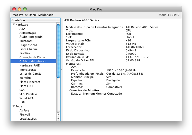

ranjan Posted April 25, 2011 Share Posted April 25, 2011 Am fed up of trying to run ATI HD 4850 512M GDDR3 PCI-E DUAL DVI-I/TVO on hackintosh I tried till the end but still my ATI HD 4850 512M GDDR3 PCI-E DUAL DVI-I/TVO seems not working Some forum says yes some says No What is the truth does ATI HD 4850 512M GDDR3 PCI-E DUAL DVI-I/TVO really works on hackintosh or Not ,there is still an (?) on my mind I used iATKOS S3 V2 10.6.3 to Setup , Setup worked fine till 100% After reboot ATI HD 4850 512M GDDR3 PCI-E DUAL DVI-I/TVO was not supported So I used my old Graphic Card Ge-force 6200 It helped to run well all resolution worked good till (1920 x 1080) The problem in this graphic card is... , It is too old and there is disturbance on display I tried updating the software to 10.6.7 I restarted after installation I put my ATI HD 4850 512M GDDR3 PCI-E DUAL DVI-I/TVO back It worked but not fully ,resolution was till (1024 x 768) i tried every thing i.e. netkas.org [url="http://www.insanelymac.com/forum/topic/279450-why-insanelymac-does-not-support-tonymacx86/"]#####[/url] <key>graphic mode</key> <string> 1920x1080x32@60hz</string> kext helper b7 switchResX I ruined my 1 TB hdd with important document on it ,trying this If some body has right answer please reply Link to comment https://www.insanelymac.com/forum/topic/255583-does-ati-hd-4850-512m-gddr3-pci-e-dual-dvi-itvo-works-on-hackintosh/ Share on other sites More sharing options...
MaLd0n Posted April 25, 2011 Share Posted April 25, 2011 Use Clean Install Update to 10.6.7 and... 1- use the kext legacyati4800controller.kex (E/E or S/L/E) http://www.insanelymac.com/forum/index.php...st&id=59328 2- Graphicsenabler Use Lizard http://dl.dropbox.com/u/1034555/lizard/Lizard-custom.zip 2a-Auto detect value 2b-GraphicsInjection 2c-save Link to comment https://www.insanelymac.com/forum/topic/255583-does-ati-hd-4850-512m-gddr3-pci-e-dual-dvi-itvo-works-on-hackintosh/#findComment-1674318 Share on other sites More sharing options...
ranjan Posted April 25, 2011 Author Share Posted April 25, 2011 Thanks you very much it worked ........amazing My hackintosh is 100% done now Link to comment https://www.insanelymac.com/forum/topic/255583-does-ati-hd-4850-512m-gddr3-pci-e-dual-dvi-itvo-works-on-hackintosh/#findComment-1674431 Share on other sites More sharing options...
