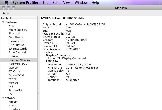

Palit GeForce 8400GS 512mb CONFIRMED
Nothing special, no special drivers. OSx86 10.6.6i
GraphicsEnabler must be on.
Change GeForce.kext/ and NVDANV50Hal.kext/ Info.plist IOPCIMatch to
0x10c310de
Add to end of com.apple.Boot.plist.
<key>device-properties</key>
<string>d60300000100000001000000ca0300001500000002010c00d041030a00000000010106000
0010101060000007fff04003a000000400032002c0068007700730065006e0073006f0072002d00700
06100720061006d0073002d00760065007200730069006f006e00000008000000000000022200000
0400032002c006400650076006900630065005f0074007900700065000000120000004e5644412c
6770752d64696f64650e0000004e00560050004d000000200000000100000000000000000000000
00000000000000000000000000000001e00000072006f006d002d00720065007600690073006900
6f006e0000000d00000049545f574f524b4544100000004e00560043004100500000001800000004
000000000003000c000000000000070000000022000000400032002c002300730069007a0065002
d00630065006c006c0073000000080000000000000022000000400030002c006400650076006900
630065005f00740079007000650000000b000000646973706c6179100000006d006f00640065006
c0000001f0000004e5649444941204765466f72636520383430304753203531324d4214000000400
030002c006e0061006d0065000000120000004e5644412c446973706c61792d412000000040003
2002c0063006f006d00700061007400690062006c0065000000160000004e5644412c73656e736
f722d706172656e7414000000400031002c006e0061006d0065000000120000004e5644412c446
973706c61792d4212000000400032002c00720065006700000008000000000000021c000000640
0650076006900630065005f0074007900700065000000100000004e5644412c4765466f72636520
000000400031002c0063006f006d00700061007400690062006c00650000000e0000004e564441
2c4e564d616326000000400032002c0023006100640072006500730073002d00630065006c006c
007300000008000000000000010e0000006e0061006d00650000000f0000004e5644412c506172
656e7422000000400031002c006400650076006900630065005f00740079007000650000000b0
00000646973706c617920000000400030002c0063006f006d00700061007400690062006c00650
000000e0000004e5644412c4e564d6163220000005600520041004d002c0074006f00740061006
c00730069007a0065000000080000000000002036000000400032002c006800770063007400720
06c002d0070006100720061006d0073002d00760065007200730069006f006e000000080000000
000000214000000400032002c006e0061006d00650000001100000073656e736f722d706172656e74</string>
Follow Instructions here to enable QE/Q2E blah, blah.
http://wiki.awkwardtv.org/wiki/Enable_Quar...artz_2D_Extreme
Reboot.
Boot with -f option.
It the screen blanks out blue when it comes up. Force reboot. It should come up by itself, and stop that {censored}.
If it doesn't work, play with it till it does.
