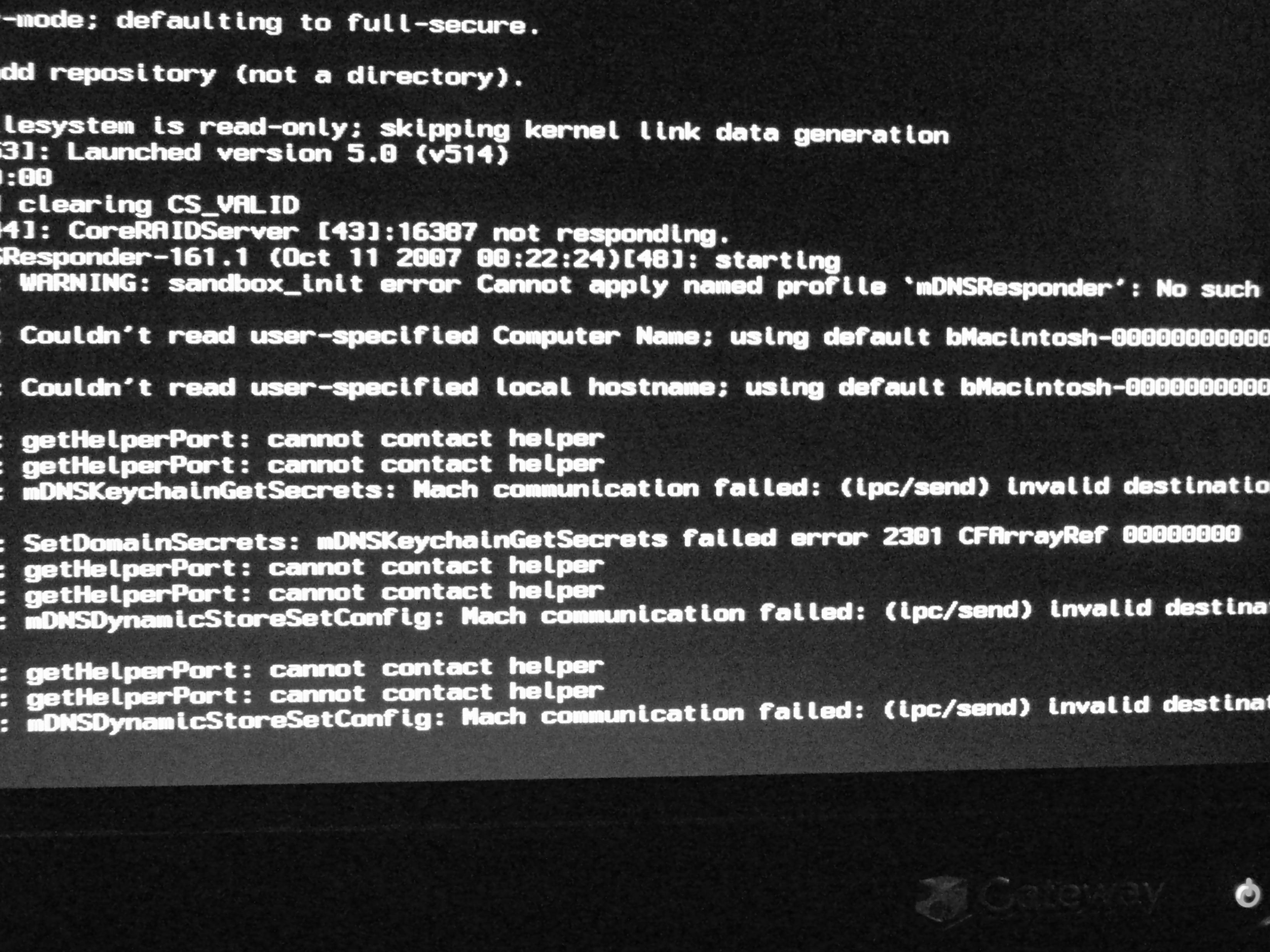

verbul Posted February 22, 2011 Author Share Posted February 22, 2011 Tried the paperclip trick first, along with external monitor. even forced with "graphics mode"="1024x768@60" it did not work. figured out how to delete kexts with -s and some commands, so i tried the delete buffer trick, it didnt work either. there are a few other things i would like to try. Is there a command from -s to add kexts from a flash drive? And which kexts would someone recommend for this laptop? The install said it went fine, and it boots from the HDD, it seems to just not have the correct video kexts. I made a homebuilt win 7 box and it had a similar issue, the boot screen would roll and flicker on my TV until it actualy loaded windows. I'm guessing this is the reverse. sorry about the bad pics, if i went out any further, you couldnt read them Quote Link to comment https://www.insanelymac.com/forum/topic/248850-gateway-cx2610/#findComment-1643824 Share on other sites More sharing options...

verbul Posted February 24, 2011 Author Share Posted February 24, 2011 Ok tried Iatkos, and macdotnub. Only ideneb seems to go through to a complete install. found a smaller usb drive, gonna try to mount that and hopefuly make some fixes. ok so my new snag is with copying kexts from a flashdrive. first when i creat a drive i get that disk1s3 is write protected. if i read my google right, its trying to mkdir on the install cd? But then it tells me that /volumes/usbstick allready exists. ok onto mounting part, try to mount /usbstick, i get: can't add repository (not a directory). then when i try to copy it tells me that /volumes/usbstick/elliotappleintelgma950legacyenabler.kext: no such file or directory. Also when typing msdos in the mount -t command, i get mount_msdos: msdos filesystem is not available So: 1: it didnt create /usbstick? 2: cant mount what doesnt exist, with a filesystem that doesnt exist? 3: it cant find, what isnt on, what doesnt exist, with a filesystem that doesnt exist. this is what i typed (omitting aforementioned errors) /sbin/mount -uw / mkdir /Volumes/usbstick ls /dev/disk* (then plugged in usb stick) ls /dev/disk* (noted new entries: /dev/disk2 & /dev/disk2s1) mount -t msdos /dev/disk2s1 /Volumes/usbstick cp -r /Volumes/usbstick/ElliotAppleIntelGMA950LegacyEnabler.kext /Volumes/OSX/System/Library/Extensions/ ElliotAppleIntelGMA950LegacyEnabler.kext Quote Link to comment https://www.insanelymac.com/forum/topic/248850-gateway-cx2610/#findComment-1644669 Share on other sites More sharing options...

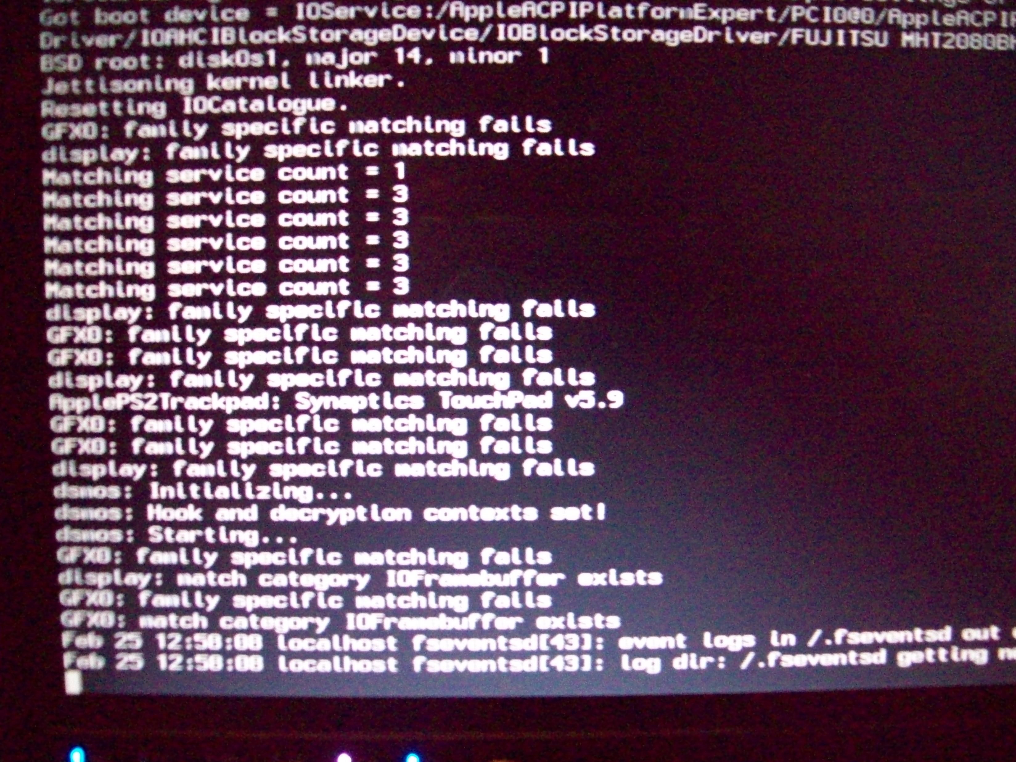

verbul Posted February 26, 2011 Author Share Posted February 26, 2011 ok, so if you eject the install disc, it clears all errors with the mounting and copying. Next i booted back in with my install disc using -x, and repaired permissions on my hdd (osx), then rebooted from hard drive. And...... that gave me a 2 sec bluescreen then onto......... a bluescreen, and a catchy little tune. with external monitor saying frequency out of range So i rebooted again using : "graphics mode"="1027x768@32" with same result. making progress, any ideas now? here is the last few lines before it goes blue from -v Quote Link to comment https://www.insanelymac.com/forum/topic/248850-gateway-cx2610/#findComment-1645416 Share on other sites More sharing options...
