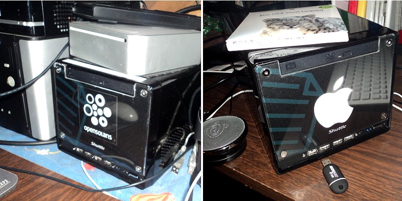

My path has been somewhat tortuous in getting the install to work. The K45 has a lot of quirks and I cursed OS X many times for the idiosyncratic behaviour. Clearly, Apple didn't make this easy, but it's especially painful, because as a kernel engineer, I deal with device drivers, buses, and device configuration spaces, and to have an OS purposely not see devices makes me almost pull my hair out.

9. After installation and customization completed and bootloader installed, I powered off system, and attached slim SATA DVD burner. Voila, stuck a Stargate Atlantis Season 5, disk 1 into slot, and DVD player pops up and plays! No DRM warnings! And then went to the Apple Menu and clicked on Sleep... and power went from 46 Watts idle to 3 Watts. I clicked the mouse and 8 seconds later, I'm back up to my windowing system. Cool. Power management and Suspend to RAM are working.
