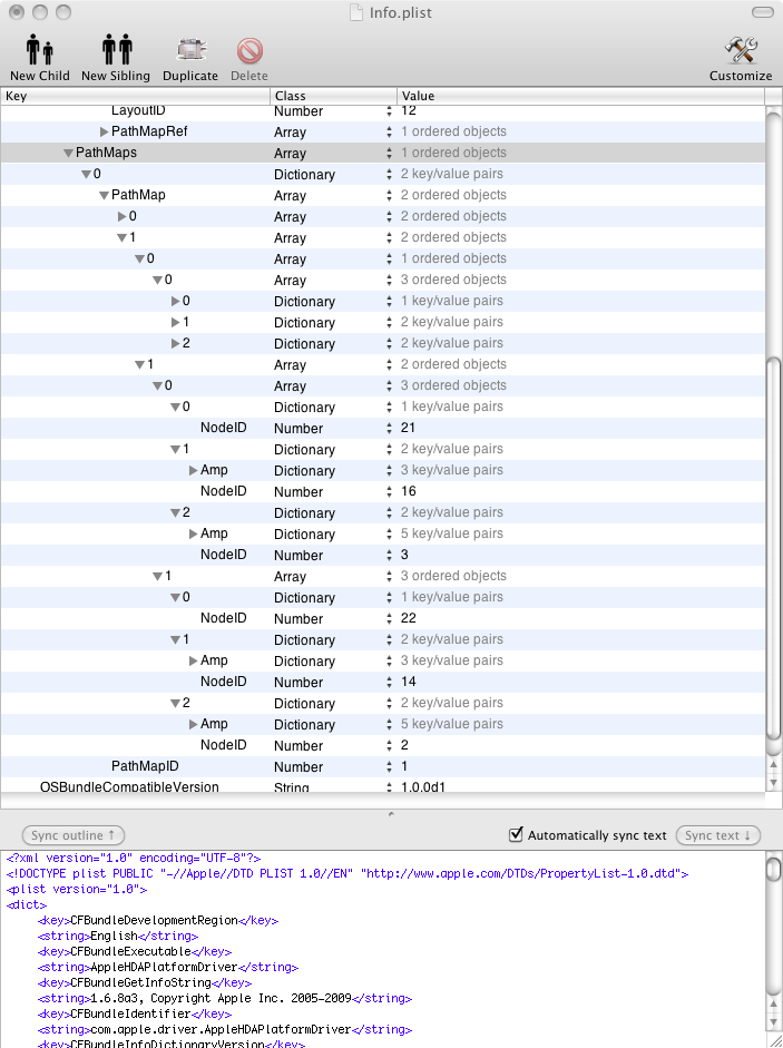

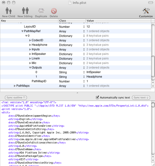

Cheops Posted February 16, 2011 Share Posted February 16, 2011 Hi, My laptop has 2 sets of speakers, 21->16->3 ( L/R Tweeters ) 22->14->2 ( Single Bass ) I have defined my pathmaps like the following, However when I try and play I get stuttering! Can anyone see whats wrong with my layouts? Thanks Link to comment https://www.insanelymac.com/forum/topic/248069-help-with-my-pathmap-layout-please/ Share on other sites More sharing options...
J Lamp Posted February 28, 2011 Share Posted February 28, 2011 The problem might not be your pathmap, You can have a look at this, http://www.insanelymac.com/forum/index.php?showtopic=196771 scroll down to item #11. Another possible fix, depending on your chipset, may be to specify the machine in the SMBIOS.plist as a MacPro 3,1. Both of these fixes have worked for me on various machines. Link to comment https://www.insanelymac.com/forum/topic/248069-help-with-my-pathmap-layout-please/#findComment-1646512 Share on other sites More sharing options...
