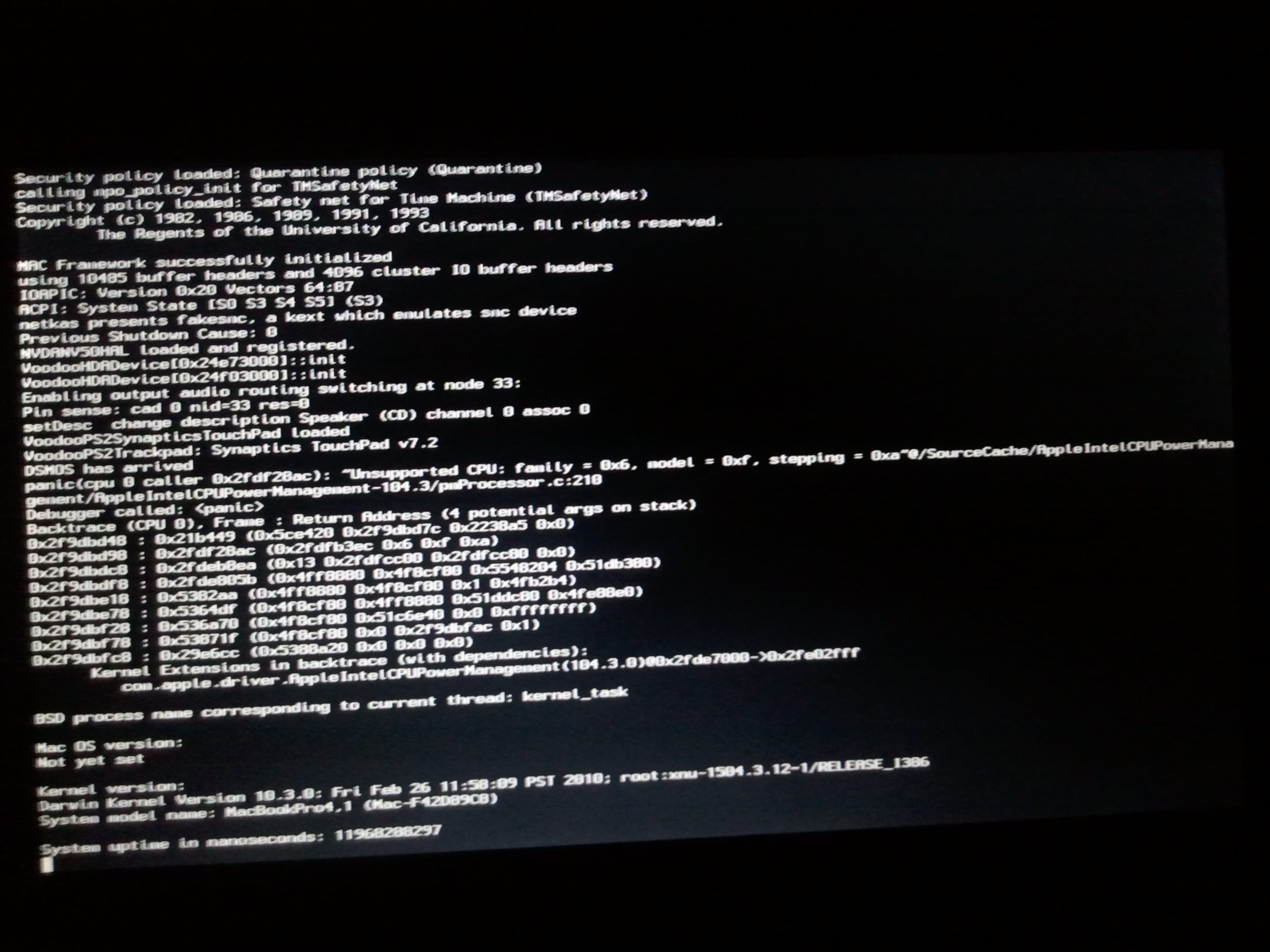

NachoX86 Posted April 19, 2011 Share Posted April 19, 2011 Hello guys, i bought an Asus 1201PN and try to install iAtkos V3 S2 from the DVD and follow the instructions like dosenoeffna and installs ok, but when i reboot have a kernel panic.. It says Unsupported CPU ?? I choose the Atom Kernel when installing and chameleon 2.0 RC4. I tried with cpus=1 but no success, tryed with busratio=10 or 20 and still nothing.. If anyone can help me i really apreciate it.. The specs of my 1201PN are: Atom 450N @ 1.66Ghz 2GB Ram HDD 320GB Ion2 - 512mb (i don`t know if in iAtkos S3 V2 works QE) Broadcom Bluetooth Atheros Wifi 802.11b/g/n Regards, Nacho. Quote Link to comment https://www.insanelymac.com/forum/topic/246830-asus-eee-pc-1201pn/#findComment-1672262 Share on other sites More sharing options...
NachoX86 Posted April 21, 2011 Share Posted April 21, 2011 Finally i can boot on my 1201PN!!! The problem was in BIOS Setup in Advanced-> Advanced CPU Settings -> Max CPUID Value Limit (It was Enabled) I put in Disabled, Save&Exit, Reboot and voila! After reboot i have installed the 10.6.6 combo update and later [url="http://www.insanelymac.com/forum/topic/279450-why-insanelymac-does-not-support-tonymacx86/"]#####[/url] but i choosed the last option of VoodooHDA (the most newer version), i did not installed the Chameleon 2.0 RC5 Bootloader the same as the user applix says (i have Cham 2.0 RC4 no) and after reboot and always when the system is running, on background I have always a noise sound through the speakers, on the 10.6.3 version i don't have this problem, so I think that the problem was in the updated VoodooHDA Driver.. But i don't know how can i do to revert to the old driver.. Another thing is i can run until now with QE/CI and so i can't view 1080p in youtube or view 1080p movies because i have lower frame rate Anyone got the Ion2 running well on this notebook?? Quote Link to comment https://www.insanelymac.com/forum/topic/246830-asus-eee-pc-1201pn/#findComment-1672914 Share on other sites More sharing options...
