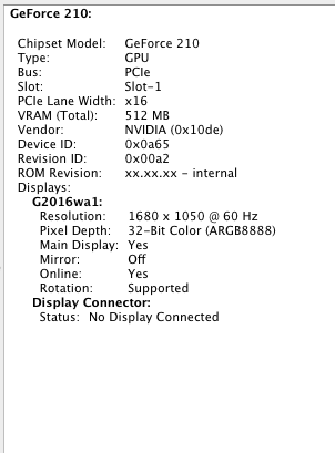

Hi everyone, thanks for reading my post. The thing is that i have installed my GeForce 210 succesfully (with a few minor problems) on my Optiplex GX620 running Snow Leopard 10.6.6. Now the issue is that if i try to boot using the DVI connector the screen will just go blank (black screen) but if i use the VGA connector it will boot with no problems. Ok so i found a work-around for this issue if i have both connectors plugged in to the video card it will but just fine to the DVI. Can someone help me out here? im not a tech type guy so please, something simple would be great.
Thanks! ;)
Here's a screen shot of my Graphics/Display section on the System Profiler

yep add this to your boot.plist and turn off graphics enabler and remove any enablers
<key>device-properties</key>
<string>6e0200000100000001000000620200000d00000002010c00d041030a010000000
101060000010101060000007fff04001e00000072006f006d002d00720065007600690073
0069006f006e0000002a0000006e5669646961204765466f72636520323130204f70656e4
74c20456e67696e65205b4546495d22000000400030002c0064006500760069006300650
05f00740079007000650000000b000000646973706c6179100000004e0056004300410050
00000022000000d38d34d34d34d34d34d37d34d3cd34d34d34d34d34d34d3bd34d34d34d
340e0000006e0061006d00650000000b000000646973706c617914000000400030002c00
6e0061006d0065000000120000004e5644412c446973706c61792d41100000006d006f006
40065006c000000160000006e5669646961204765466f726365203231300e0000004e0056
0050004d00000020000000010000000000000000000000000000000000000000000000000
0000014000000400031002c006e0061006d0065000000120000004e5644412c446973706c
61792d4220000000400031002c0063006f006d00700061007400690062006c00650000000
e0000004e5644412c4e564d6163220000005600520041004d002c0074006f00740061006c
00730069007a0065000000080000000000002020000000400030002c0063006f006d00700
061007400690062006c00650000000e0000004e5644412c4e564d61632200000040003100
2c006400650076006900630065005f00740079007000650000000b000000646973706c617
91c0000006400650076006900630065005f00740079007000650000000f0000004e5644412
c506172656e74</string>
