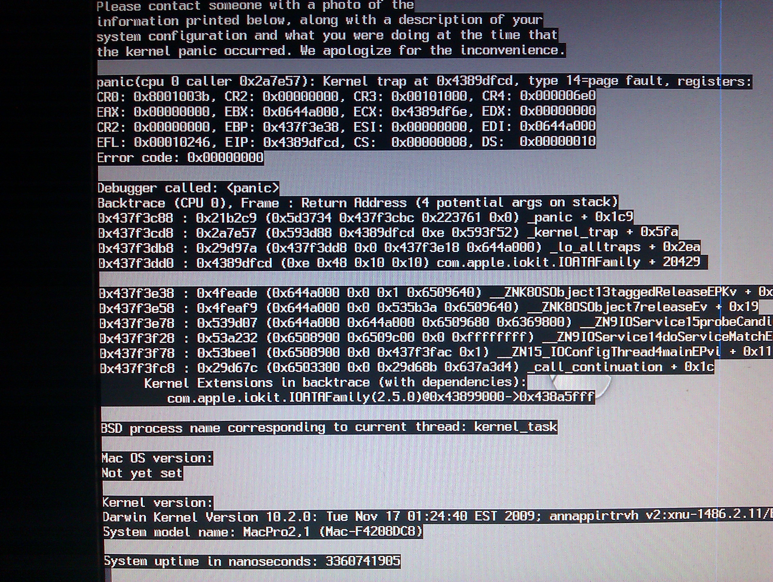

I installed Snow Leopard on my AMD Pc using Hazards version.
It installed perfect but upon rebooting I was given this screen
Could I get help with this please? :)

I hope so. But you need to help us. I mean, we need to know your hardware. Knowing that you have an AMD CPU is not enough.
Thank you for your reply :D
System Specs are;
Processor: AMD Athlon LE-1620, 2400 MHz
Motherboard: Asus M3A78-CM
Memory: 3x 1GB DDR2 OCZ
Graphics: ATI Radeon 3100
Sound: VIA VT1708B CE
Hard Drive: Western Digital 500GB (Windows 7 Installed on), Western Digital 320GB (Snow Leopard installed on)
If you need to know anything else please ask. :)

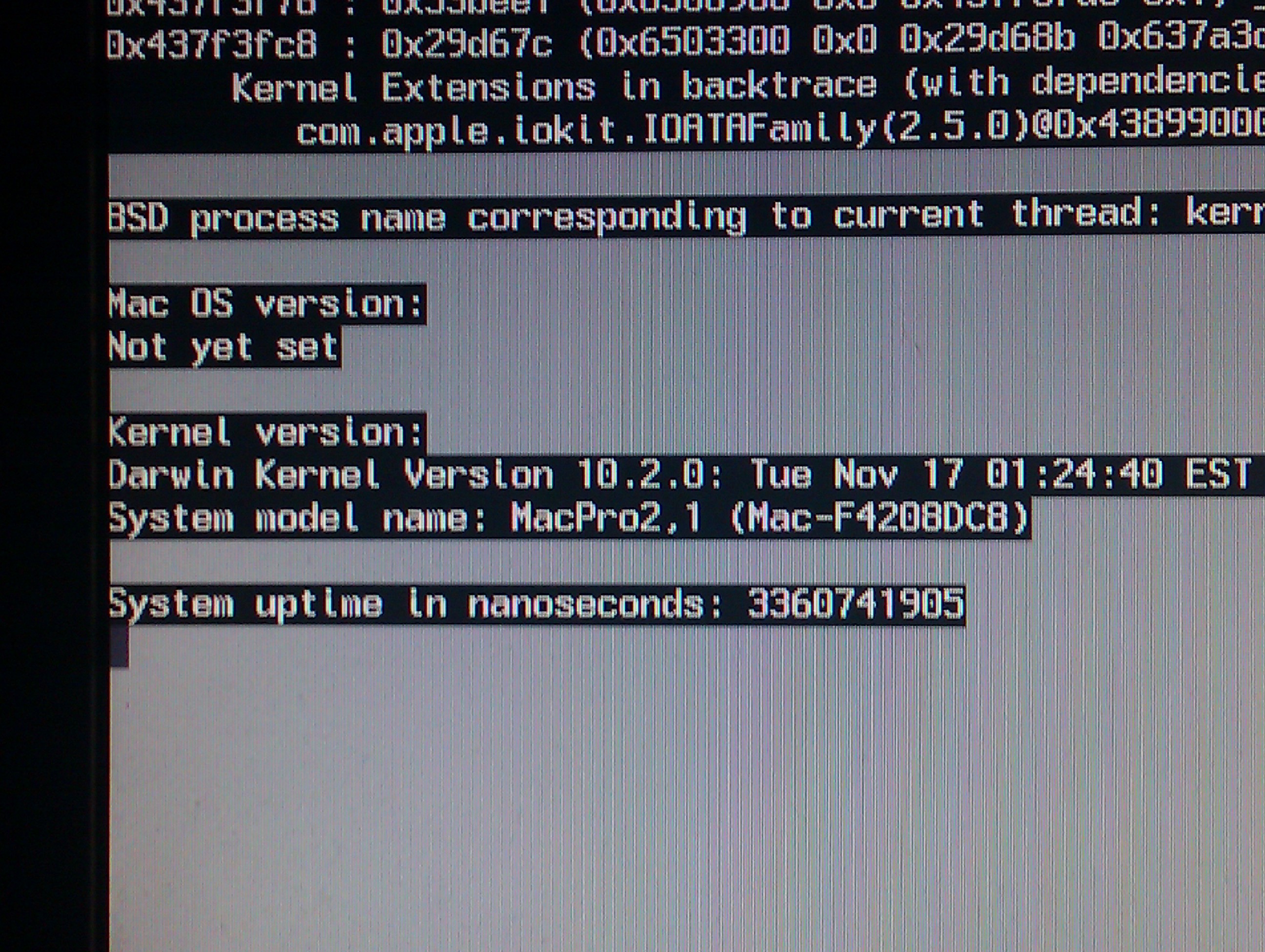

Looking at your screenies, it's a prob with IOAtaFamily. You can replace this kext with another version that fixes the kernel panic (see IOATAFamily fix). Replace via single user mode, or use HFS+, or maybe [url="http://www.insanelymac.com/forum/topic/279450-why-insanelymac-does-not-support-tonymacx86/"]#####[/url] or Nawcom ModCD, then after replacing, reboot with -f (won't load without -f, it'll give you load errors).
