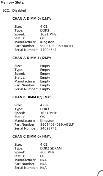

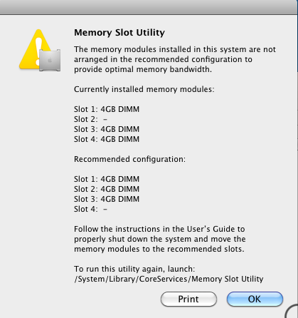

The problem I have now is that my memory slot configuration is messed up. After initial boot after installing Chameleon RC5 r700 I got the memory slot utility which popped up telling me the configuration of my memory modules was incorrect. Prior to installing Chameleon RC5 r700 my memory modules were perfectly detected. Also notice that the one dimm (Chan C Dimm 0/J4MY) is now detected as DDR-2 and does not show the Kingston Name as it does with the other 2. I have double-checked that my memory is in the correct slots.

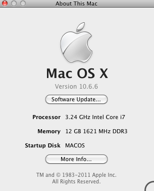

System appears to be running fine and fast but this does concern me a little that OSX is not seeing the memory properly.

You might be able to manually set your memory manufacturer and such in your smbios file. I don't think your current situation is impacting your performance though. I had the same message on my system but my motherboard is reporting that i'm running triple channel.
OS X is probably confused because the DX58SO got four slots of which only three slots are used for triple channel but the spare slot (marked as channel A) is still empty.
