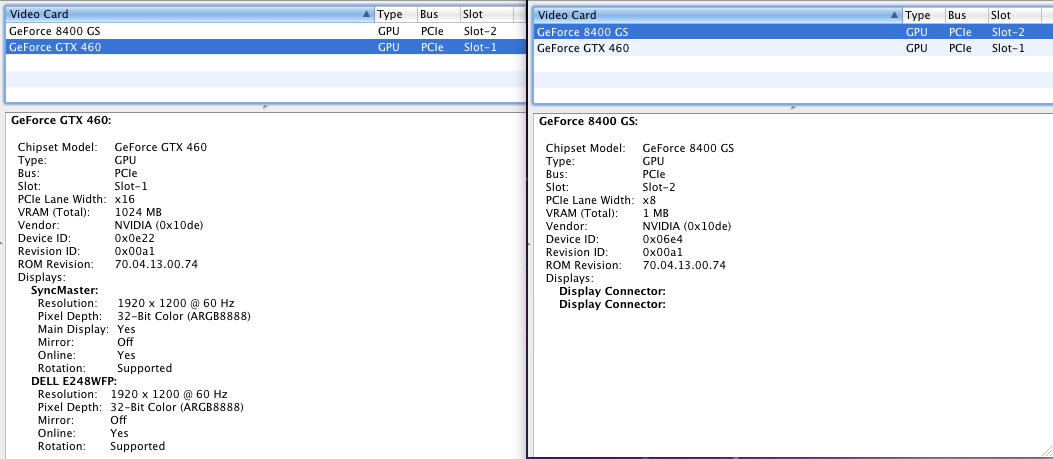

akasurreal Posted January 27, 2011 Share Posted January 27, 2011 I have finally gotten my system working perfectly except for one thing. I have a second video card I use to run a 3rd monitor in Win7, and I would love to be able to do the same in OSX. The problem is that for some reason it doesn't seem to detect a monitor plugged into it. I attached a screenshot from profiler of both video cards below. I have seen others get triple monitors to work, so I know it is possible but have no idea why mine isn't working. I noticed the VRAM info is wrong on the second card too. I also tried using an 8800GT as my second card and got the same results. Full System Specs for reference: ASUS P6X58D Premium Core i7-930 2.8GHz EVGA GeForce GTX 460 (primary vid card) Asus GeForce 8400 GS (second vid card) 6GB RAM @ 1600MHz OCZ Vertex SSD 128GB Thanks! Michael Quote Link to comment https://www.insanelymac.com/forum/topic/245376-triple-monitors-with-two-nvidia-cards/ Share on other sites More sharing options...

akasurreal Posted January 27, 2011 Author Share Posted January 27, 2011 what was your procedure? did each work single in the slot it should work later on? if yes - did you notice the according pci root? I am not sure if I understand your question. My exact current hardware configuration does work in my Win7 boot right now if that's what you mean. When setting up OSX, I originally started with only the 460 plugged in, and had to boot/install using PCIRootUID=1, but after the install was complete I took that out, and that is how I got my 460 to work. Not sure if I am answering your question? Quote Link to comment https://www.insanelymac.com/forum/topic/245376-triple-monitors-with-two-nvidia-cards/#findComment-1630568 Share on other sites More sharing options...
akasurreal Posted January 28, 2011 Author Share Posted January 28, 2011 I figured this out by going here: http://aquamac.proboards.com/index.cgi?boa...&thread=569 I did have to move my second video card to a different slot as well, which was the final piece of the puzzle. Works great now! Quote Link to comment https://www.insanelymac.com/forum/topic/245376-triple-monitors-with-two-nvidia-cards/#findComment-1630818 Share on other sites More sharing options...
