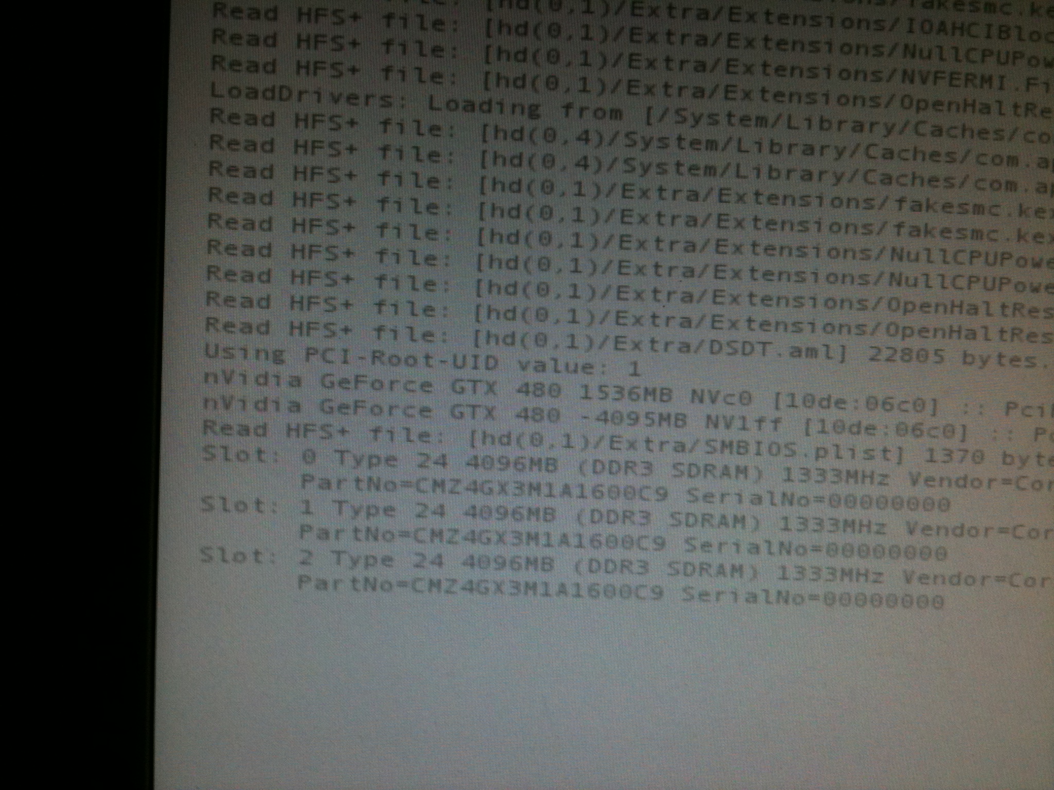

finally i got it running yesterday with both cards. BUT: it seems that my computer only sometimes detects both cards!!!
and i really dont know why!!! let me explain:
i used to start with chameleon rc5 700 and if i boot verbose it does detect my two cards only sometimes! i have to shutdown the system and power it off for about 30sec and try it again. every now and then it detects two cards, but the second card with completely wrong vram (see pic!).
therefore i tried aquamacs gfx-string-method and voila: if the computer detects both cards it is starting osx with both cards!!!
but, why only sometimes?
