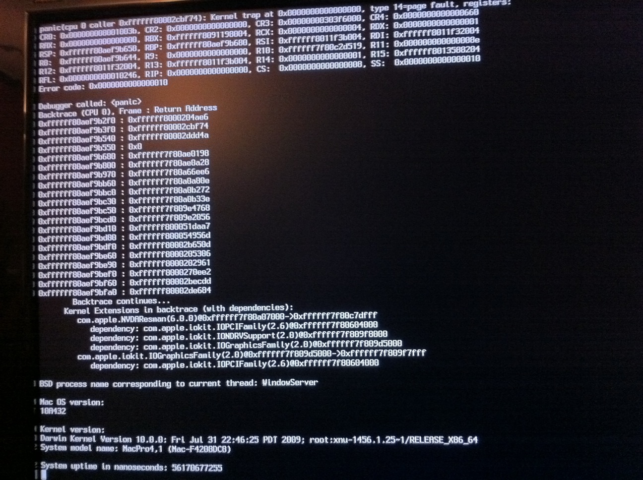

Ho provato a seguire anche questa guida:
"Just finishing installing snow leopard on the rampage ii extreme.
A couple of things before installing.
1. Set bios to ACHI
2. Make sure you connect the HD which you're installing SL on to the 1st sata port
3. You need to have a bootable snow leopard USB. Check out this thread for instructions on how to make one: (http://www.insanelymac.com/forum/index.php?showtopic=208724)
4. Download this BootCD - http://www.mediafire.com/?a0z1mkbreqxjopf
5. Download this AppleHDA.kext - http://www.mediafire.com/?cmuv6kci09h5egq
The BootCD contains the Extra folder, Chameleon2RC5 bootloader, bootcd, kext helper and kext utility
Wanted to say thanks to speedy61 and kups for the files and of course to the rest of people who helped make installing SL so easy these days.
1. Download the BootCD file and burn the .iso to a cd using the slowest speed.
2. Insert the BootCD and plug in the USB. Restart and at bios press F8 to boot up from the CD. Now chose the USB and start booting.
3. Once at the SL installation go to disk utitlies and partition the HD. Remember to click customize and deselect all the printers,etc.
4. When it's finished installing restart and again press F8 to start up with the bootcd. This time chose the HD you just installed to.
5. You should now see the video. Fill out all the information and you're at the desktop!
6. Network should be working so just go to Software Update and install all the updates up to 10.6.6.
7. Once the updates are installed it'll reboot and once again press f8 and boot up from the cd. Chose the HD and when it loads make sure you're running 10.6.6.
8. Open up the BootCD. Install the Chameleon bootloader. restart and boot up using the cd.
9. Copy the Extra folder from the bootcd to the root of your harddrive (Nvidia owners can try the Extra Nvidea folder - just make sure to rename it to extra). Open up kext utility and run it. This will repair permissions and create the mkext package. Once it's finished open up kext helper and drag the AppleHDA.kext file in there. Enter your password and install. Restart once complete. This time boot up directly from the HD. Hopefully you should now have a working 10.6.6 install on the rampage ii extreme complete with the app store."
Ma quando boota il cd e gli do l'USB come installazione carica e spunta il kernel panic che allego.
Soluzione? :thanks_speechbubble:
Sembra sia l'unico a non riuscire ad installare Snow Leopard sulla Rampage II Extreme :thumbsup_anim:
