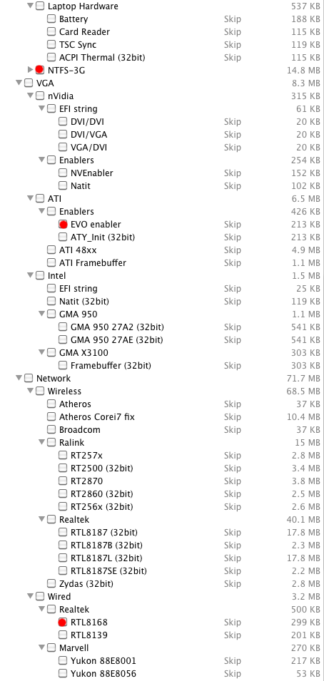

DETAILED INSTALL INSTRUCTIONS
*cd/dvd drive was an ide so i think it does not matter
*good quality dvd (i used verbatim)
*good burning software (ultaiso)
*burn at either 4x or below
*set to ahci
*set boot to dvd drive
*a fat32 partition for mac
put dvd in drive
press f8
type "-f -x -v mach_970 busratio=20 cpus=1" without quotes
you will see a bunch of text with the annoying chameleon in the background
then the font will change and the last line will say "IOAPIC: Version 0x20 vectors 64:87" or something like that
-just press enter and it will continue to boot
when it stops at "Bug: Launchctl. c:2325...systemshutdown false" or something similar just let it wait
-be patient this could take up to 30 minutes to load seeing as it only is using one core
*if it gets stuck for more than 20 minutes just press enter and wait another 20 minutes
*if you press enter and wait 20 mins and it still does not go just eject the disk and check for scratches and finger prints and just get a soft cloth and wipe from the centre to the outside and put it back in carefully and boot again
*if it continues not to boot try to re-download and burn the iso again
when the select language screen shows just press your language and the arow button
wait AND BE PATIENT and it will give the finder bar and a window
on the finder bar click utilities and click disk utility
wait for it to open up and select the fat32 partition
select erase and format it as a MAC OS X Extended (Journaled) partition label it one word without spaces
-(ex. iAktos)
exit disk utilities
press the next button (- - - >)

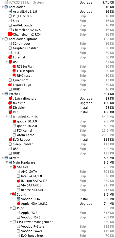

select the disk and press customize
here are the things that you should select
-bootloader
-chameleon v2 rc4
-bootloader options
-ethernet
-legacy logo (this is unnecessary, i just like the legacy logo better than the chameleon one)
-usb (select all the usb fixes)
-patches
-/extra directory
-fakesmc
-disabler
-rtc (64bit if u have more than 2gbs of ram)
-modified kernels
-qoopz 10.3.0
-evo reboot
-drivers
-Main hardware
-sata/ide
-jmicron SATA.IDE
-sound
-apple hda 10.6.2 (this doen't actually make the sound work)
-ntfs -3g (select all)
-VGA
-ATI
-enablers
-evo enabler (this didnt do anything either not even for my 5770)
-network
-wired
-Realtek
-RTL 8168 (this does not make the network work)
and install, this should take a good 20-30 minutes

I attached some pics to clear up the selections (note: ignore the ones selected in blue as this picture is off the internet and select the ones in red) and i tried to use [url="http://www.insanelymac.com/forum/topic/279450-why-insanelymac-does-not-support-tonymacx86/"]#####[/url] 3.7.0 to install the missing or non-functional drivers and here is what i selected (THIS DID NOT WORK!!!)
