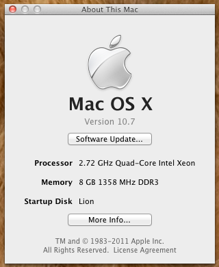

zascok Posted August 1, 2011 Author Share Posted August 1, 2011 Here is a small guide for the Lion (10.7) installation. Lion installation requires several new things: 1. new boot. it was Chameleon 2.0-RC5 (svn-r982) in my case 2. new lines in com.apple.Boot.plist <key>Kernel Flags</key> <string>npci=0x2000</string> 3. Lion PC installation DVD. As you know dp43db has two issues: broadcom network card and LPC. I added LPC and SMBus injectors to Extra folder but it does almost nothing as our mobo does not have LPC. You can easily see it with AIDA64. So not sure if we can solve PCI issue. Broadcom network card issue has been solved recently. Many thx to BCM5722D Here is my Extra folder with corrected dstd, com.apple.Boot.plist and some kexts: AHCIPortInjector.kext AppleHDADisabler.kext fakesmc.kext IOAHCIBlockStorageInjector.kext LPC_injector.kext PlatformUUID.kext SMBusPCI_injector.kext Extra.zip two kexts to S/L/E BCM5722D.kext.zip VoodooHDA.kext.zip here is some screenshots good luck! Quote Link to comment https://www.insanelymac.com/forum/topic/241515-short-guide-retail-snow-leopard-install-on-dp43bf-lga-775-mobo/#findComment-1727287 Share on other sites More sharing options...
