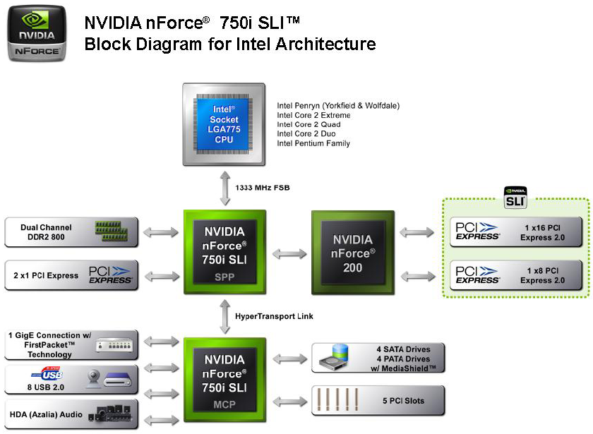

agent999 Posted December 30, 2010 Author Share Posted December 30, 2010 This schematic diagram probably explains the reason for your lockups...... so the PCI and and SATA use a common bus? weather or not that is it, the diagram does make it seem possible. now, how to fix it...I just wish linksys or ralink woudl just release a 10.6 driver already. Quote Link to comment https://www.insanelymac.com/forum/topic/241035-snow-leopard-nforce-750i-install-log/#findComment-1611822 Share on other sites More sharing options...
verdant Posted December 30, 2010 Share Posted December 30, 2010 so the PCI and and SATA use a common bus? weather or not that is it, the diagram does make it seem possible. now, how to fix it...I just wish linksys or ralink woudl just release a 10.6 driver already. Yea, they seem to focus on USB rather than PCI drivers at present for 10.6..... Quote Link to comment https://www.insanelymac.com/forum/topic/241035-snow-leopard-nforce-750i-install-log/#findComment-1611836 Share on other sites More sharing options...
