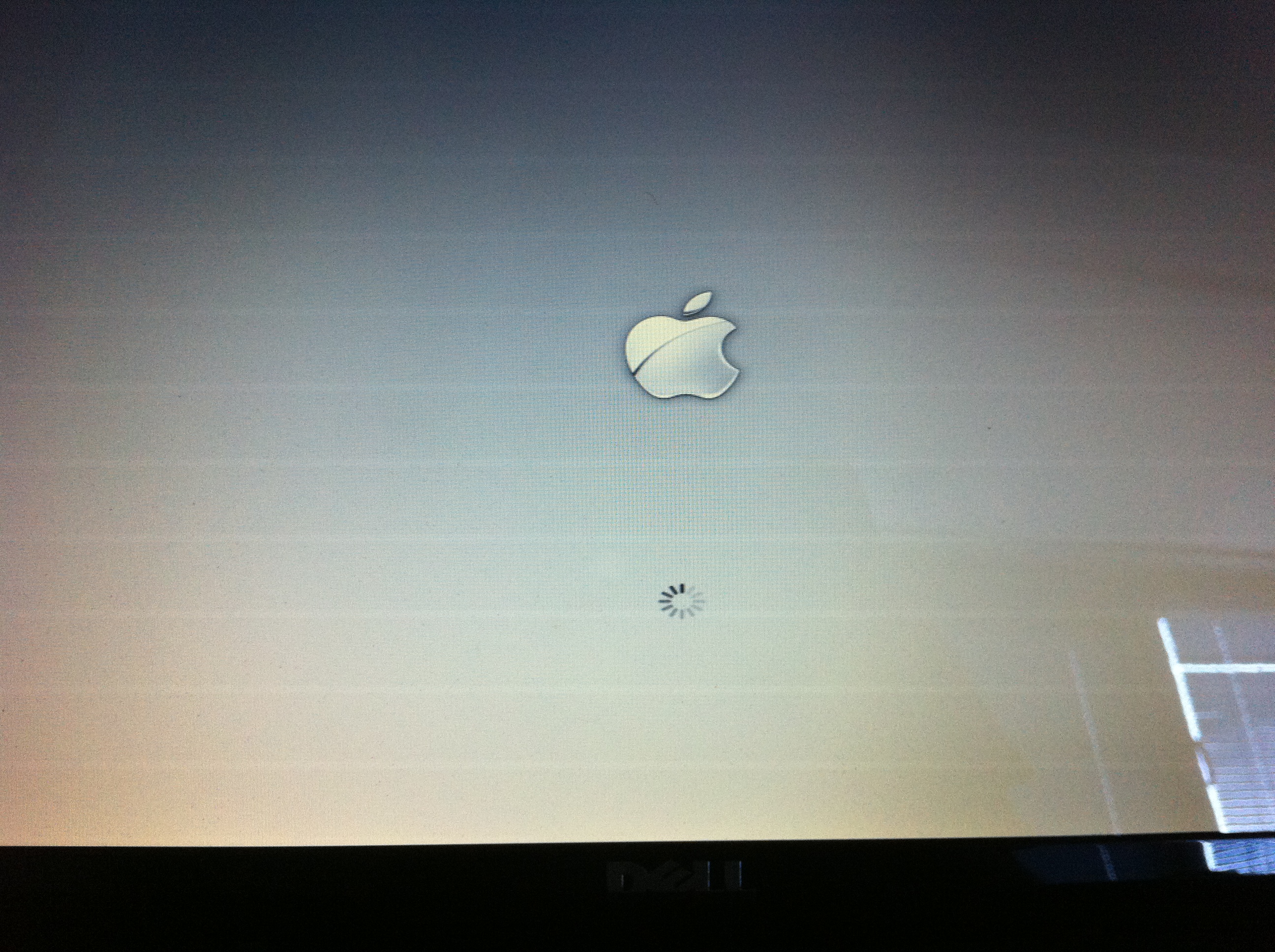

I've got a problem. I tried to install iDeneb 1.6 on my Dell studio 1555 laptop, but after the installation I don't get past the boot screen.
I've had mac osx86 10.5.6 on my laptop, but I had problems with updating (Same problem as after the install of iDeneb 1.6).

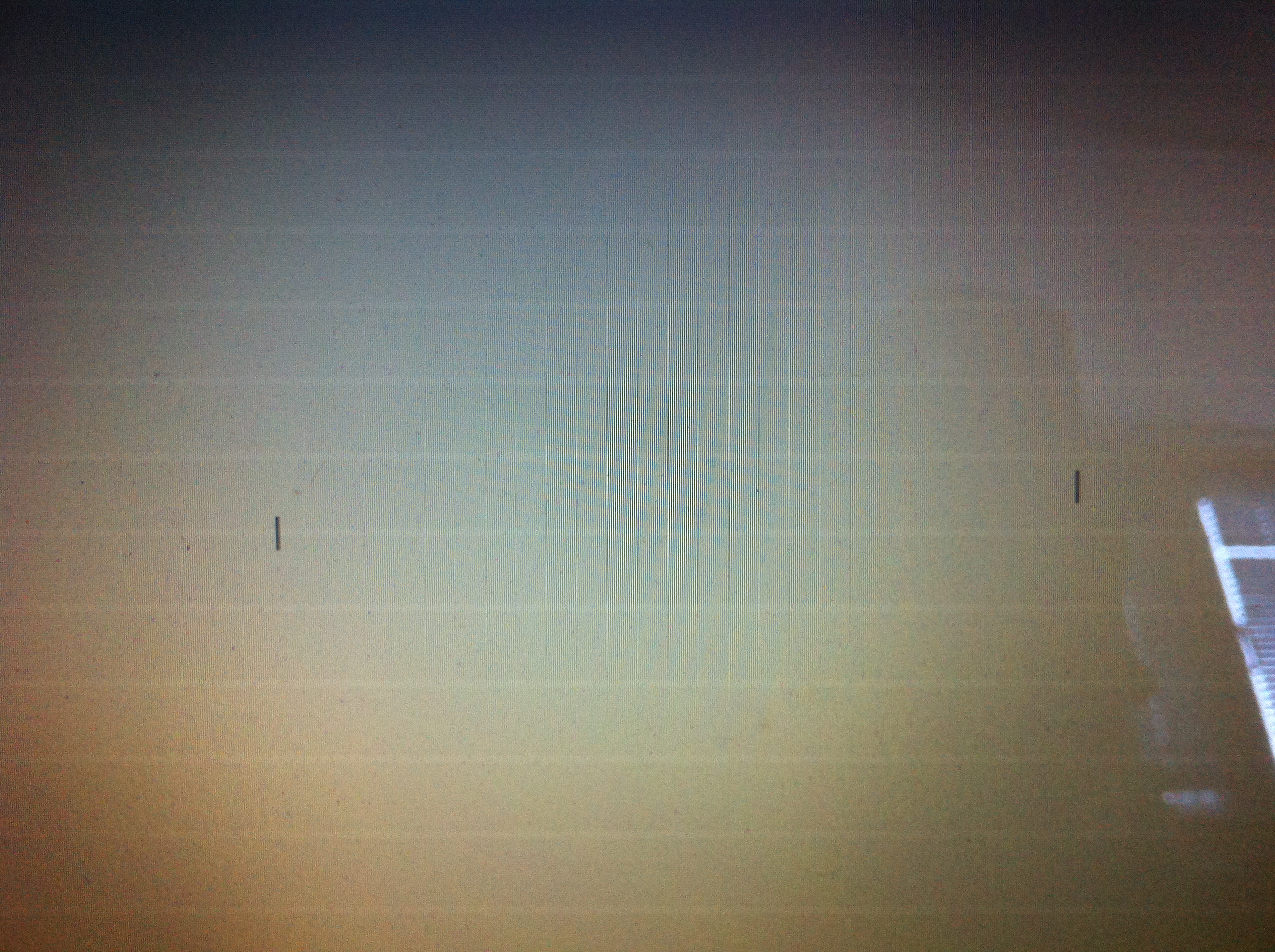

I see the apple logo with the loading sign beneath it. After that, I get a grey screen with little dark stripes, and when I move the mouse, they move along.

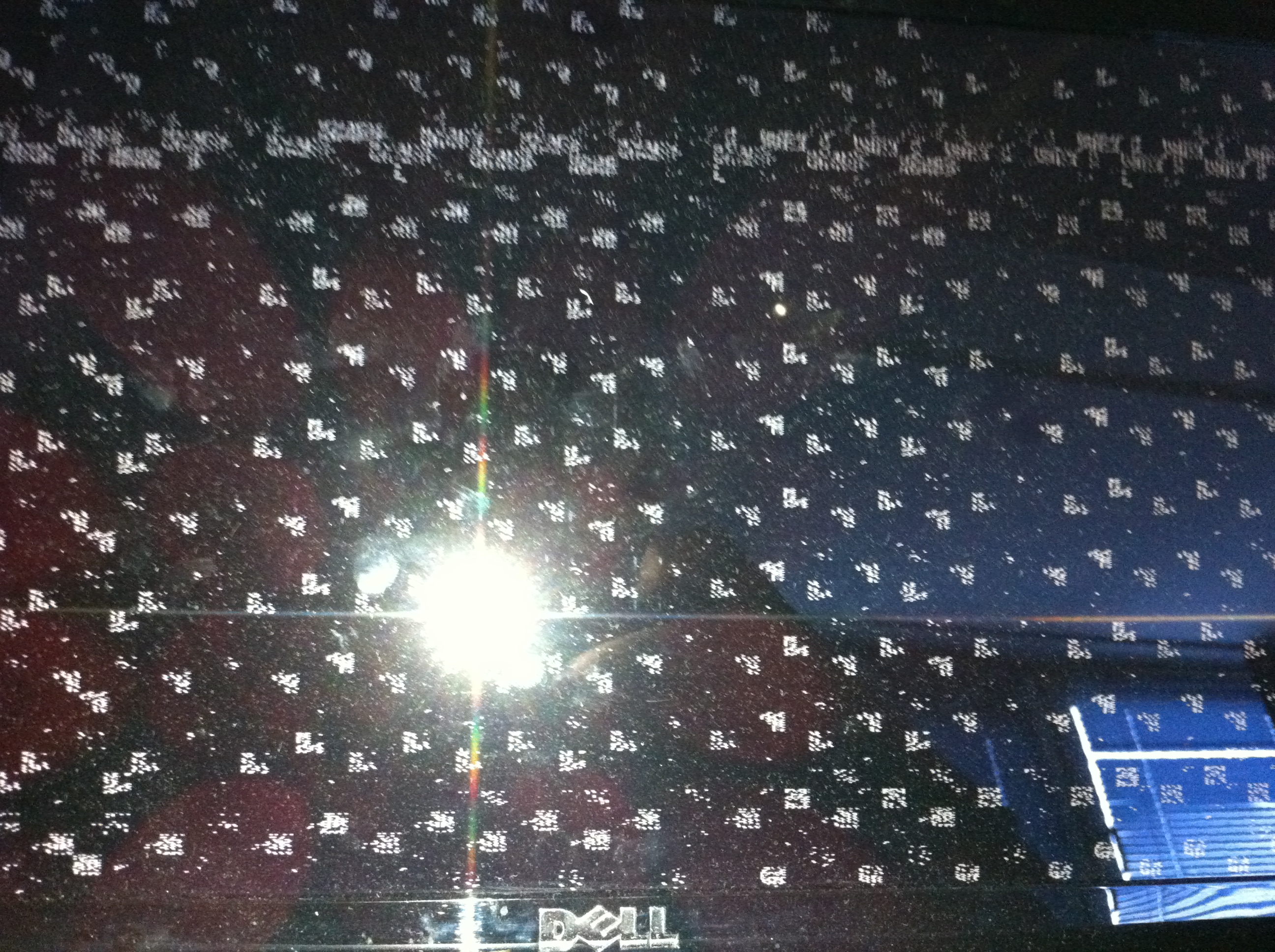

Booting with -v won't show what the problem is cause The screen gets "Snowy".
I tried to install with different kernels, but that won't fix the problem. I added pictures of my screen.
What can I do about this? I looked all over the internet but I didn't know how to describe it.

Hello, this problem is of the kexts for your graphic card try this:
*Boot with -s flag (single user mode) - Borrar un kext desde el modo singler user type:
mount -uw /
rm -rf /System/Library/Extensions/NV*
rm -rf /System/Library/Extensions/ATI*
Good Luck!!!!
