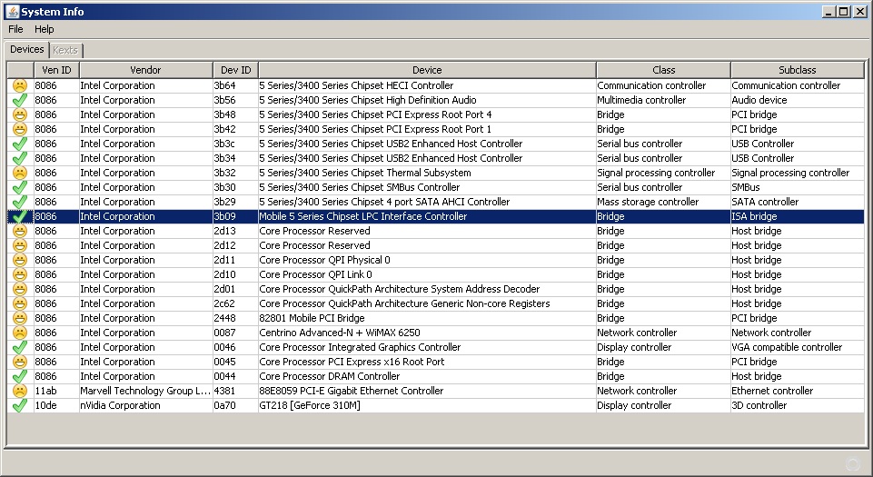

The village idiot Posted December 5, 2010 Share Posted December 5, 2010 There is another post about this laptop but the thread title doesn't really give anyone any reason to read it. I have a new Samsung QX410 which is an Intel i5-460m powered device. I have tried installing 10.6.3 with the iATKOS S3 V2 disk and get a kernel panic before it fully loads the installation environment. I also tried [url="http://www.insanelymac.com/forum/topic/279450-why-insanelymac-does-not-support-tonymacx86/"]#####[/url] and a retail 10.6.3 disk and it also panics and stops before I get to the install environment. I've tried safe mode and single user mode for both methods and the result is always the same. Is there a way to output the verbose messages to a text file so I can let smarter people than me see exactly what the errors are? There are not many adjustments that can be made in the BIOS so it just might be that this computer is not Hackintosh compatible even though the output from the Windows tool suggests that it should mostly work, attached is a screen capture of the hardware ID tool. Quote Link to comment Share on other sites More sharing options...

The village idiot Posted December 8, 2010 Author Share Posted December 8, 2010 Apparently there is also a problem with the Intel/Nvidia hybrid graphics card that will need to be overcome. I'm going to try the Empire EFI bootloader and see if it is a little smarter and will get things working. Quote Link to comment Share on other sites More sharing options...

The village idiot Posted December 9, 2010 Author Share Posted December 9, 2010 Try booting iATKOS S3 V2 disk with -v busratio=18.......if you have problems try -v arch=i386 busratio=18.........or -v cpus=1 arch=i386 busratio=18........or even -v cpus=1 arch=i386 busratio=18 maxmem=2048 That got me a lot closer, after about 15 minutes without the -v it finally went to the gray screen and several minutes later it went to the language selection screen. That's where it stopped, the mouse and touchpad were moving the cursor but I'm not sure if the buttons were clicking on the next button. Enter key didn't seem to do anything, esc nothing, cntrl+alt+del nothing. The Sun (oracle) virtual box does not work with the desktop version of OSX, only server so I'll save others a little time and suggest finding a different VM if that is the way you want to go. Quote Link to comment Share on other sites More sharing options...

The village idiot Posted December 9, 2010 Author Share Posted December 9, 2010 You need to boot with those flags INCLUDING -v and then post any boot screen error messages but also try installing using an external USB keyboard and USB mouse plugged into the laptop......... I'll have to bring a keyboard home and see if that helps, maybe I'll even bring a Mac keyboard home. When I tried -v it just sat there for what seemed to be an eternity without giving me any indication why it stopped. I'll try it again but it never even gave a kernel panic so I wasn't sure what to report back. Would be really nice if we could pipe the output to a file, there should be plenty of room on the 100mb boot partition that Win7 makes. On to the backup issue... You should be able to back up your computer to DVD or DL-DVD with the Samsung partition (F4 during power up), alternately you should be able to do a complete drive image to DVD with Clonezilla, just make sure to defrag the Windows before trying it as Windows no longer frees the space until you defrag it (much like Mac it never throws anything away anymore), if you don't your image will contain all that junk data and will be really huge. Quote Link to comment Share on other sites More sharing options...
Dragom Posted December 10, 2010 Share Posted December 10, 2010 I was able to install using a retail dvd 10.6.3, the nawcom boot cd and busratio=17 kernel flag. NVinject doesn't seem to work so far. NVdarwin loads but with 1024x768 resolution. i'll try to update to 10.6.5. Quote Link to comment Share on other sites More sharing options...

The village idiot Posted December 11, 2010 Author Share Posted December 11, 2010 That mostly worked... Everything installed but said it failed at the end and to reboot and start again. When it rebooted there was nothing it could boot from, so I had to boot off the CD again. Installed the 10.6.5 combo and ran [url="http://www.insanelymac.com/forum/topic/279450-why-insanelymac-does-not-support-tonymacx86/"]#####[/url], still no boot. So I used the disk to boot into "system" to get Windows back into operation. Using diskpart I made Windows active again so it is the default system to boot. Commands are as follows list disk select disk 0 (zero which is only one present) list partition (find the 100MB partition and remember the number) select partition 1 active detail partition and it should say it is now active exit I also ran easyBCD and added a Mac partition to the boot file so that if I get things to work it should be able to boot from the Windows boot selection. Typing this from Windows. i did notice that the nawcom installer mentioned that it was using a different kernel because the 10.6.3 disk I had would not support vanilla on a 10.6.3 because the i5/i3 processor support didn't start until 10.6.4. This makes me think it would work better with a 10.6.4 or 10.6.5 retail disk (if they are available). I'll play with it more this weekend. Thing to note... Initiating the Mac disk wiped out my recovery partition! I would suggest that before starting this everyone uses Clozilla to make a complete disk image to a USB drive! Don't forget to defrag the Windows drive first. I'll be able to get my recovery partition back since I did image the entire drive, but I probably won't bother and will make another one as soon as I get OSX working. Ethernet wired or wireless not working, audio is a little funny, graphics as mentioned only at 1024x768 Quote Link to comment Share on other sites More sharing options...

The village idiot Posted December 11, 2010 Author Share Posted December 11, 2010 I am assuming that you installed the Chameleon bootloader onto the OS X volume on its HDD or USB flash drive and included the busratio=17 or busratio=18 kernel flag in the com.apple.Boot.plist file in /Extra and/or in /L/P/SystemConfiguration........ Not yet, but I will check it immediately. I think Chameleon is loading but didn't know I had to go and edit the plist to put in the busratio statement. Should be easy enough to do. I'm just happy that I got this far, gives me something to work with in trying to get it functional and searching for solutions to things like the missing Nvidia from this hybrid graphics and getting the wireless to work. What does the busratio really do? Is it slowing the bus speed down or just telling the OS that it needs to clock at this speed? Just trying to understand the why parts so that maybe I won't need so much help the next time. Quote Link to comment Share on other sites More sharing options...
verdant Posted December 11, 2010 Share Posted December 11, 2010 Not yet, but I will check it immediately. I think Chameleon is loading but didn't know I had to go and edit the plist to put in the busratio statement. Should be easy enough to do. I'm just happy that I got this far, gives me something to work with in trying to get it functional and searching for solutions to things like the missing Nvidia from this hybrid graphics and getting the wireless to work. What does the busratio really do? Is it slowing the bus speed down or just telling the OS that it needs to clock at this speed? Just trying to understand the why parts so that maybe I won't need so much help the next time. The busratio is equivalent to the Bus/Core Ratio, which is the ratio of your CPU’s highest frequency to the FSB i.e. front-side bus frequency.......and since CPU frequency = FSB x Multiplier, the Bus/Core Ratio is equal to the Multiplier...... But note that Intel used a quad-pumped FSB on pre-iSeries Core CPUs, i.e. from Pentium 4 up to their Core2 Quad CPUs......thus, a Q6600 with an effective FSB of 1332 MHz, in fact has a true FSB of 1332/4 = 333 MHz and hence a CPU frequency of 2997 MHz give a multiplier of 9....... The multiplier only affects your CPU frequency for a given FSB frequency, whereas the higher your FSB, the higher your system performance because the FSB links the CPU to the GFX card bus and RAM bus via the Northbridge chipset.......so, having an unlocked multiplier allows you to increase system performance by reducing the multiplier and increasing the FSB frequency yet keeping the same CPU frequency...... and running with a FSB/RAM frequency ratio of 1:1 is recommended for stability....... Quote Link to comment Share on other sites More sharing options...
