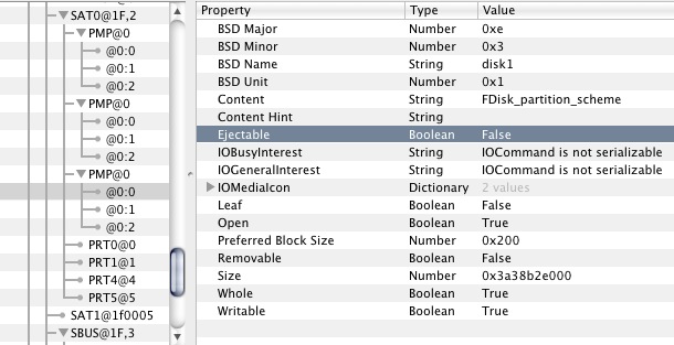

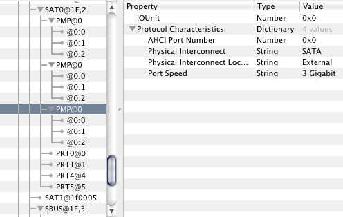

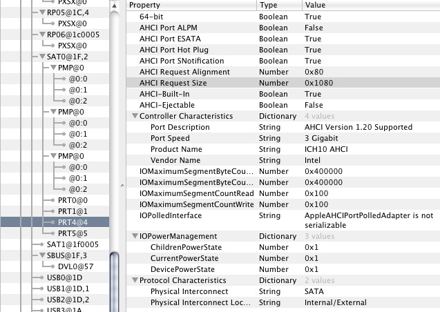

IOREGExp:
It looks good: External port (all others are Internal).
Then why not ejectable?
PRT4@4 in IOREGExp.

IOREG:
| |   |   +-o PRT4@4  <class AppleAHCIPort, id 0x1000001e9, registered, matched, active, busy 0 (690 ms), retain 9>
| |   |   | |   "AHCI Port SNotification" = Yes
| |   |   | |   "Controller Characteristics" = {"Port Description"="AHCI Version 1.20 Supported","Product Name"=
"ICH10 AHCI","Vendor Name"="Intel","Port Speed"="3 Gigabit"}
| |   |   | |   "AHCI Port Hot Plug" = Yes
| |   |   | |   "IOMaximumSegmentCountWrite" = 0x100
| |   |   | |   "AHCI Request Alignment" = 0x80
| |   |   | |   "IOPowerManagement" = {"CurrentPowerState"=0x1,"DevicePowerState"=0x1,"ChildrenPowerState"=0x1}
| |   |   | |   "IOMaximumSegmentByteCountWrite" = 0x400000
| |   |   | |   "IOMaximumSegmentByteCountRead" = 0x400000
| |   |   | |   "IOPolledInterface" = "AppleAHCIPortPolledAdapter is not serializable"
| |   |   | |   "AHCI-Ejectable" = No
| |   |   | |   "Protocol Characteristics" = {"Physical Interconnect"="SATA","Physical Interconnect Location"="Internal/External"}
| |   |   | |   "64-bit" = Yes
| |   |   | |   "AHCI-Built-In" = Yes
| |   |   | |   "IOMaximumSegmentCountRead" = 0x100
| |   |   | |   "AHCI Port ESATA" = Yes
| |   |   | |   "AHCI Port ALPM" = No
| |   |   | |   "AHCI Request Size" = 0x1080
| |   |   | +-o IOAHCIDevice@0  <class IOAHCIDevice, id 0x1000001f5, registered, matched, active, busy 0 (690 ms), retain 11>
| |   |   |   |   "IOUnit" = 0x0
| |   |   |   |   "Protocol Characteristics" = {"Physical Interconnect"="SATA","AHCI Port Number"=0x0,
"Port Speed"="3 Gigabit","Physical Interconnect Location"="External"}

| |   |   |		   |   "Removable" = No
| |   |   |		   |   "Content" = "FDisk_partition_scheme"
| |   |   |		   |   "Whole" = Yes
| |   |   |		   |   "Leaf" = No
| |   |   |		   |   "BSD Name" = "disk1"
| |   |   |		   |   "Ejectable" = No
