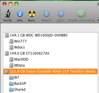

3.14r2 Posted November 6, 2010 Share Posted November 6, 2010 ...do you know anything about these types of controllers?Nope...There how it looks like then my RAID is detected by OS X. The RAID is used for Windows backups. Contains 3 partitions... It is sad that it is not supported by the manufacturer (in OS X). Quote Link to comment https://www.insanelymac.com/forum/topic/236325-dual-booting-problems-please-help/#findComment-1577408 Share on other sites More sharing options...
