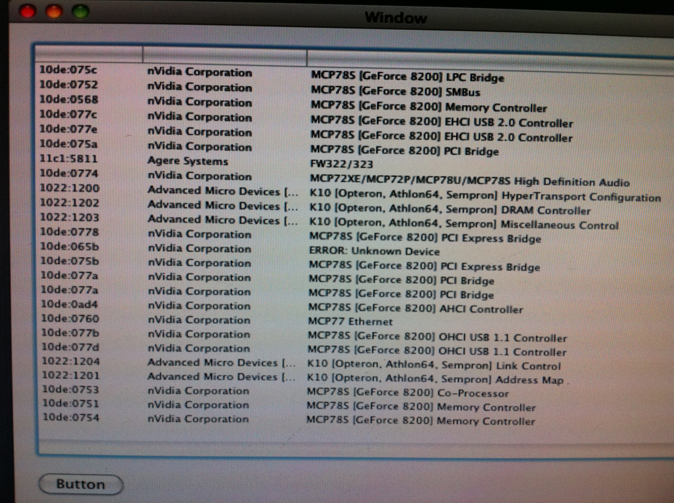

Ok I am very new to this so take it easy on me I am trying to install Snow leopard
I have gone into the BIOS and changed a the setting to AHCI and can boot into the iatkos s3 v2 amd DVD im not sure what drivers etc I need to select in the customise buttons
Any help would be great
Here is a picture of hardware info
Here are my specs
Here are my specs

Your nForce chipset MCP77 is probably fully AHCI compliant and so you should not select AppleNForceATA.kext but try the Intel SATA/IDE option.......also see my iATKOS S£ v2 install guide in my blog.........
