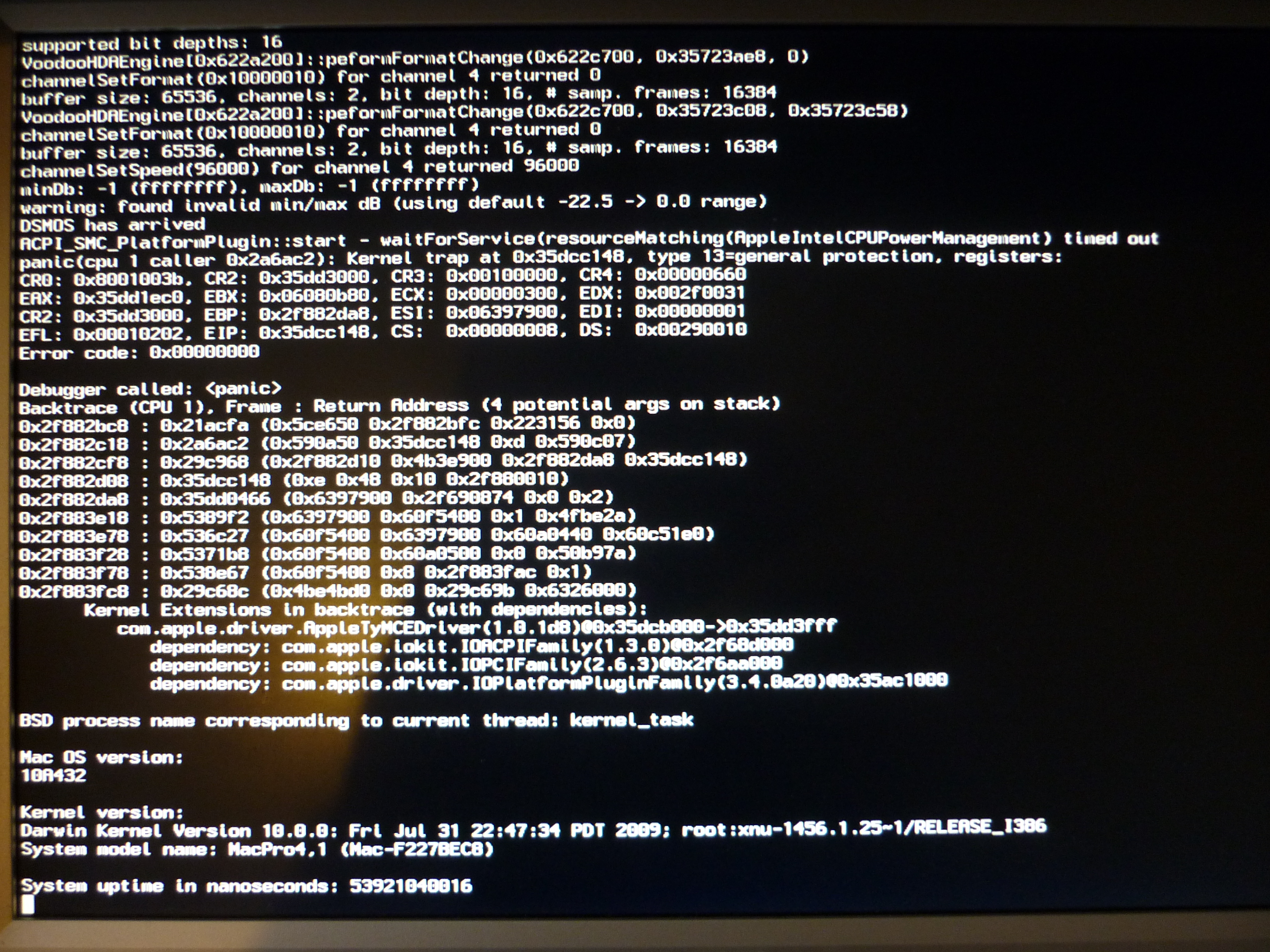

slavo234 Posted October 19, 2010 Share Posted October 19, 2010 1. I have downloaded [intel/AMD] Snow Leopard 10.6.1 - 10.6.2 SSE2-SSE3 by Hazard. 2. Installed without Graphics/Sound/Network drivers. (But i using PcEFI Loader) 3. Well, i try to launch it and see kernel panic (look at the picture) My system: Intel Core 2 Duo e4500 2.22 GHz. ASUS P5LD-X motherboard. 2Gb DDR3 RAM. Asus GeForce EN9600GT 1GB. Any Help, please! Bump Bump Quote Link to comment https://www.insanelymac.com/forum/topic/234749-i-need-help-with-snow-leopard/ Share on other sites More sharing options...
Giorgio_multi Posted October 19, 2010 Share Posted October 19, 2010 You must remove AppleTyMCEDriver.kext from /System/Library/Extensions Quote Link to comment https://www.insanelymac.com/forum/topic/234749-i-need-help-with-snow-leopard/#findComment-1566723 Share on other sites More sharing options...
slavo234 Posted October 19, 2010 Author Share Posted October 19, 2010 Giorgio_multi, BIG THANKS! It's Really Works. You are the best! Quote Link to comment https://www.insanelymac.com/forum/topic/234749-i-need-help-with-snow-leopard/#findComment-1566743 Share on other sites More sharing options...
