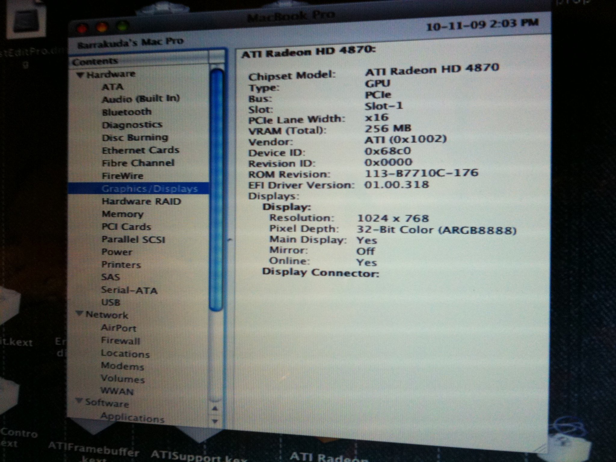

ID_Tech Posted November 10, 2010 Author Share Posted November 10, 2010 UPDATE -- UPDATE -- UPDATE 1. After playing around with various kexts, I've found-out that EVOEnabler.kext makes our graphics card recognizable as ATI Mobility Radeon 4870. Resolution at 1024x768. Display connector: <nothing> (image is at the end of this post) 2. The above and the fact that I'm unable to take a "screen-shot" of my screen with anyting, neither I can play video-files, tells me that my MAC does not recognize th connection type between graphics card and the motherboard. Which in turn points us in th direction of modified DSDT, but now for the connector, as well. 3. I have extracted my ACPI-tables and subsequently DSDT from them, but have yet to decompile it. However, I've found an ASUS N61Jq DSDT on Megaupload (file attached to this post - replace .txt in filename with .bz2 and run in OS X). If someone wants to take a stab at it. Of course, there is not proof that this DSDT is actually the same as we have. I'll keep working on decompiling mine. Good luck! dsdt_asus_n61jq.tar.txt Quote Link to comment Share on other sites More sharing options...
