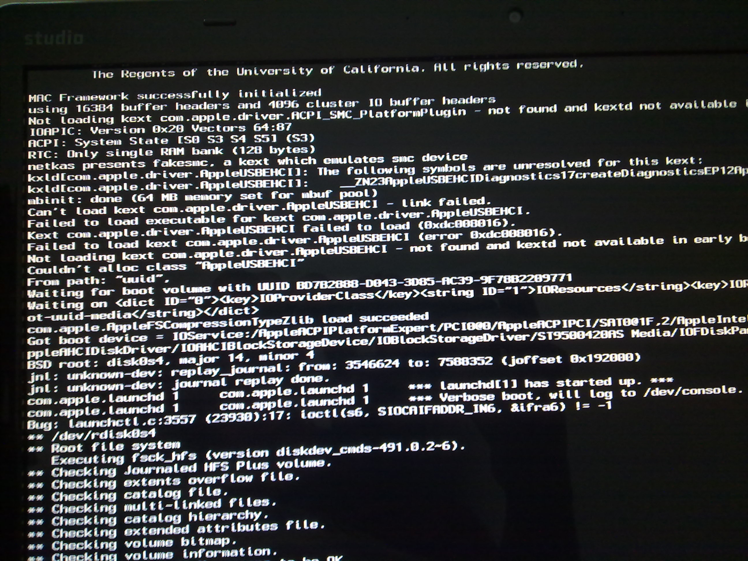

akii_d24 Posted October 12, 2010 Author Share Posted October 12, 2010 okay so i have managed to install Mac on my pc using iATKOS s3 v2. i used the flag -v busratio=13 to get rid of the restart problem. This flag is for an i7 740 QM. the installation worked fine and was successful. But now i have a problem. When i restarted after successful installation and booted into mac i was asked to connect my keyboard. I connected a usb keyboard but still it was the same. Probably there is a problem in my USB ports and i think they arent working or getting sufficient power in mac. I tried connecting my USB optical mouse too but it too didnt work. Also its not recognizing my touchpad which it did during the installation. So plz help... I am so close yet so far.. Quote Link to comment https://www.insanelymac.com/forum/topic/233896-problems-with-installation-of-os-x-on-dell-studio-1458-core-i7-173-ghz/#findComment-1563263 Share on other sites More sharing options...
akii_d24 Posted October 12, 2010 Author Share Posted October 12, 2010 By the way my USB ports are working just fine in windows. Here is the pic of my mac loading screen. Quote Link to comment https://www.insanelymac.com/forum/topic/233896-problems-with-installation-of-os-x-on-dell-studio-1458-core-i7-173-ghz/#findComment-1563272 Share on other sites More sharing options...
cfriedt Posted December 16, 2010 Share Posted December 16, 2010 Hi, I have the same device - dell studio 1458 with an intel core i7 (720 QM actually). Installation works fine with iatkos v7 using busratio=12. There's an extensive list of working busratios for core i5 and i7 processors in [1]. Originally, upon reboot I had major issues and could only get into the system via the DVD using "mach_kernel rd=disk0s2 -cpus=8 busratio=12". I read the 'readme' a bit further and found out that the proper kernel to use from the iATKOSv7 DVD was actually mach_970 for core i5 and core i7 processors. After copying mach_970 to my osx86 partition as /mach_kernel, it all went fairly smoothly, until I tried to boot from GRUB2. After a bit more googling, I'm now able to boot into OS X from GRUB using the method suggested in [2]. I still don't have sound working Any leads for the Realtek HDA (ACL 655) ? The drivers for the intel centrino advanced-n 6250 are non-existent for OS X. Multimedia keys only partially work. The cardreader and USB might be functional by using the optional kexts from the iATKOSv7 DVD, but I haven't tried yet. The broadcom gigabit ethernet (BCM57780) is working thanks to [3]. Also, I haven't gotten the ATI Radeon 5470 graphics to work with full hardware acceleration, but I'm still hopeful. They recently published their specs and some open-source drivers if I'm not mistaken, so that should make things slightly easier, although I'm pretty sure that the ATI chips should have stock Apple drivers in SL for the iMac. It would be nice to have gestures fully supported for the capacitive synaptics touchpad as well (Voodoo?). This is actually a great machine to use for osx86 since it's fairly compatible with a lot of stock Apple hardware specs (e.g. iMac) and the quad-core processor puts Apple's own laptop offerings to shame. If anyone else in this thread has some spare time and more success, it would be great to see a sticky list of working kexts. [1] http://3rr0rists.net/macintosh/busratio-fo...processors.html [2] http://maketecheasier.com/create-a-mac-ent...rub2/2010/02/12 [3] http://www.gizmolabs.org/~ecronin/w/Main/OSXSetMac Quote Link to comment https://www.insanelymac.com/forum/topic/233896-problems-with-installation-of-os-x-on-dell-studio-1458-core-i7-173-ghz/#findComment-1603188 Share on other sites More sharing options...

cfriedt Posted January 21, 2011 Share Posted January 21, 2011 how would i instal the kext witrhout my mouse? All you need to do is boot from your installation medium, and then copy the kext into /S/L/E or /E/E. You can copy the files using the terminal application with the install DVD. Upon your next boot, make sure to instruct the bootloader to rescan all kexts, with the -f option, or possible both -f and -x. C Quote Link to comment https://www.insanelymac.com/forum/topic/233896-problems-with-installation-of-os-x-on-dell-studio-1458-core-i7-173-ghz/#findComment-1626965 Share on other sites More sharing options...
