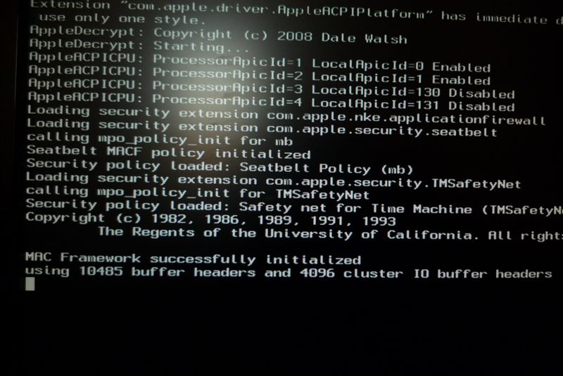

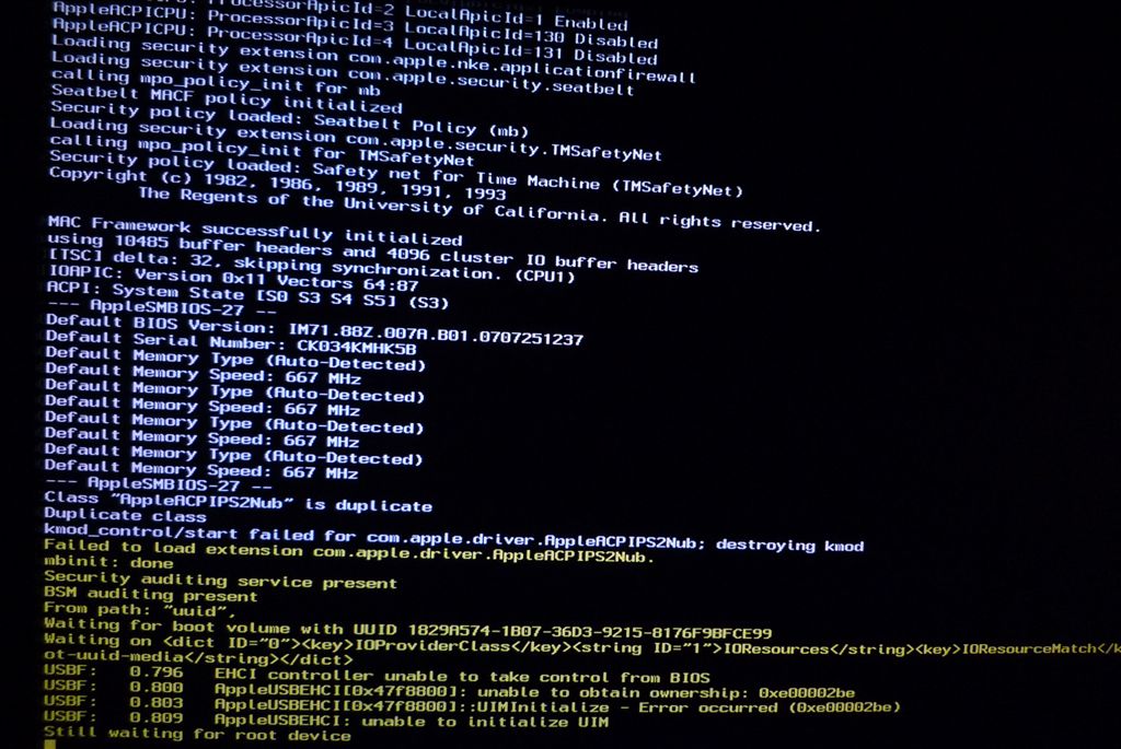

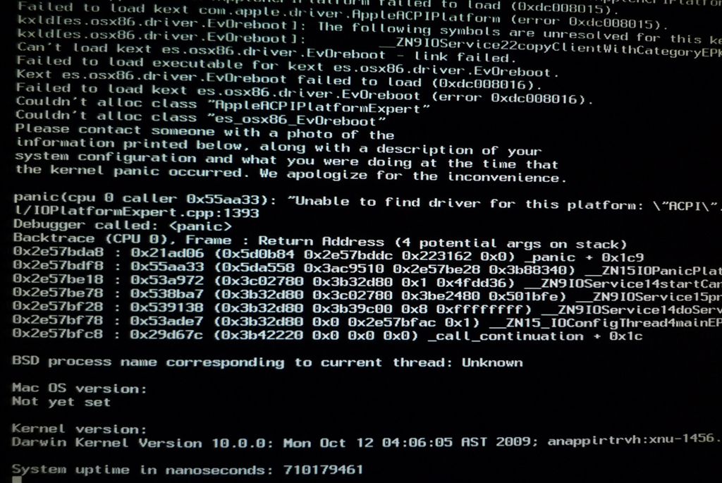

cofik Posted September 25, 2010 Author Share Posted September 25, 2010 The dsdt.dsl file is there as a backup if any further patching is required. You only need the DSDT.aml file........ I would try iPC 10.5.6 and Kalyway 10.5.2 first........ done ,but........ when use installed on hdd chameleon v1 stops in the same point mac framework................ using 10485 buffer headers and 4096 cluster io buffers headers but when use chameleon v2 from cd it's look's like this Quote Link to comment https://www.insanelymac.com/forum/topic/232661-help-with-install/#findComment-1554363 Share on other sites More sharing options...
cofik Posted September 25, 2010 Author Share Posted September 25, 2010 done ,but........when use installed on hdd chameleon v1 stops in the same point mac framework................ using 10485 buffer headers and 4096 cluster io buffers headers but when use chameleon v2 from cd it's look's like this and now i have to install Iatkos and i think i'm closer to see macos on my pc now i see something like this i think now i should to do something with my dvd rom or hdd but what? i have dvd on ide 1 and dvd on sata 1 hdd ide Quote Link to comment https://www.insanelymac.com/forum/topic/232661-help-with-install/#findComment-1554401 Share on other sites More sharing options...

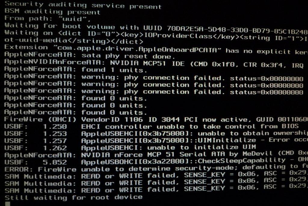

cofik Posted September 25, 2010 Author Share Posted September 25, 2010 next step i have installed ide/sata and now ......... i ithink it is very close to see macos but now i can't see an extra catalog in my mac disk so this is without dsdt patched file verdant what do you think? is any hope for run macos on my hardware? Quote Link to comment https://www.insanelymac.com/forum/topic/232661-help-with-install/#findComment-1554420 Share on other sites More sharing options...
verdant Posted September 26, 2010 Share Posted September 26, 2010 next step i have installed ide/sata and now ......... i ithink it is very close to see macos but now i can't see an extra catalog in my mac disk so this is without dsdt patched file verdant what do you think? is any hope for run macos on my hardware? Have you installed iPC 10.5.6......? If so, also install ACPI Fix and lOPCIFamily.kext patched from the Installer Customise menu....... Quote Link to comment https://www.insanelymac.com/forum/topic/232661-help-with-install/#findComment-1554455 Share on other sites More sharing options...

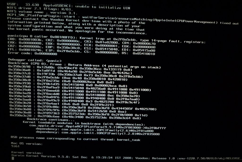

cofik Posted September 26, 2010 Author Share Posted September 26, 2010 Have you installed iPC 10.5.6......? If so, also install ACPI Fix and lOPCIFamily.kext patched from the Installer Customise menu....... no i use Iatkos v7 IPC and Ideneb always stops on mac framework............ only Iatkos goes on see photo from my previous post so... i'll tray Kalyway ......but afternoon Quote Link to comment https://www.insanelymac.com/forum/topic/232661-help-with-install/#findComment-1554537 Share on other sites More sharing options...
cofik Posted September 26, 2010 Author Share Posted September 26, 2010 no i use Iatkos v7 IPC and Ideneb always stops on mac framework............ only Iatkos goes on see photo from my previous post so... i'll tray Kalyway ......but afternoon Wow And the Oscar goes..............to iATKOS v7 10,5,6 BUT WITHOUT VOODO 9,5,0 KERNEL so... no modyfication in BIOS ide DVD ROM no dsdt patch just clean iatkos with sata ide fix ps/2 fix disabler apple decrypt Quote Link to comment https://www.insanelymac.com/forum/topic/232661-help-with-install/#findComment-1554768 Share on other sites More sharing options...

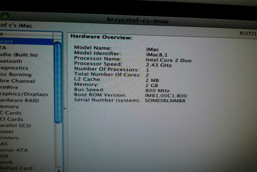

verdant Posted September 26, 2010 Share Posted September 26, 2010 Wow And the Oscar goes..............to iATKOS v7 10,5,6 BUT WITHOUT VOODO 9,5,0 KERNEL so... no modyfication in BIOS ide DVD ROM no dsdt patch just clean iatkos with sata ide fix ps/2 fix disabler apple decrypt Glad you got Leopard 10.5.6 running with the vanilla kernel? Quote Link to comment https://www.insanelymac.com/forum/topic/232661-help-with-install/#findComment-1554817 Share on other sites More sharing options...

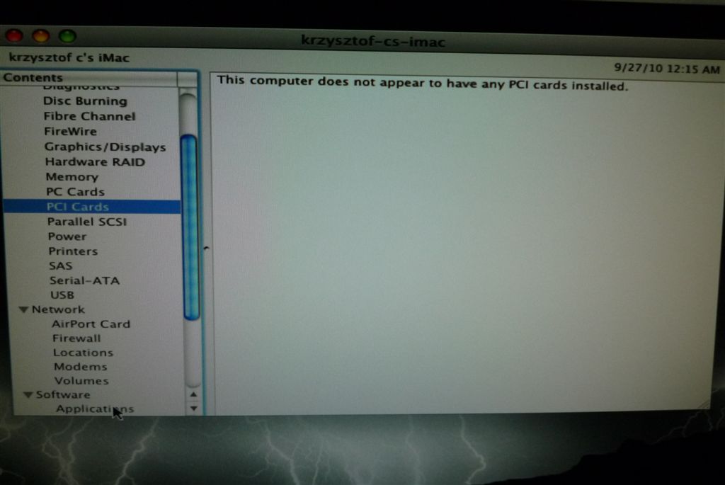

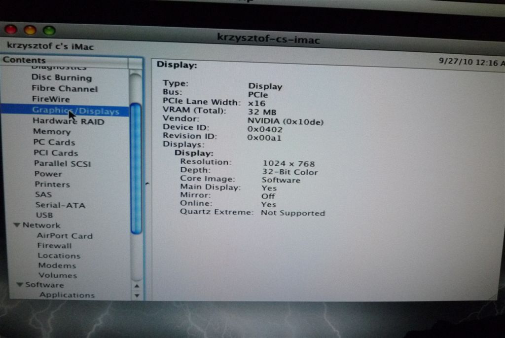

cofik Posted September 26, 2010 Author Share Posted September 26, 2010 Glad you got Leopard 10.5.6 running with the vanilla kernel? if vanilla is included in IATKOS ?-----------yes but i still have few problems 1.No internet connection i have wifi ralink rt2561 2. vga i can choose only 1024*768---i have gf8600 3.shutdown problem please look at photos and help fix it Quote Link to comment https://www.insanelymac.com/forum/topic/232661-help-with-install/#findComment-1554886 Share on other sites More sharing options...
verdant Posted September 27, 2010 Share Posted September 27, 2010 if vanilla is included in IATKOS ?-----------yes but i still have few problems 1.No internet connection i have wifi ralink rt2561 2. vga i can choose only 1024*768---i have gf8600 3.shutdown problem please look at photos and help fix it For GeForce 8600GT, install Chameleon RC3, RC4 or Rc5 and use GraphicsEnabler For internet Ethernet connection, use eno's nForceLAN.kext Quote Link to comment https://www.insanelymac.com/forum/topic/232661-help-with-install/#findComment-1555230 Share on other sites More sharing options...
cofik Posted September 27, 2010 Author Share Posted September 27, 2010 But i have wifi ralink on pci This is not onboard ethernet card when i use chameleon rc4 i can't run macos Quote Link to comment https://www.insanelymac.com/forum/topic/232661-help-with-install/#findComment-1555251 Share on other sites More sharing options...
