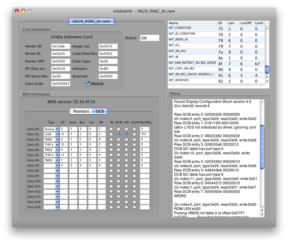

matrix4you Posted September 7, 2010 Share Posted September 7, 2010 Hello, on my Fujitsu Lifebook E780 with NVIDIA GF GT 330M i have a black screen after install drivers, enablers or injectors. An external Monitor works with OpenGL / QE. Tested Systems are iAtkos S3 and iPortable (10.6.4)! Extracted DSDT with NVIDIA Laptop hack does not work! I have add the hack into the PEGP block but no changes! I think the dsdt.aml does not use / ignore the hack! Is it possible to change the NVCAP like by the Sony Vaio in this Post: The VGA-BioS PE /*have i read out and the NVCAP value with NVCAP Maker generated: 0400000000000100000000000000000700000000 The ATY_Init.kext with the NVCAP key does not work! Any Ideas? Thanks much for answers! dsdt.zip Quote Link to comment https://www.insanelymac.com/forum/topic/231268-fujitsu-lifebook-e780-nvidia-gf-gt-330m-black-screen/ Share on other sites More sharing options...

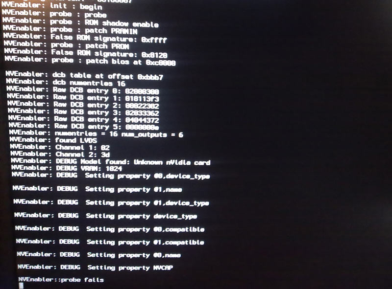

matrix4you Posted September 8, 2010 Author Share Posted September 8, 2010 If it helps! NVEnabler puts out: NVEnabler: found LVDS NVEnabler: Channel 1: 02 NVEnabler: Channel 2: 3d I used this Values in the NVCAP. But always the same. External monitor goes, not internal! Quote Link to comment https://www.insanelymac.com/forum/topic/231268-fujitsu-lifebook-e780-nvidia-gf-gt-330m-black-screen/#findComment-1544857 Share on other sites More sharing options...
matrix4you Posted September 13, 2010 Author Share Posted September 13, 2010 I now sometimes seen with nVidia Info. The LVDS is put at 2, it means that the "Output Group 1" yes on 02 steehgen must / should: Interesting that so many entries are there, right? The rom of the video card and the EDID I once attached! Still have hope! I also have a plist with at. With the settings remain the LCD / DFP also black. The external is then blue! Is there any way that I get with the default drivers (GraphicsEnabler = No) at least the resolution of 1600x900. Would then dispense it without external monitor on QE! In the Graphics Mode boot.plist I have set to 1600x900x32. The highest what I get is 1280x800, before it was 1024x768! just everything is very weird because MacBooks have the card in there, too! files.zip Quote Link to comment https://www.insanelymac.com/forum/topic/231268-fujitsu-lifebook-e780-nvidia-gf-gt-330m-black-screen/#findComment-1547376 Share on other sites More sharing options...
