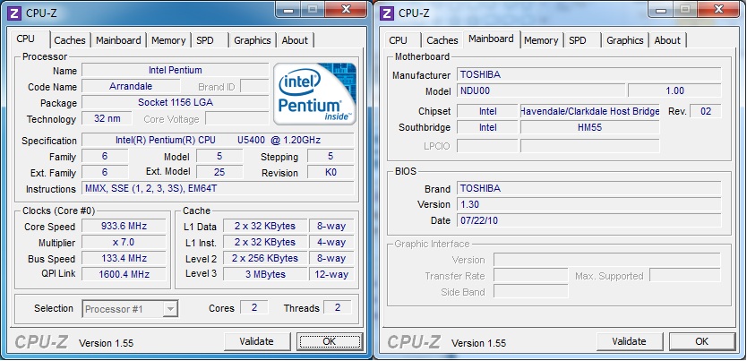

MAXniper Posted August 31, 2010 Share Posted August 31, 2010 This is the description of my new notebook: Processor type : Intel® Pentium® processor U5400 clock speed : 1.20 GHz Front Side Bus : 800 MHz 3rd level cache : 3 MB System memory standard : 4,096 (2,048 + 2,048) MB maximum expandability : 8,192 MB technology : DDR3 RAM (800 MHz) Hard disk capacity : 320 GB drive rotation : 5,400 rpm Display size : 29.5cm (11.6”) type : Toshiba TruBrite® HD TFT High Brightness display with 16 : 9 aspect ratio and LED backlighting internal resolution : 1,366 x 768 Graphics adapter manufacturer : Intel® type : Intel® Graphics Media Accelerator HD memory amount : up to 1,696 MB shared memory with 4 GB system memory installed, (with pre-installed 64-bit operating system) integrated VGA Web Camera with built-in microphone 1 (Left) x eSATA/USB 2.0 2 (Right 2) x USB 2.0 1 x HDMI supporting 1080p signal format 1 x Multi-Card Reader (supports SD™ Card up to 2 GB, miniSD™/microSD™ Card with adapter up to 2 GB, SDHC™ Card up to 32 GB, SDXC™ Card up to 64 GB, Memory Stick® up to 256 MB, Memory Stick Pro™ up to 16 GB, MultiMedia Card™ up to 2 GB and xD-Picture Card™ up to 2 GB) Wireless communication Compliancy : Wi-Fi® Network Support : 802.11b/g/n Wireless Technology : Wireless LAN Wired communication topology : Fast Ethernet LAN speed : 10BASE-T/100BASE-TX Sound system supported audio format : 24-bit stereo speakers : built-in stereo speaker manufacturer : Toshiba Bass Enhanced Sound System Keyboard Keys : 86 Windows® keys : Yes Pointing device type : Touch Pad with Multi-Touch Control supporting two-finger scroll, pinch, flip and rotate. After install the iAtkos S3v2 the mouse is really slow and sometimes don't move, what can i do for that? i have readed a lot of Topics and installed many mouse drivers but is hollways the same, if some one can help me? on the pictures are my score on CPU-Z Quote Link to comment https://www.insanelymac.com/forum/topic/230613-iatkos-s3v2-on-notebook-toshiba-satellite-t210-10z-help-please/ Share on other sites More sharing options...

verdant Posted August 31, 2010 Share Posted August 31, 2010 This is the description of my new notebook: Processor type : Intel® Pentium® processor U5400 clock speed : 1.20 GHz Front Side Bus : 800 MHz 3rd level cache : 3 MB System memory standard : 4,096 (2,048 + 2,048) MB maximum expandability : 8,192 MB technology : DDR3 RAM (800 MHz) Hard disk capacity : 320 GB drive rotation : 5,400 rpm Display size : 29.5cm (11.6”) type : Toshiba TruBrite® HD TFT High Brightness display with 16 : 9 aspect ratio and LED backlighting internal resolution : 1,366 x 768 Graphics adapter manufacturer : Intel® type : Intel® Graphics Media Accelerator HD memory amount : up to 1,696 MB shared memory with 4 GB system memory installed, (with pre-installed 64-bit operating system) integrated VGA Web Camera with built-in microphone 1 (Left) x eSATA/USB 2.0 2 (Right 2) x USB 2.0 1 x HDMI supporting 1080p signal format 1 x Multi-Card Reader (supports SD™ Card up to 2 GB, miniSD™/microSD™ Card with adapter up to 2 GB, SDHC™ Card up to 32 GB, SDXC™ Card up to 64 GB, Memory Stick® up to 256 MB, Memory Stick Pro™ up to 16 GB, MultiMedia Card™ up to 2 GB and xD-Picture Card™ up to 2 GB) Wireless communication Compliancy : Wi-Fi® Network Support : 802.11b/g/n Wireless Technology : Wireless LAN Wired communication topology : Fast Ethernet LAN speed : 10BASE-T/100BASE-TX Sound system supported audio format : 24-bit stereo speakers : built-in stereo speaker manufacturer : Toshiba Bass Enhanced Sound System Keyboard Keys : 86 Windows® keys : Yes Pointing device type : Touch Pad with Multi-Touch Control supporting two-finger scroll, pinch, flip and rotate. After install the iAtkos S3v2 the mouse is really slow and sometimes don't move, what can i do for that? i have readed a lot of Topics and installed many mouse drivers but is hollways the same, if some one can help me? on the pictures are my score on CPU-Z Your trackpad and keyboard are both PS/2, whereas I am guessing that your mouse is USB........... OS X expects to see a USB keyboard and USB mouse...........PS/2 is not naturally supported by OS X........so the PS/2 kexts are hacked kexts..........either all PS/2, or better, all USB combos are better than a mixed PS/2 and USB combo........ Quote Link to comment https://www.insanelymac.com/forum/topic/230613-iatkos-s3v2-on-notebook-toshiba-satellite-t210-10z-help-please/#findComment-1540634 Share on other sites More sharing options...
