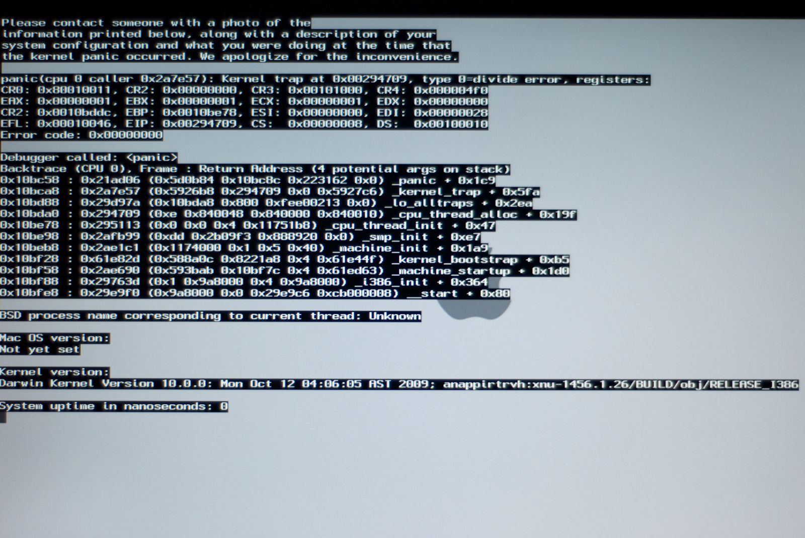

ing3 Posted August 28, 2010 Share Posted August 28, 2010 I posted my problem on the tonymacx86 forum as well, but no replies yet. I ran [url="http://www.insanelymac.com/forum/topic/279450-why-insanelymac-does-not-support-tonymacx86/"]#####[/url]-ATI and installed Snow Leopard, but when I restarted after running the update and [url="http://www.insanelymac.com/forum/topic/279450-why-insanelymac-does-not-support-tonymacx86/"]#####[/url], it wouldn't boot, even when done through [url="http://www.insanelymac.com/forum/topic/279450-why-insanelymac-does-not-support-tonymacx86/"]#####[/url]. I'm going to try re-installing everything, but now when I try to boot the SL disc through [url="http://www.insanelymac.com/forum/topic/279450-why-insanelymac-does-not-support-tonymacx86/"]#####[/url], all I get is this screen. Same thing when I try to boot in safe mode. I've tried using only one stick of RAM and alternating between the two I have, I've tried the [url="http://www.insanelymac.com/forum/topic/279450-why-insanelymac-does-not-support-tonymacx86/"]#####[/url] (Supported) disc, even a different hard drive. Here's my hardware: Intel i7-860 Asus P7P55 LX ATI Sapphire Radeon HD 4850 4GB Kingston RAM Quote Link to comment https://www.insanelymac.com/forum/topic/230323-cant-install-using-iboot-a-second-time/ Share on other sites More sharing options...
ing3 Posted August 28, 2010 Author Share Posted August 28, 2010 Nvm. I figured out what was wrong. I had to disable the Max CPUID Value Limiter in the BIOS. I must've changed that while rebooting. If anyone else is having a similar problem, double-check that setting. I posted my problem on the tonymacx86 forum as well, but no replies yet. I ran [url="http://www.insanelymac.com/forum/topic/279450-why-insanelymac-does-not-support-tonymacx86/"]#####[/url]-ATI and installed Snow Leopard, but when I restarted after running the update and [url="http://www.insanelymac.com/forum/topic/279450-why-insanelymac-does-not-support-tonymacx86/"]#####[/url], it wouldn't boot, even when done through [url="http://www.insanelymac.com/forum/topic/279450-why-insanelymac-does-not-support-tonymacx86/"]#####[/url]. I'm going to try re-installing everything, but now when I try to boot the SL disc through [url="http://www.insanelymac.com/forum/topic/279450-why-insanelymac-does-not-support-tonymacx86/"]#####[/url], all I get is this screen. Same thing when I try to boot in safe mode. I've tried using only one stick of RAM and alternating between the two I have, I've tried the [url="http://www.insanelymac.com/forum/topic/279450-why-insanelymac-does-not-support-tonymacx86/"]#####[/url] (Supported) disc, even a different hard drive. Here's my hardware: Intel i7-860 Asus P7P55 LX ATI Sapphire Radeon HD 4850 4GB Kingston RAM Quote Link to comment https://www.insanelymac.com/forum/topic/230323-cant-install-using-iboot-a-second-time/#findComment-1538740 Share on other sites More sharing options...
