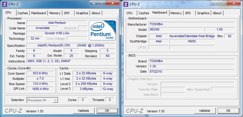

verdant Posted August 23, 2010 Share Posted August 23, 2010 @mmm11105 and @verdant, sory to post here but i can't start a new topic and i see that @mmm11105 has allmost the same problem as mine. i have a toshiba t210 with the description below that i had in CPU-Z, i've tested allmost every options to install but i can't getted running on my pc. is it possible to help me?? i have iAtkos S3 V2 Sory again for this Assuming you are using iATKOS S3 Version 2 Snow Leopard 10.6.3 Install DVD md5 of iATKOS_S3_version2.iso >>> 55d3aaae14435065b53acb61e3bccae2 Boot from the iATKOS S3 Version 2 Snow Leopard 10.6.3 Install DVD, and when you see the option to do so, press F8 to go to the Chameleon Boot Icon menu, then type –v busratio=20 and you will see boot: –v busratio=20 appear in the bottom left corner of the screen, now with the iATKOS S3 version 2 boot icon framed, press Enter to start the OS X Installer 1. I recommend that you set up two equal size OS X volumes, and in the first you attempt the following installation In the Installer Customise menu, initially select only the options shown in BOLD here: > iATKOS S3 Main System [Pre-selected Default] > Bootloader >> AsereBLN v1.19 [Default] >> PC_EFI v10.6 >> Slice >> AnVAL Loader >> Chameleon v2 RC5 >> Chameleon v2 RC4 > Bootloader Options >> 32-bit boot >> Graphics Enabler >> -pci1 >> Ethernet >> USB (USBBusFix; EHCIacquire; UHCIreset) >> Quiet Boot >> Legacy Logo >> UUID [selecting this breaks HDD multiboot options] > Patches >> /Extra directory [Default] >> fakesmc [Default] V2.5 [MUST BE SELECTED] >> Disabler [Default] >> RTC (RTC [Default]; RTC(32bit)) >> Modified Kernels (qoopz 10.3.0; qoopz 10.2.0; PCJ kernel; Atom Kernel) >> EVO Reboot [Default] >> Sleep Enabler >> USB >> UUID > Drivers >> Main Hardware >>> SATA/IDE (AHCI SATA; Intel SATA/IDE; JMicron SATA/IDE; VIA SATA/IDE (support for VIA, SiS, SI, ULI, Marvell and some nForce chipsets); > nForce SATA/IDE) >>> Sound (Voodoo HDA [Default]; Apple HDA 10.6.2 [Default]) >>> PS/2 (Apple PS/2; Voodoo PS/2) >>> CPU Power Management (Voodoo P-State; Voodoo Power; EvO Speedstep) >>> Laptop Hardware (Battery; Card Reader; TSC Sync; ACPI Thermal (32bit) >>> NTFS-3G (Mac FUSE Core; NTFS-3G [automatic sub-selection]) >> VGA >>> nVidia >>>> EFI String (DVI/DVI; DVI/VGA; VGA/DVI) >>>> Enablers (NVEnabler; Natit) >>> ATI >>>> Enablers (EVO enabler; ATY-Init (32bit) >>>> ATI 48xx >>>> ATI Framebuffer >>> Intel >>>> EFI String >>>> Natit (32bit) >>>> GMA 950 (GMA 950 27A2 (32bit); GMA 950 27AE (32bit)) >>>> GMA X3100 (Framebuffer (32bit) >> Network >>> Wireless >>>> Atheros >>>> Atheros Corei7 fix >>>> Broadcom >>>> Ralink (RT257x; RT2500 (32bit); RT2870; RT2860 (32bit); RT256x (32bit)) >>>> Realtek (RTL8187 (32bit); RTL8187B (32bit); RTL8187L (32bit); RTL8187SE (32bit)) >>>> Zydas (32bit) >>> Wired >>>> Realtek (RTL8168; RTL8139) >>>> Marvell (Yukon 88E8001; Yukon 88E8056) >>>> Atheros (Attansic L1; Attansic L1E; Attansic L2 (32bit) >>>> Intel (Intel Pro V100; Intel Gigabit) >>>> Broadcom (BCM440x; BCM5755M (32bit); BCM5787M (32bit)) >>>> nForce >>>> Via Rhine (32bit) > Language Translations - Your choice If the above gets a basic bootable OS X system installed, then clone it to the 2nd volume using Disk Utility or Carbon Copy Cloner..........then boot from the 2nd volume and play around with it as regards: Networking (Ethernet and Wifi) Audio Video CPU Power Management (Voodoo P-State; Voodoo Power; EvO Speedstep) Laptop Hardware (Battery; Card Reader; TSC Sync; ACPI Thermal (32bit) then, even if you make the wrong choices, you can always just boot into the first volume to fix the second volume..... So how would I boot up the OS X installer, I can't even pick kexts yet Have you set up your BIOS for OS X...........if not, follow the 630i setting template in my Pre-Series 7 nForce chipset + Intel CPU MOBO thread post #1 here.......... Link to comment https://www.insanelymac.com/forum/topic/229791-iatkos-s3-installer-will-not-boot/#findComment-1535640 Share on other sites More sharing options...
MAXniper Posted August 23, 2010 Share Posted August 23, 2010 Xii realy thanks @verdant i will play with it and as soon as i get it running i tell you Link to comment https://www.insanelymac.com/forum/topic/229791-iatkos-s3-installer-will-not-boot/#findComment-1535647 Share on other sites More sharing options...

MAXniper Posted August 25, 2010 Share Posted August 25, 2010 Hi Verdant, Now i have installed the OS like you said but not the options on 32-bit only the ones for 64-bit (my CPU is 64-bit). At each startup i need to type ( -v busratio=20 ) other way it doesn't start, what can i do for that? for the drivers i will try to find for the WIFI and ethernet, but a stange thing is that the mouse and trackpad sometimes or almost all it doesn't move or is realy slow, what can i do for that showld i try to install drivers to? Link to comment https://www.insanelymac.com/forum/topic/229791-iatkos-s3-installer-will-not-boot/#findComment-1536682 Share on other sites More sharing options...
verdant Posted August 25, 2010 Share Posted August 25, 2010 Hi Verdant, Now i have installed the OS like you said but not the options on 32-bit only the ones for 64-bit (my CPU is 64-bit). At each startup i need to type ( -v busratio=20 ) other way it doesn't start, what can i do for that? for the drivers i will try to find for the WIFI and ethernet, but a stange thing is that the mouse and trackpad sometimes or almost all it doesn't move or is realy slow, what can i do for that showld i try to install drivers to? You can put -v busratio=20 in com.apple.Boot.plist and so no longer have to type it in......... But also try busratio=9 as your Intel U5400 CPU is a reduced i5-540UM CPU..........see here, You can try VoodooPS/2 vs ApplePS/2 drivers......... As for 64bit versus 32bit on OS X: # Snow Leopard is completely backwards-compatible with 32-bit applications # Snow Leopard runs 64-bit applications regardless of whether it boots into a 64-bit or a 32-bit kernel # Boots by default into 32bit on all Macs except Xserve; this is because all other Macs are using the 32/64-bit hybrid kernel by default because their hardware doesn’t support more than 32 GiB of memory, whereas the Xserve is capable of using up to 48 GiB of memory. # Only a CPU with SSSE3 can run 64-bit kernel and 64bit applications So, with < 32BG RAM, running the purely 64bit kernel is not a necessity, nor always greatly advantageous.........by this I mean, that you may need kexts that are currently only 32bit but which operate better on your system than the 64bit kexts you are using....... Link to comment https://www.insanelymac.com/forum/topic/229791-iatkos-s3-installer-will-not-boot/#findComment-1536709 Share on other sites More sharing options...
MAXniper Posted August 25, 2010 Share Posted August 25, 2010 You can put -v busratio=20 in com.apple.Boot.plist and so no longer have to type it in......... But also try busratio=9 as your Intel U5400 CPU is a reduced i5-540UM CPU..........see here, You can try VoodooPS/2 vs ApplePS/2 drivers......... As for 64bit versus 32bit on OS X: # Snow Leopard is completely backwards-compatible with 32-bit applications # Snow Leopard runs 64-bit applications regardless of whether it boots into a 64-bit or a 32-bit kernel # Boots by default into 32bit on all Macs except Xserve; this is because all other Macs using the 32/64-bit hybrid kernel by default because their hardware doesn’t support more than 32 GiB of memory, whereas the Xserve is capable of using up to 48 GiB of memory. # Only a CPU with SSSE3 can run 64-bit kernel and 64bit applications So, with < 32BG RAM, running the purely 64bit kernel is not a necessity, nor always greatly advantageous.........by this I mean, that you may need kexts that are currently only 32bit but which operate better on your system than the 64bit kexts you are using....... Thanks, you are the best, i will install again Link to comment https://www.insanelymac.com/forum/topic/229791-iatkos-s3-installer-will-not-boot/#findComment-1536712 Share on other sites More sharing options...
