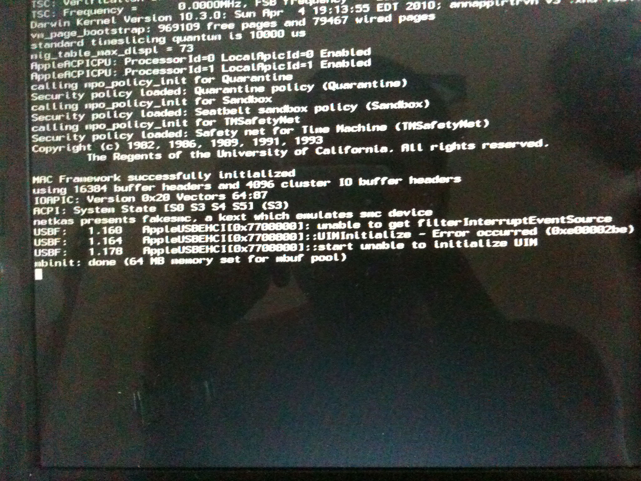

gokugogeta Posted August 23, 2010 Author Share Posted August 23, 2010 mi da questo errore al boot Link to comment https://www.insanelymac.com/forum/topic/229766-aiuto-installazione-iatkos-acer-aspire-5738g/#findComment-1535429 Share on other sites More sharing options...

David23 Posted August 27, 2010 Share Posted August 27, 2010 mi da questo errore al boot Disabilita l'usb. Dopo dovrebbe andare. Link to comment https://www.insanelymac.com/forum/topic/229766-aiuto-installazione-iatkos-acer-aspire-5738g/#findComment-1538086 Share on other sites More sharing options...
gokugogeta Posted August 27, 2010 Author Share Posted August 27, 2010 dal bios non posso non c'e la disattivazione dell'usb legacy, Link to comment https://www.insanelymac.com/forum/topic/229766-aiuto-installazione-iatkos-acer-aspire-5738g/#findComment-1538155 Share on other sites More sharing options...

davidiust Posted November 9, 2010 Share Posted November 9, 2010 anche a me dava lo stesso problema. al boot usa l'opzione USBBusFix=Yes Link to comment https://www.insanelymac.com/forum/topic/229766-aiuto-installazione-iatkos-acer-aspire-5738g/#findComment-1579463 Share on other sites More sharing options...
