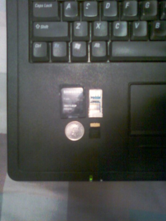

I have created various forms of medium such as SD and MicroSD, to create Expiermental Diskless systems that do not require a typical Hard Drive Installed.

Obviously one can simply say, just install OSX on the local HDD... which is true, however, what I am expiermenting with is the concept of a universal plug in chip.
I have it down to the size of a dime, and it works.

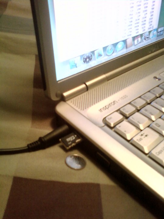

The only Differenence that I did was to use the USB port and a Card Reader plus a chip big enough to hold what needed to run..
Its Self Contained and Bootable. The chip can be Boiled in a Kettle, Frozen in a IceCube Tray in the freezer. Run over by a car... it still Works, and has all data intact... I do not think that you can Burn one with a lighter, the Plastic will melt, and thus be destroyed... however it does appear to be very weather proof and somwhat resistant to physical abuse.

The nifty thing on the Inspiron 1525 was that it also had a internal card reader, however it did not have a boot option to Specific Boot from Internal SD... so what I had ended up doing was making something a little different. Resulting in a Diskless Celeron.
Anyways this has gone on for some time, and no problems really to say at this time... it works..
Sound, Video, Wifi, Internal Lan, DVD Playback is flawless.
Anyways Please see the attached Photos,
