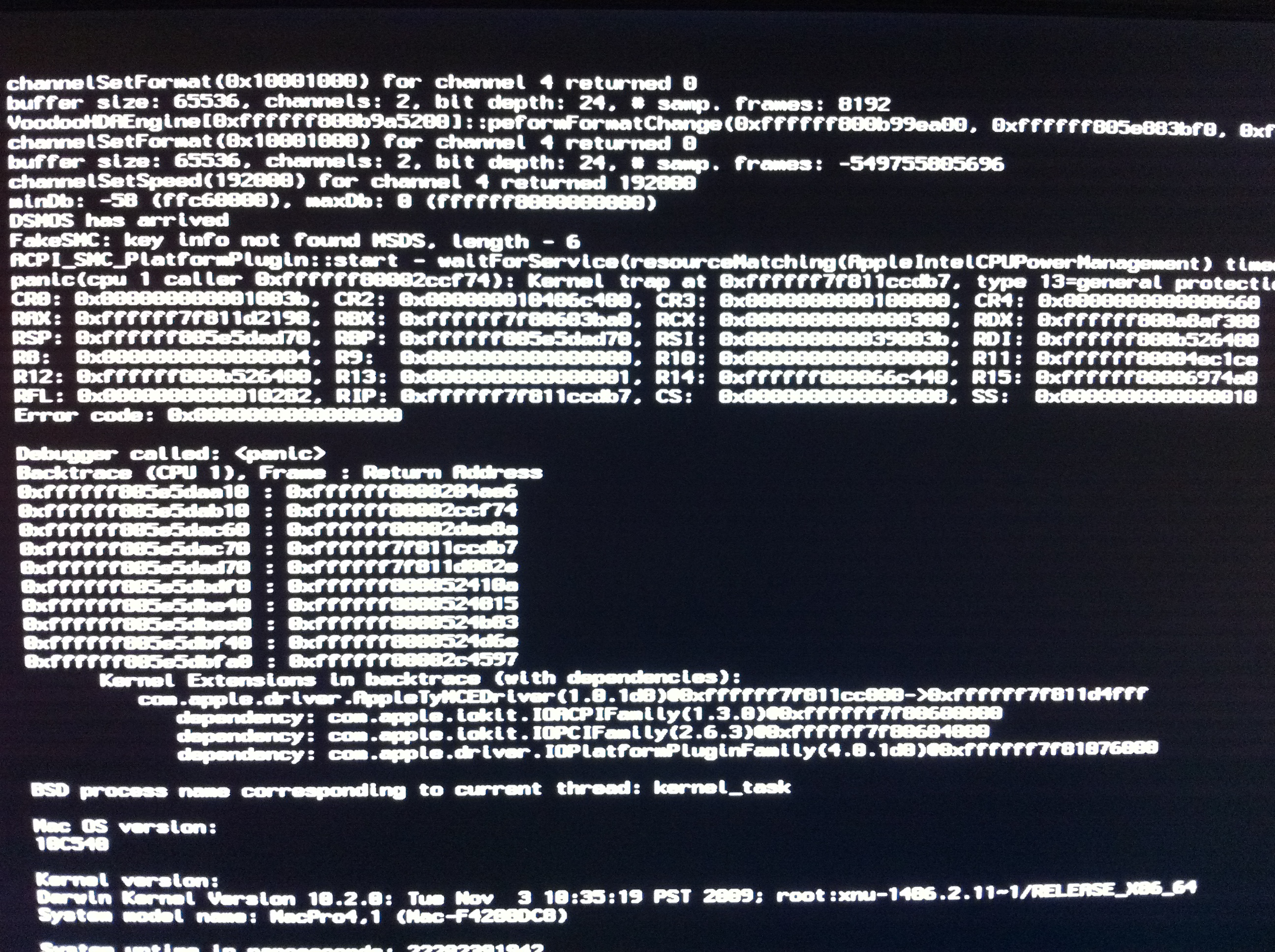

Feynman61 Posted August 9, 2010 Author Share Posted August 9, 2010 Sorry for the fuzzy quality, taken from my iphone. Quote Link to comment Share on other sites More sharing options...
riws Posted August 9, 2010 Share Posted August 9, 2010 Boot again the Hazard DVD, start the Terminal and delete /System/Library/Extensions/AppleTyMCEDriver.kext Quote Link to comment Share on other sites More sharing options...

Feynman61 Posted August 10, 2010 Author Share Posted August 10, 2010 So I tried deleting it from the terminal using two different commands. sudo kextunload /System/Library/Extensions/AppleTyMCEDriver.kext which said I needed permission, but will not let me type my password for some reason. I even tried typing it else where and copy and paste but nothing. I then tried rm -rf /System/Library/Extensions/AppleTyMCEDriver.kext which sent a lot of lines across the terminal window and ended saying permission denied. Is there something in OSX86Tools I can use? I guess it came with the SL install. The hardware I am searching for is the LAN and audio. I believe my LAN is marvell yukon 88e8056 and my audio is a sound card labeled Supreme FX X-Fi it came with my maximus formula II mobo. Thanks. Joe EDIT: That pesky kext is gone and I am able to boot directly into SL! Quote Link to comment Share on other sites More sharing options...
