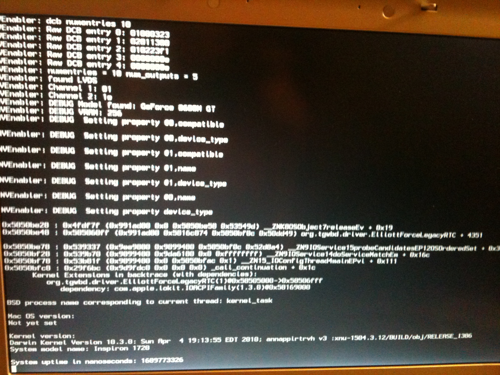

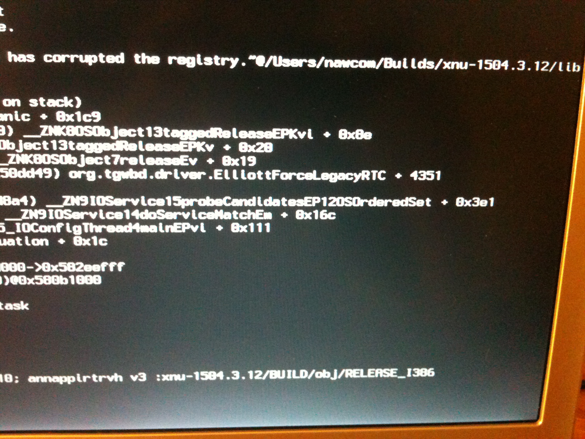

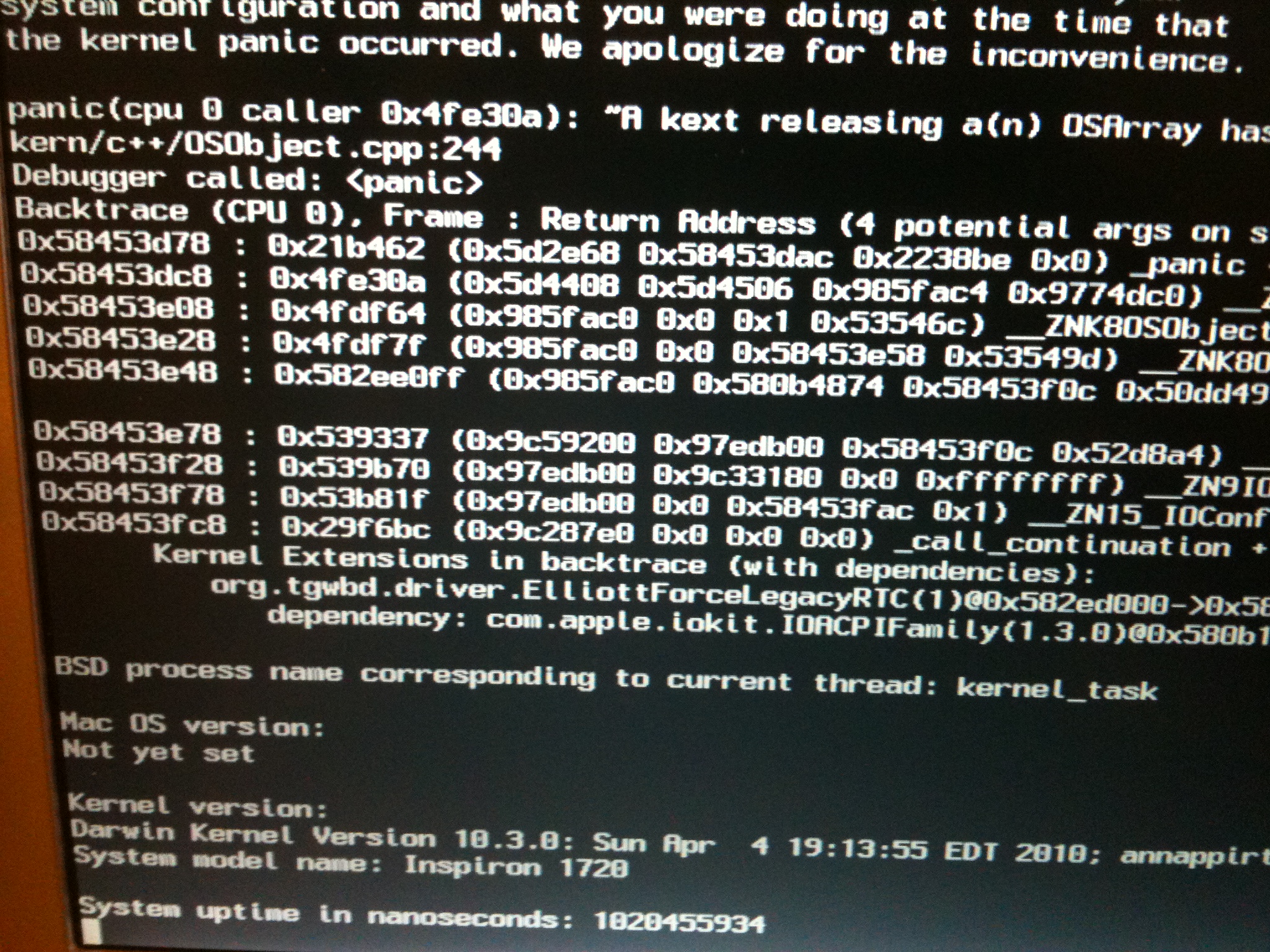

LetThereBeDwight Posted August 8, 2010 Share Posted August 8, 2010 I am completely new to attempting to make a hackintosh, so I apologize in advance if anything I say is silly. I am attempting to install iatkos s3 V2 on my dell inspiron 1720 with the following: intel core 2 duo T7300 2.00 Dell Wireless 1390 Broadcom 440x 10/100 integrated controller GeForce 8600m GT When I boot my iatkos image(from a flash drive) using a lot of different options I get the Kernel Panic in the images below. Any help? Quote Link to comment https://www.insanelymac.com/forum/topic/227885-kp-attempting-to-boot-iatkos-s3-v2/ Share on other sites More sharing options...
riws Posted August 8, 2010 Share Posted August 8, 2010 Tried with different Kernel to boot? Quote Link to comment https://www.insanelymac.com/forum/topic/227885-kp-attempting-to-boot-iatkos-s3-v2/#findComment-1526975 Share on other sites More sharing options...
Mohamed Khairy Posted August 8, 2010 Share Posted August 8, 2010 i have read this before this problem is from RTC kext so i dont know how to disable it from loading in iatkos try this flags -x or -v -f if the same problem try to set up retial in my guide first way i hope it work for you Quote Link to comment https://www.insanelymac.com/forum/topic/227885-kp-attempting-to-boot-iatkos-s3-v2/#findComment-1526976 Share on other sites More sharing options...

LetThereBeDwight Posted August 8, 2010 Author Share Posted August 8, 2010 ok try anther kernel by this flags /mach_pcj -v if not work use this /mach_qoopz -v if not work you will need to setup retail I tried both those flags and the same panic came up =[ I have however noticed that right before the panic, in verbose mode it says something to the effect of "no smbios replacement found". Could that have something to do with it? Quote Link to comment https://www.insanelymac.com/forum/topic/227885-kp-attempting-to-boot-iatkos-s3-v2/#findComment-1527057 Share on other sites More sharing options...

riws Posted August 9, 2010 Share Posted August 9, 2010 If you still have the iATKOS image, you could delete the ElliottForceLegacyRTC.kext from the image. Quote Link to comment https://www.insanelymac.com/forum/topic/227885-kp-attempting-to-boot-iatkos-s3-v2/#findComment-1527278 Share on other sites More sharing options...
LetThereBeDwight Posted August 9, 2010 Author Share Posted August 9, 2010 If you still have the iATKOS image, you could delete the ElliottForceLegacyRTC.kext from the image. How would I go about doing that? I couldn't find it just navigating through finder or navigating through the folder in terminal. Quote Link to comment https://www.insanelymac.com/forum/topic/227885-kp-attempting-to-boot-iatkos-s3-v2/#findComment-1527341 Share on other sites More sharing options...
riws Posted August 9, 2010 Share Posted August 9, 2010 Its in /Extra/Extensions/ or /Extra/Extensions.mkext or /System/Library/Extensions/ Quote Link to comment https://www.insanelymac.com/forum/topic/227885-kp-attempting-to-boot-iatkos-s3-v2/#findComment-1527342 Share on other sites More sharing options...

LetThereBeDwight Posted August 9, 2010 Author Share Posted August 9, 2010 iatkos v7 got past it! its now installing, hopefully it works and ill be able to use it until I get a hold of snow leopard. Ill post if its successful and if its not..ill see you then. Thanks all =] Quote Link to comment https://www.insanelymac.com/forum/topic/227885-kp-attempting-to-boot-iatkos-s3-v2/#findComment-1527645 Share on other sites More sharing options...
Mohamed Khairy Posted August 9, 2010 Share Posted August 9, 2010 iatkos v7 got past it! its now installing, hopefully it works and ill be able to use it until I get a hold of snow leopard. Ill post if its successful and if its not..ill see you then. Thanks all =] this is because 10.5.x dont have rtc. kexts Quote Link to comment https://www.insanelymac.com/forum/topic/227885-kp-attempting-to-boot-iatkos-s3-v2/#findComment-1527647 Share on other sites More sharing options...
