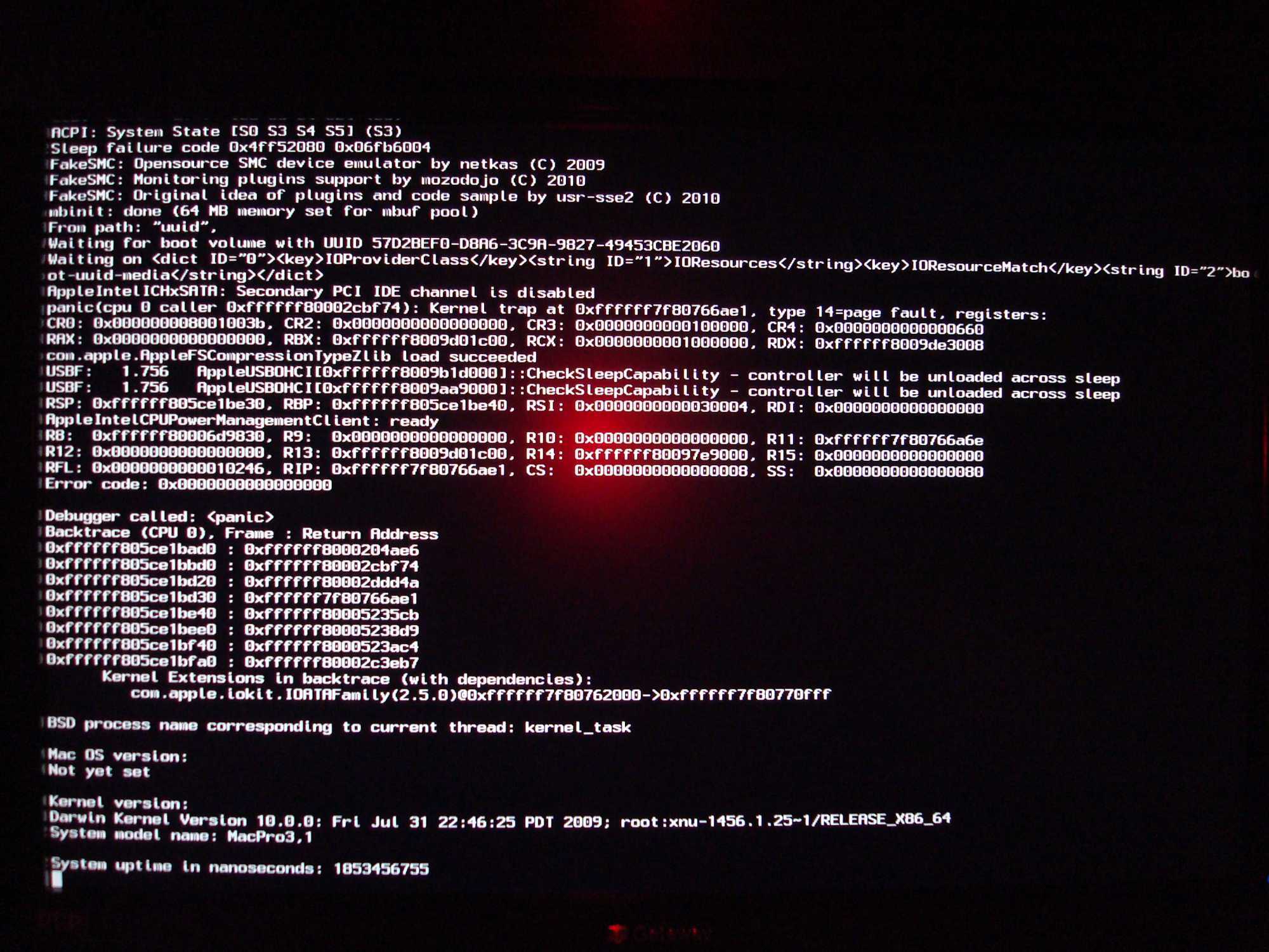

toner_ Posted August 12, 2010 Author Share Posted August 12, 2010 Seems like it's getting a little farther with the new boot disc you made, getting this far then it just hangs. Quote Link to comment https://www.insanelymac.com/forum/topic/227809-dell-xps-410-sl-install-info-needed/page/2/#findComment-1529038 Share on other sites More sharing options...
Mohamed Khairy Posted August 12, 2010 Share Posted August 12, 2010 Seems like it's getting a little farther with the new boot disc you made, getting this far then it just hangs. you must search on bios again for achi or make it raid ide mode give this panic (ioatafamily) is responsable for ide controller and this kext is unstable so you must change bios setting serach for sata setting and if you found achi good if you dont found it trun on raid and examin it i make it to read your ide mode but as you see panic from orginal kext Quote Link to comment https://www.insanelymac.com/forum/topic/227809-dell-xps-410-sl-install-info-needed/page/2/#findComment-1529184 Share on other sites More sharing options...

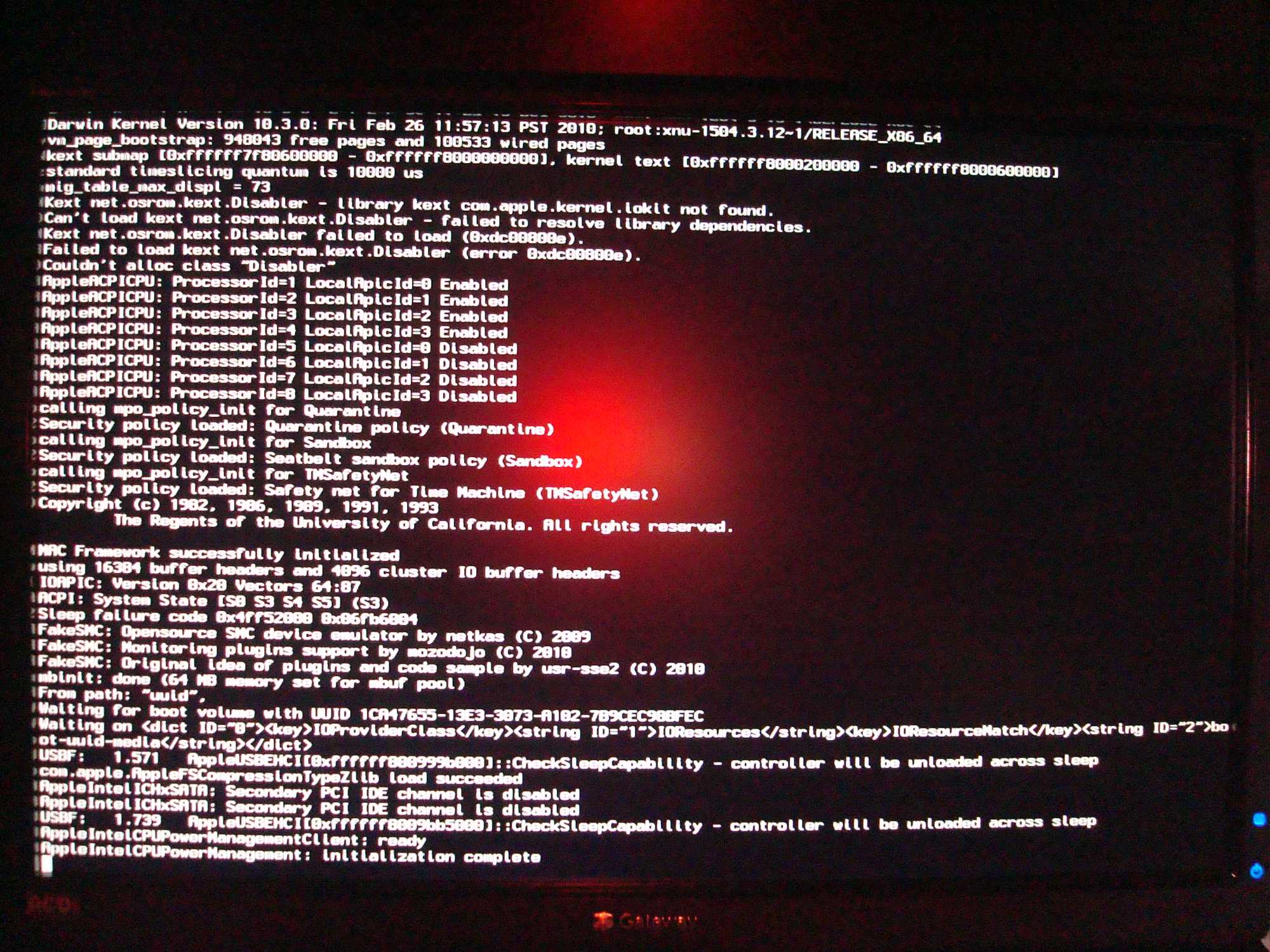

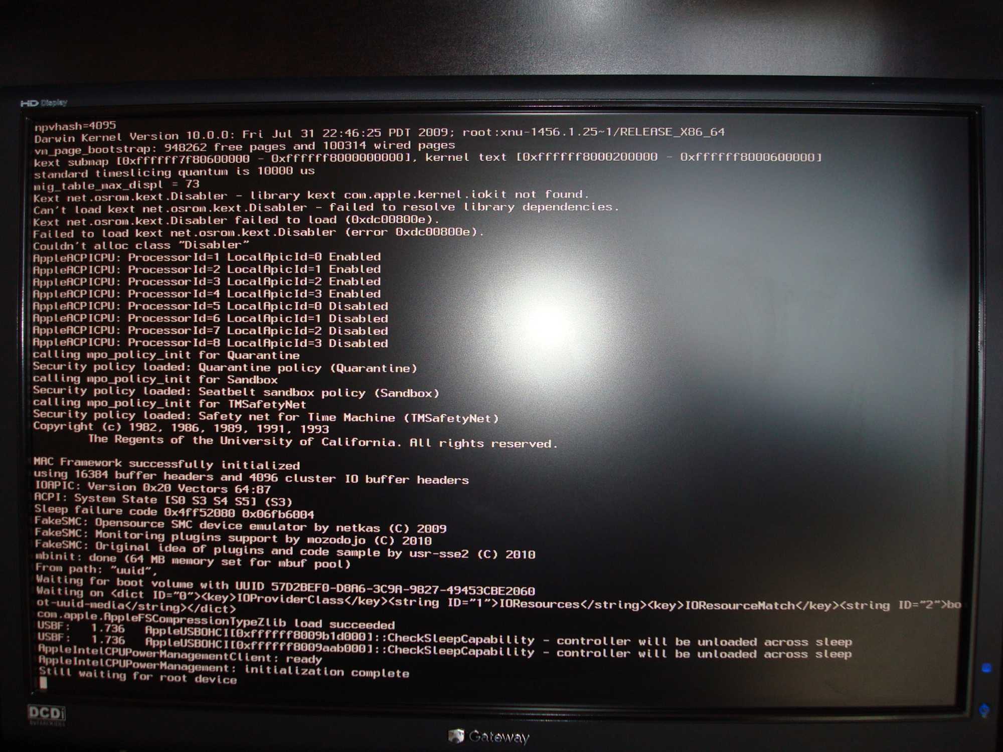

toner_ Posted August 13, 2010 Author Share Posted August 13, 2010 Per our last conversation I tried 10.6.3 with the last boot disc, the first screenshot is the "Autodetect/ATA" setting and the second pic is the RAID ON (AHCI on). Quote Link to comment https://www.insanelymac.com/forum/topic/227809-dell-xps-410-sl-install-info-needed/page/2/#findComment-1529707 Share on other sites More sharing options...
