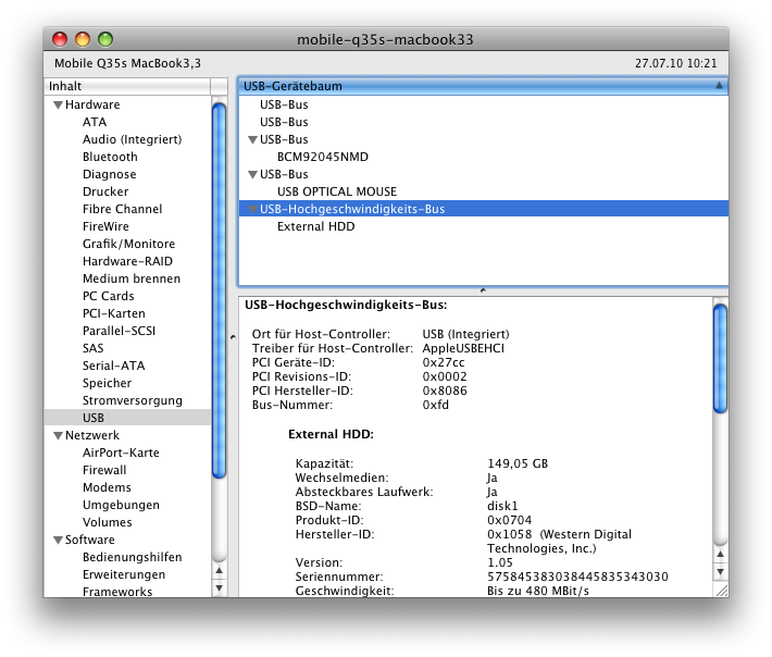

Soldiar Posted July 27, 2010 Author Share Posted July 27, 2010 Hallo, wie erwartet kein Hochgeschwindigkeits-USB-Bus Hast du einen Gedanken woran das liegen kann? mfg Soldiar Link to comment https://www.insanelymac.com/forum/topic/226590-1064-usb-probleme-p5k-vm/#findComment-1519472 Share on other sites More sharing options...
04152viki Posted July 27, 2010 Share Posted July 27, 2010 Method (_DSM, 4, NotSerialized) { Store (Package (0x0f) // в таком виде в пакете 15 полей { "device-id", Buffer (0x04) { 0x36, 0x28, 0x00, 0x00 }, "AAPL,clock-id", Buffer (One) { 0x01 }, "built-in", Buffer () { 0x00 }, "device_type", Buffer (0x05) { "EHCI" }, "AAPL,current-available", 0x04B0, "AAPL,current-extra", 0x02BC, "AAPL,current-in-sleep", 0x03E8, Buffer (0x01) { 0x00 } }, Local0) DTGP (Arg0, Arg1, Arg2, Arg3, RefOf (Local0)) Return (Local0) } In DSDT eintragen. "device-id", Buffer (0x04) { 0x36, 0x28, 0x00, 0x00 für EHCI1 "device-id", Buffer (0x04) { 0x3A, 0x28, 0x00, 0x00 für EHCI2 Link to comment https://www.insanelymac.com/forum/topic/226590-1064-usb-probleme-p5k-vm/#findComment-1519528 Share on other sites More sharing options...
