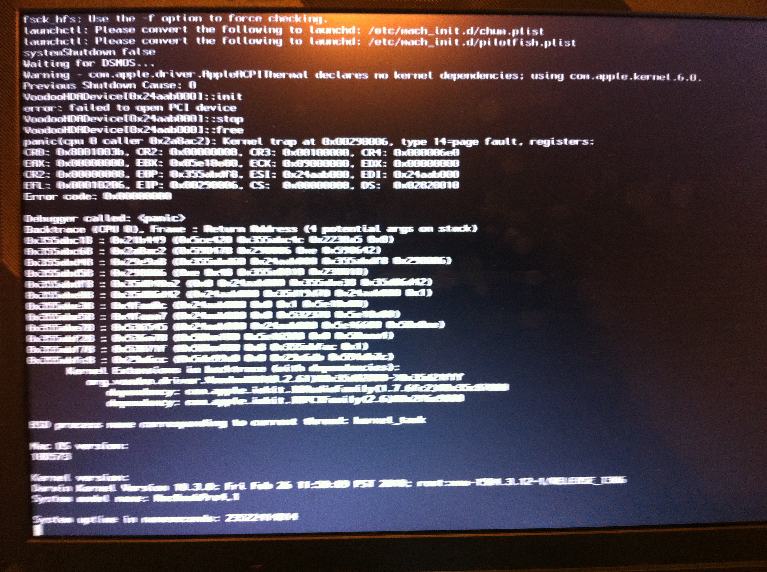

So I installed iAtkos S3 V2 on a Lenovo R400 laptop. The installation went smoothly, and the OS boots perfectly and quickly. I have a few hardware issues, but nothing really critical at this point. The wireless, bluetooth and Intel NIC are not working, all other hardware - including the audio - work perfectly.
I installed xcode_3.2.3_and_ios_sdk_4.0.1, which also went very smooth (via USB drive). Ran the software and all was working. So I shut down the laptop for the night, booted it up the next night to a kernel panic (see attached).

this panic from voodoohda try boot with -x -v
and remove it and install the latest one 2.62
