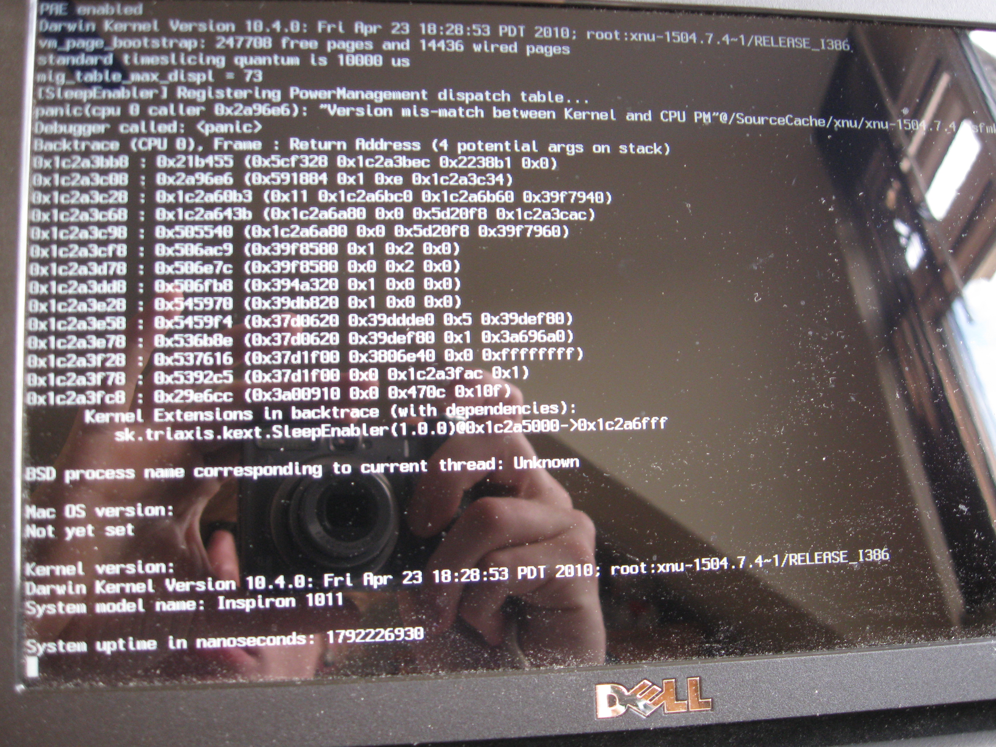

I recently installed a retail copy of Snow Leopard onto my Dell Mini 10v and it was working fantastically for a few months. Today, I did a software update and now it gives me a kernel panic on boot. Is there some way I can revert the update because I really don't want to have to reinstall Mac.
Attached is an image of what I'm getting on boot.
(noob question warning:) Also, I hear a lot about boot options (-v, -s, etc.). How do I actually use these? Do I just hit the 'v' key when the screen is grey and the apple logo is on show, or is there some kind of command line on boot?
i solved the problem!
after some research i mentioned, that the problem is the sleepenabler.kext
I disconnected the HD an put it on my macbook. Than i removed the sleepenabler.kext from extra/extentions
And put the newest version for 10.6.4 in the folder.
Than i put the HD back in my "PC" an it works....!
Just update your sleepenabler kext when you are installing 10.6.4
